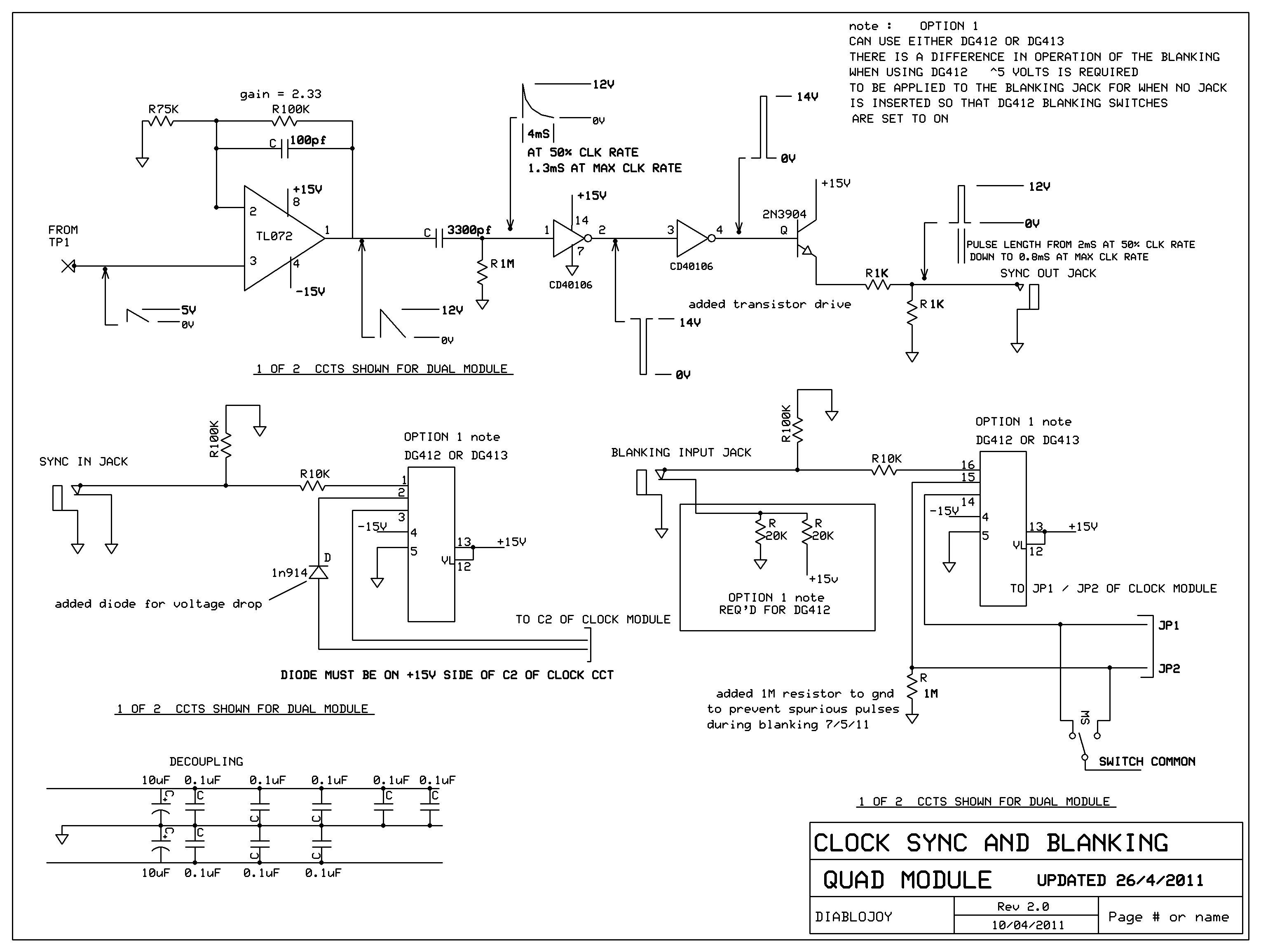

I had another thought, as i dont require a pulse to be any longer than about 5mSec for the sync signal have tried one section of CD40106 as a one shot with a second section needed as an inverter. there are a couple of issues with this idea though
A] the ramp wave at TP1 is not of high enough a voltage to reliably
trigger the one shot as is with a +15V supply if i lower the supply voltage to the CD40106 to obtain a lower trigger voltage the resulting output pulse is not high enough for long enough to reliably switch the DG413
B] if i increase the output at TP1 by adjusting the level on the clock board
this works ok but needs to be at roughly 8 volts though
this then obviously affects the pulse width control of the clock
making the mininum pulse width obtainable about 35-40% no good!
so i need to increase the level another way
so i will try adding an non inverting opamp with a gain of 2 before the one shot cct
I think this should work out well, will try it out tonight. Smile

Doh ! Embarassed haha or i could simply adjust the level of the comparator on the master clock boards upward by changing a resistor - R13 so that it compares above 8 volts instead of 5 will try that first [less components] Wink
edit : will also have to check if this change will have any adverse effects concerning the PWM attenuverter's sensitivity

PostPosted: Wed Apr 20, 2011 2:30 pm    Post subject: Reply with quote  Mark this post and the followings unread
hmm does lower the sensitivity of the PWM input too much
will go with the opamp with some gain into the cd40106 oneshot idea
i first had
and now apparently chasing a ghost as well that infuriatingly comes and goes:?
may take a while to track that down very very frustrating Mad

updated new scheme with now preferred sync cct
tested a single cct on breadboard which worked great Smile
will see how four perform soon as i can get a board done hopefully by tomorrow

have decided that i will only do a dual board layout and concentrate on that
I think i may be the only one doing a quad unit and i can always just stack 2 boards for that. so its not a big issue and much easier to layout
oh and an issue maybe finally understood somewhat
when breadboarding as usual i did not use 22R resistors at the supply
[fortunately it seems or i would never have got this far]
but i did use 22R when doing the sync board itself and ran into a problem most of the time but not always with the clock almost locking solidly high C2 has +15v on one side of it on fonik's cct which I am trying to switch
through one section of a DG413 chip which going off the data sheet it should do apparently Shocked not so much it seems. hours and hours of Confused ensued as i naturally looked for other board issues and couldn't find any
It is fine when the DG chip is supplied at 15V on the breadboard and the clock boards are supplied via their 22R resistors here as there is a very slight voltage drop on the clock board so 15v on C2 is not 15v exactly but slightly less.
so this is a bit of a problem and worse for people using ferrite beads say instead of resistors. so i think i will keep the usual spots for 22R resistors on the sync board but suggest that they be replaced with straps or ferrite beads once the board has been smoke tested.I will also see if adding a spot on the sync board for a diode to go in between the +15v side of C2 and the DG chip switch section to get a voltage drop there will work just to be on the safe side for those that did build their clock boards with ferrite beads. if both work out it should cover everything
diablojoy
Posts: 809
Location: melbourne australia
PostPosted: Tue Apr 26, 2011 2:40 am    Post subject: Reply with quote  Mark this post and the followings unread
needed to do both, the diode and using straps instead of F1 / F2 on sync board to get it working reliably every time. maybe slightly out of spec DG chips ? may have to check some other manufacturers models. any way lots of wiring to do now so i can check if all 4 ccts will perform together, though not till next weekend now i fear.
also updated previous scheme to reflect latest changes.
after some more study of the DG413 data sheet i got over my normal paranoia and have removed most of the protection circuitry it was way overkill and not really required .
added a 2n3904 after the schmidt trigger for a drive cct. I think you would definitely want the option of running a couple of outputs for sync

completed wiring up of quad clock panel with 2 x DG413 dual sync/ blanking boards last night Smile so far so good. though there may still be some minor changes yet
but it all seems to be behaving itself reasonably well
will test over the next week or two if that goes well
I will then do a test build of another quad module using DG412 switches requires a small addition on the board to enable blanking switches to be held high when no jack is inserted, only an additional 2 resistors and a connector. fits on the [then hopefully] final board layout easily enough.

I made an extra dual sync board beyond my requirements during my testing. it is the one with coloured straps in the photo
and is up for grabs Shocked
comes fully populated except for the DG chip.
it has been tested .
first come first served please PM me if you want it

just a bit of clarification on the master/slave panel switches
with this board they probably shouldn't be called master and slave
at all in this case as they just do rather odd things
as you start to work out how this cct board interacts with 2 clock boards
with different switch settings, different patches and different pot settings
both clocks can at times be master or slave or neither or something else
inbetween
I have some idea's using DPDT center off switches but
to be honest it's doing my head in trying to work it all out and in the end
i am not sure that its actually worth the effort for an addition that is not that usefull any longer
so i think i will just refer to the switches as Dave and the other Daves for now on my quad build. they can be interesting to flick on occasionally but
I probably won't include them on any more of my builds . so if someone comes up with a master/slave solution thats works correctly please post it here for any others that may want it
