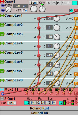

Roland Kuit
Joined: Sep 29, 2003
Posts: 1090
G2 patch files: 127
PostPosted: Wed Aug 24, 2011 2:01 pm    Post subject: Reply with quote  Mark this post and the followings unread
Funny, today I was toying with an osc and came up with this. The other patches where the result.

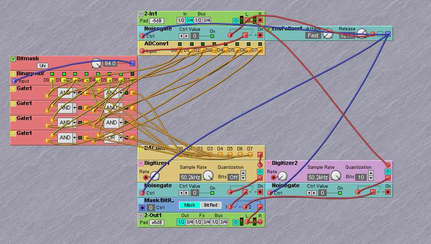

Ok, so this is a test patch where I've tried (without really knowing what I'm doing) to use the advice from Ian and speak_onion. Anyway, I've put a logic gate between all the bits from the ADC module and the DAC module. All gates are set to AND except for D7 which has it's gate set to OR (it could just as well have been bypassed I guess...). A constant module converted to binary through a ADC module is feeding the first input of every gate. The other input is fed by the sound input (converted to binary with an ADC). Reducing the value of the constant module reduces the bit resolution. It's sounds like the Digitizer but with more room for fine adjustment of the bit reduction. So if I've done this right bit masking is just one way of approaching bit reduction. How does that compare then to "regular" bit reduction (if there is such a thing)? Does bit masking turn off the bits following a pattern, rather than turning them off from low to high (D0, then D1, then D2...)? This is a mystery to me...
A strange thing I found when I compared this way of masking the bits with the bit reduction of the Digitizer module is that the ADC to DAC modules with all bits going through sounds just like the Digitizer module when it's set to Bits: 10 (not 8 as I would've expected). The Digitizer is much noisier at 8 bits. Another thing is that the headroom seems higher in the Digitizer module. The ADC to DAC clips earlier with the same input volume. Wonder what this all means??
This feels like being on an adventure.... Cool
Input, please!!
/Mm

speak_onion
Joined: Oct 19, 2009
Posts: 57
Location: Queens, NY
G2 patch files: 3
PostPosted: Tue Aug 30, 2011 1:00 pm    Post subject: Reply with quote  Mark this post and the followings unread
Doesn't the biscuit offer a dedicated button for each bit, when doing the bit masking? That might be a more flexible way to implement the masking than a knob. That way, you could turn off a more significant bit, while allowing a less significant bit to continue operating normally.
