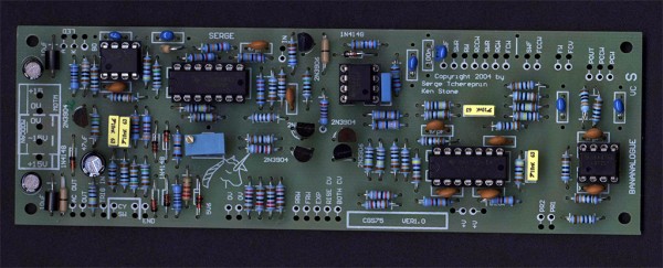

is that normal that my VCS rise/fall rate knobs operate only in a small range?
say 5-7 on the dial makes the whole knob movement
thanks

please take a look at the scan of the pcb, maybe i did some mistake...

In the pic you posted there is a wire link missing between the FCW and SWF pads (top rightish area on board), I can't see my boards, I think this is for power to the TL074... But I guess you've already soldered that in maybe?

PostPosted: Thu Jan 05, 2012 10:13 am    Post subject: Reply with quote  Mark this post and the followings unread
yes, since i have 6 boards here - the one which is wired sure has all the links
i just scanned the spare one

I thought so! Only things I could suggest - as per usual Very Happy is wiring, connections, soldering - you know the score! Also I remember mine acting oddly depending on how the trimmer was set (ie not working at all, being weird), though I don't remember that having anything to do with the controls...? The only other thing that has been a common issue with these is the pinouts of the transistors, but you would have noticed that for sure from all the other VCS problem threads! Again probably not relevant!

I've looked over your photo, and apart from that link, I can't see anything obviously wrong.
The value and type of pots used will actually have very little effect. They are not critical. My guess would be the transistors. Either you have the two types swapped, or you have got them from a manufacturer that uses a non standard pinout. If you have a transistor tester in your multimeter, put a new transistor from the same batch into it, and check. When the transistor is in the correct way, it will have a gain/Hfe in the 100's. If it is in backwards, the gain will be very low - probably under 20. I have seen circuits that manage to "work" even with all the transistors in backwards.

i will do that after the sleep, thank you for the tip!
though all the components are from elby kits
upd: as i've soldered all 6 kits - i think i have to desolder those transistors to check. won't be easy, as the wires are short.
do you think if the pinout may vary from different manufacturers?

i've tried with 3906 - it's the gain is 230 when installed properly and 6 when reversed
