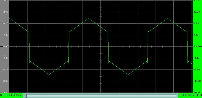

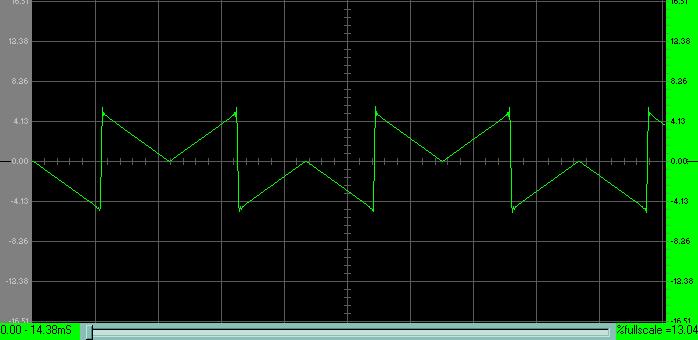

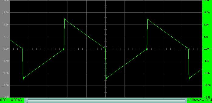

Here are some waveform scope captures.
 Filesize:  31.21 KB
 Viewed:  1218 Time(s)
 Filesize:  31.51 KB
 Viewed:  941 Time(s)
 Filesize:  31.37 KB
 Viewed:  966 Time(s)

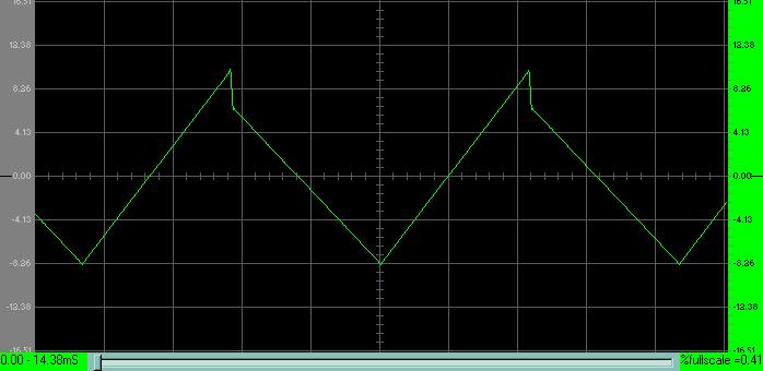

And one more scope capture.
 Filesize:  31.12 KB
 Viewed:  903 Time(s)
