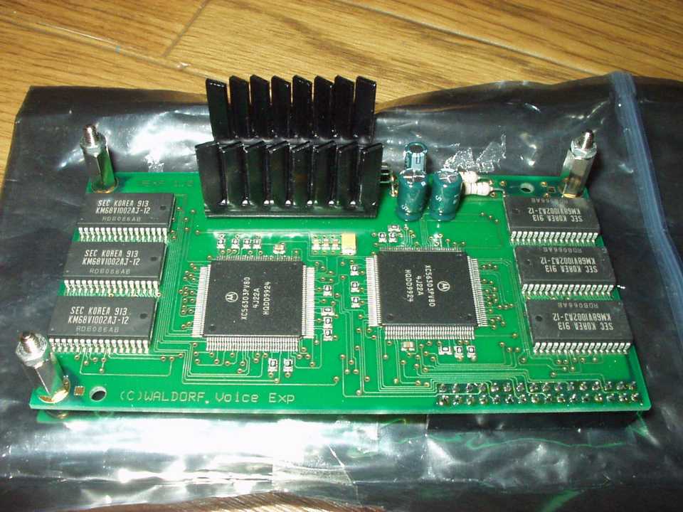

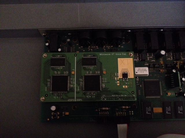

Here is a prototype XT expansion.
 Filesize:  103.56 KB
 Viewed:  1141 Time(s)

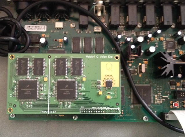

Here is a Prototype Q expansion.

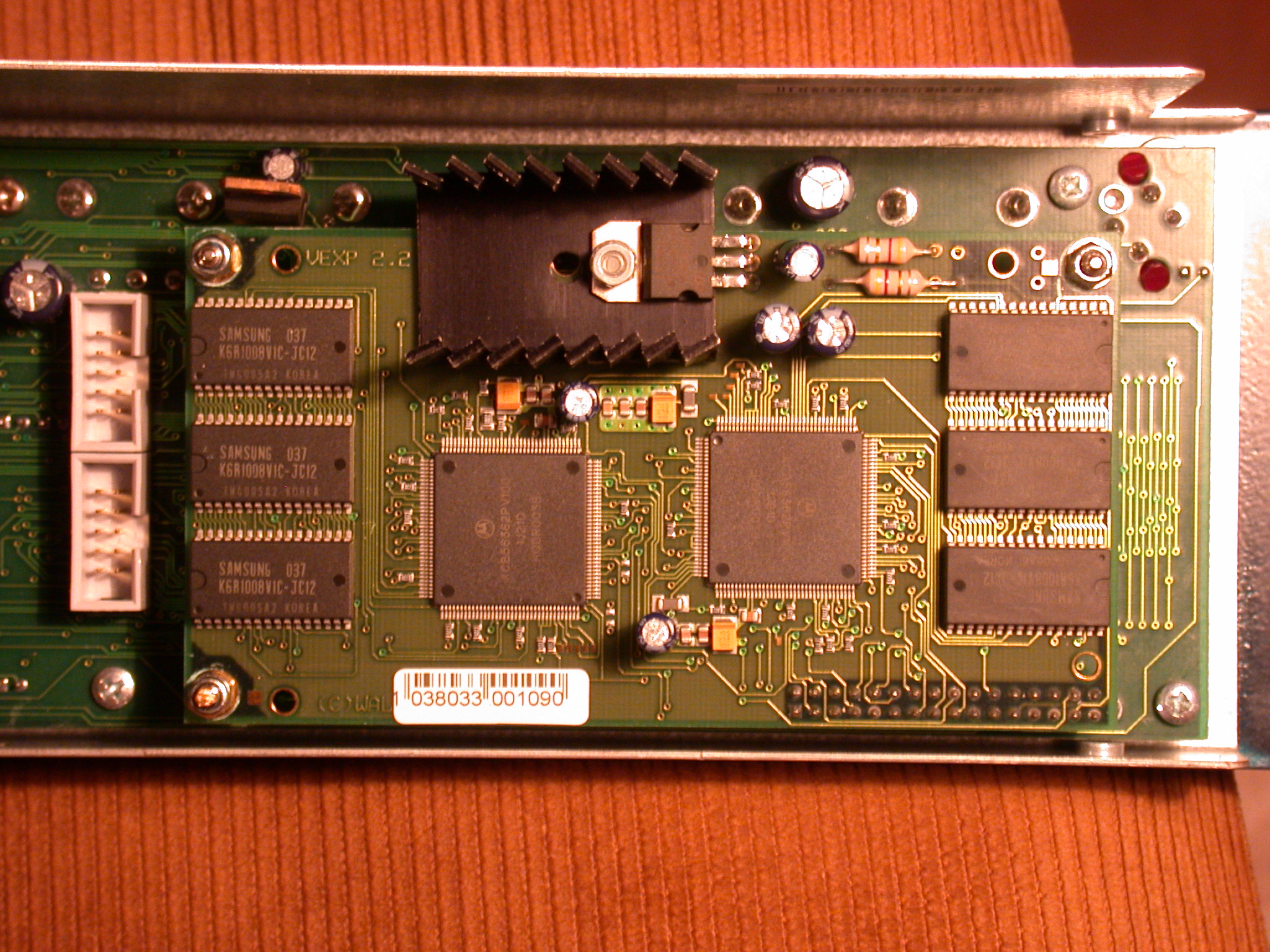

In talking with the Waldorf Tech, the compatability chart is below:
The XT series (including XTk) all use Motorola 56303 voice DSP (But V1 and V2 XTs are NOT expandable).
The Q series is more complicated, the first run of Yellow Qs used a Motorola 56303 also.
This means only the oldest Q expansion modules with Motorola 56303 DSP and 24-bit wide memory footprint (6-chip DRAM) are compatible with V3 XT series and Early Q (56303) Mainboards.
The Motorola DSP was changed in later Yellow Qs to 56362. This is why the newer expansion (Q) will not work and will damage the 56303 mainboard of a Q or any XT/XTk (V3) mainboard.
The (Motorola 56362) expansion version will work in all 2.x and 3.x Q mainboards (including the micro Q).
Looks like we are forced to only have the option to provide expansion for the 56362 Q (Later models) only similar to the V3 (latest model) constraint on the XT. Sad

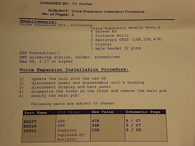

Micro Q (56362)_______No____Yes*
*Hardware modification required
Don't worry about the Request and Donor lists being removed - they became un-necessary when we moved to phase 3.

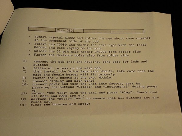

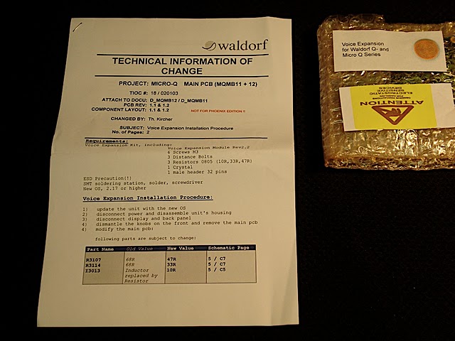

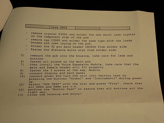

Below are service notes we found for the micro Q expansion installation procedure. We are primarily focused on the Q and XT synthesizers for the expansion, but if you want to use the proposed Rev2 Expansion in a micro Q, it will require additional parts not included with the expansion we plan to make. We offer these notes as a courtesy but I imagine since soldering is involved, you may be on your own concerning warranty matters using this expansion in a micro Q. The prototype module does work with a microQ - more details about the parts need to be figured out.
This is an example of a V2.2 (Motorola 56362) Voice Expansion Module

Page 1 of supplemental documentation for micro Q installation
 Filesize:  66.51 KB
 Viewed:  1125 Time(s)
Page 2 of supplemental documentation for micro Q installation
 Filesize:  68.62 KB
 Viewed:  1069 Time(s)
Page 3 of supplemental documentation for micro Q installation
 Filesize:  66.37 KB
 Viewed:  1096 Time(s)
