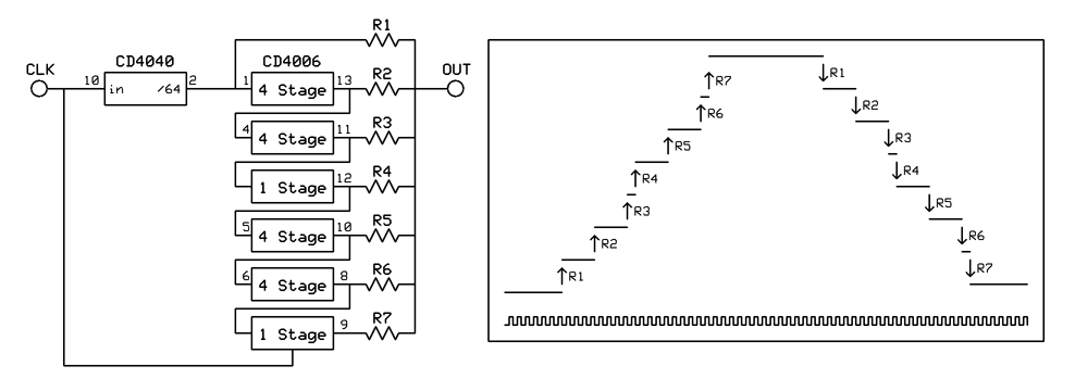

that's gonna be either 16 -> 4067 (4 bit) or 8 -> 4051 (3 bit).
there's probably a way to use 2 4051's too but not sure if that's worth it.
Idea If you use a mux instead of a switch you could control the datalines of that with some LFO's or
other logic but I'm wondering what kind of pattern you get if you control it with a binary counter
(4029 or could be another 4040) clocked by the ouput (pin 8 or 9) of the 4006. this would make
it change after every cycle.
o and I couldn't resist redrawing the schematic a bit so you can see a bit more clearly what the 4006 does Cool
Cynosure's CMOS Wave Shaper - block schematic by PHOBoS
 Filesize:  21.09 KB
 Viewed:  1249 Time(s)

An addiotional thought: would it be possible to get a scope screenshot of the input(clock) wave against the output?
Posts: 5980
PostPosted: Tue May 08, 2012 6:56 am    Post subject: Reply with quote  Mark this post and the followings unread
well I couldn't hold back any longer and just breadboarded it.
first thing I changed was removing the resistor attached to the CLK input since this only adds
the source frequency which is rather high (unless you're using it as an LFO).
instead add a resistor to the input of the 4006 (pin 1)
Cynosure wrote:
I didn't try when I had it bread boarded, but I wonder what it would do with the 1 stage outputs added to the mix. Maybe add 2 more steps that aren't as wide?
yep that's what it does,. so I added resistors to both pin 12 and pin 9 for some extra steps.
another thing I'm trying right now is an oscillator attached to the reset pin of the 4040
(high speed but lower than source). This gives some very nice filtering sounds.
I also noticed that some of the ouputs of the 4040 don't create any really interesting
sounds/waveforms so I don't think a 12 step switch/mux is necessary. 8 is probably
more then enough. But I have to do some tests first.

well, I'm currently doing some tests with my scope, and taking notes on how the waveform changes
using different ouputs of the 4040 and 4006. At the moment I'm only using the 4-stage shiftregisters
of the 4006 (so I connected pin 11 to 5 instead of 12 to 5 skipping the 1-stage) and I have resistors
placed at the ouputs of each shiftregister and also a resistor on the input (which gets the divided
clock from the 4040). This results in a nice symmetrical 5 step triangle when using Q6 (pin 2)
of the 4040. Using Q5 changes it to a 3 step triangle, while Q4 to Q1 give a square wave with a
different frequency/amplitude. (So you're just getting a division of the Clk no interesting waveform)
Using outputs Q7 to Q12 gives 5 steps but with a longer pause between the triangles (the steps
themselves stay the same length). this creates a pulsed sound.
RingMad wrote:
I forgot about the reset pin of the 4040... I'll try that now. [... some minutes later ...] hmmm, in my case, I have this hooked up to the crazy "4051 ANY Gate" (which required me to buffer its output before going into this waveshaper)... I wouldn't qualify the sounds as filtering maybe... I get more rhythmic patterns. One day hopefully soon I'll hook this up to something more "normal".
I use the following setup to create the "filtered" sound; for the main Clk oscillator I use a 1nf cap and 500K pot.
for the reset I have an oscillator with a 100nF cap and 500K pot. Now if you turn the clk pot it produces
a very nice sound, especially if you set the reset oscillator at a fairly high speed. It looks great on the
scope btw,. stepped triangles popping up like mushrooms Very Happy
I think using switches or better yet, some logic to switch the resistors connected to the 4006
on and off will be more interesting than using different outputs of the 4040. Adding some
resistors to the outputs of the 4040, connected to the same point as all the others, also sounds very nice.
edit:
here's a schematic + waveform and a nice scopeshot, this should clear things up a bit more. Cool

Cynosure wrote:
Phobos - great work! Schematic please? Smile
ok here's the simple 8-step triangle setup.
(I'm a bit disabled at the moment,. will be hooking up some oscillators and maybe make a video when I can)
Uncle Krunkus: I quickly scanned the thread, it looks interesting. I'll have to look into that some other time.
 Filesize:  15.34 KB
 Viewed:  38481 Time(s)
 Filesize:  14.83 KB
