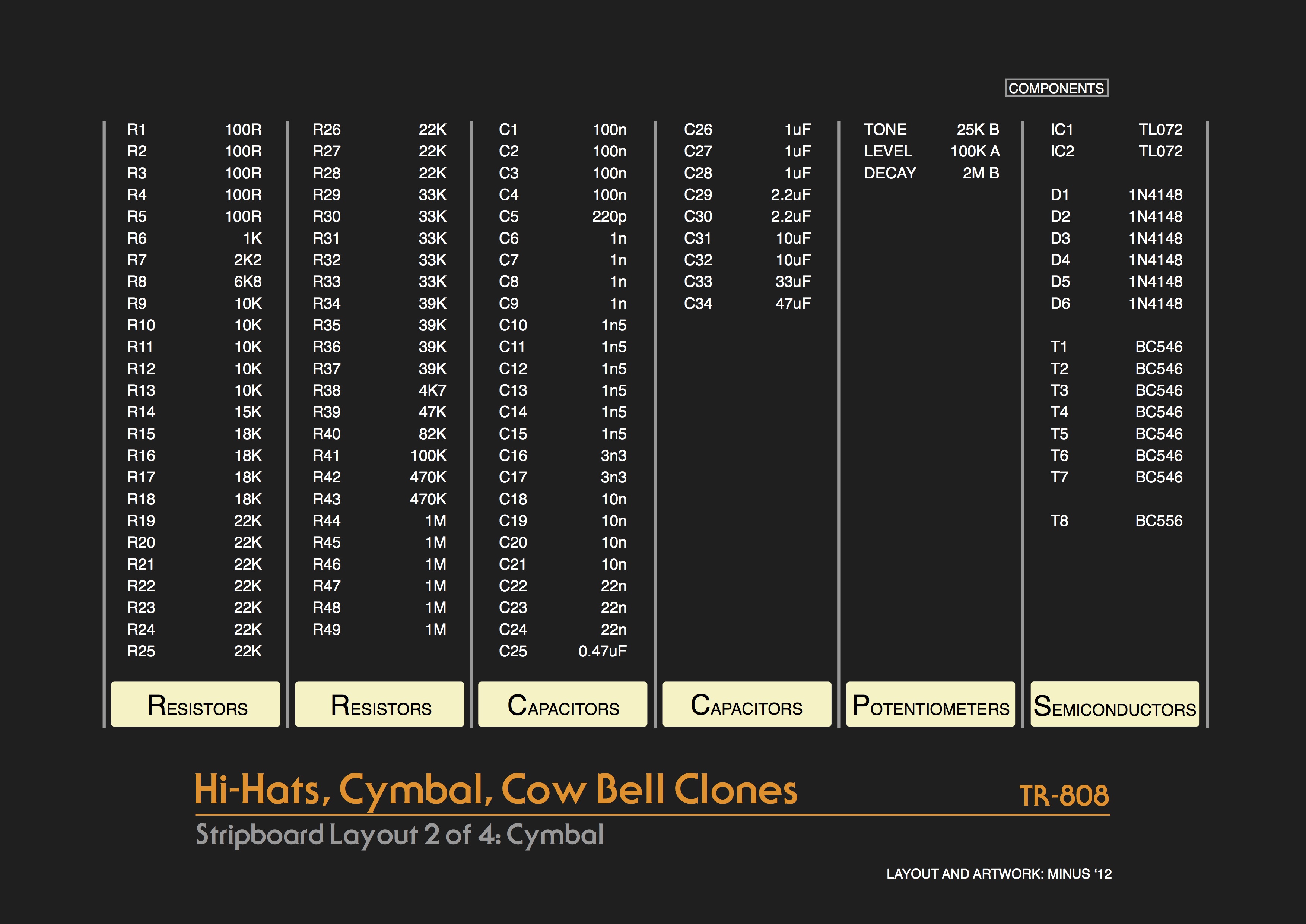

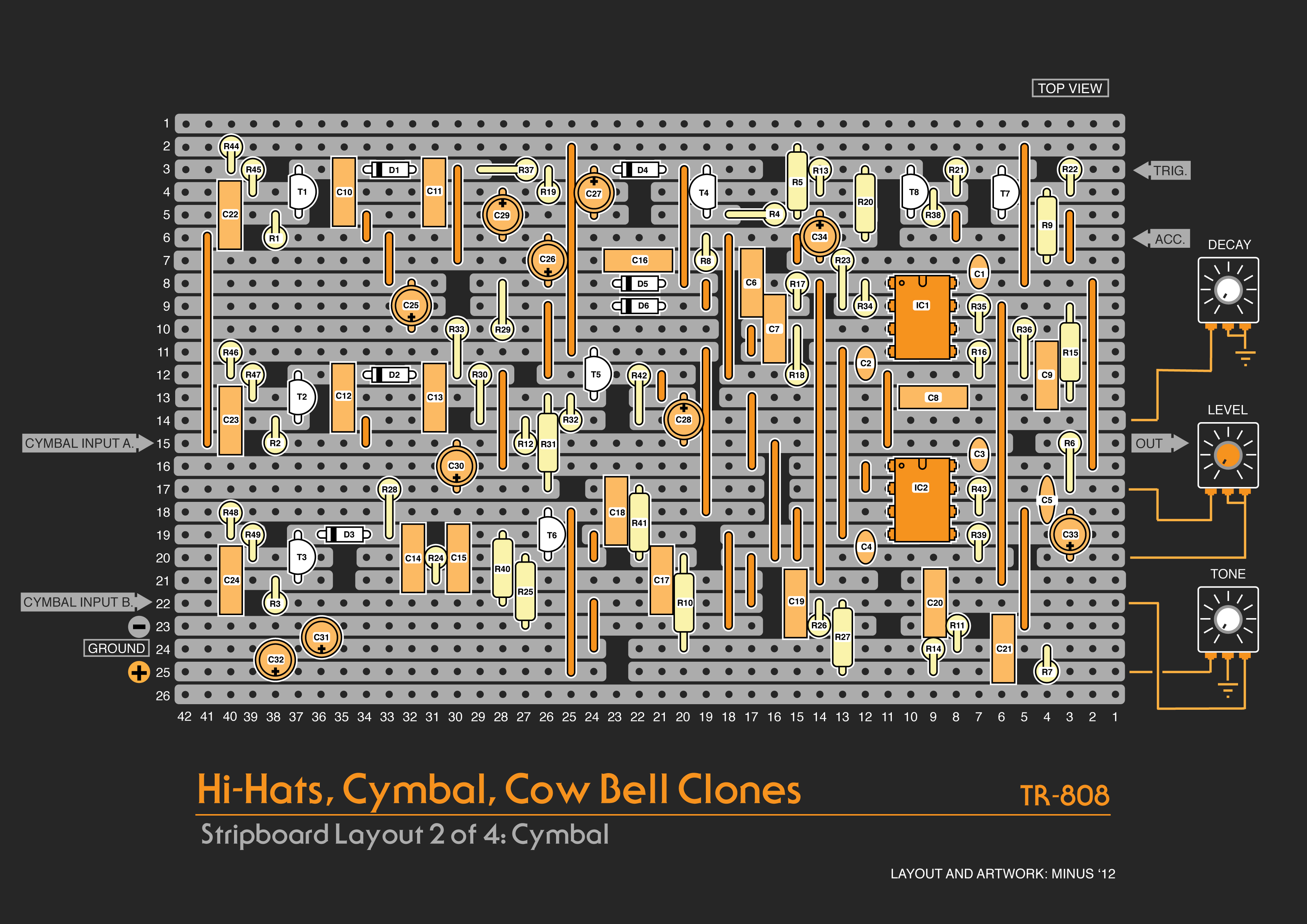

Here's the next instalment, the cymbal. I tried a few times to get the footprint down in size, but after a build failure I decided to be less cluttered. My previous effort took the electricity around the scenic route! This version is now built and working and comes out about the size of a playing card. There are a lot of traces to be cut so be careful. If you build this exactly as is, it should work as mine does. Incidentally, I'm running this off +/- 12V at present.
I'll post some sound samples and photos soon.... soon as I stop playing with it! Laughing
Corrected the pot wiring
 Filesize:  1.71 MB
 Viewed:  3601 Time(s)
Corrected label to 'bottom view'
 Filesize:  1.93 MB
 Viewed:  2327 Time(s)
Corrected Decay pot from 2M A to 2M B as it should be. Changed R38 from 47k to 4.7k, 2017
 Filesize:  770.74 KB
 Viewed:  1533 Time(s)
