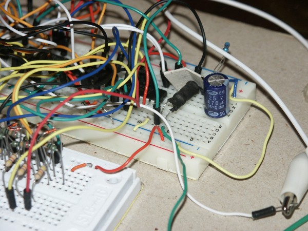

part 2 Subject description: expanded and breadboarded - now the wondering starts |
so, yesterday/today I resumed this idea.
first, i expanded the schematic - (ignore the 2 extra inverters...ic6 and ic7 - i think - just an idea i had!)
so, i breadboarded this with an extra 40106 used for 1 (one) clock - feeding the 4040 and one osc to get a test audio signal. the audio osc. uses a 1mOhm pot in series with a 500k dark-resistance LDR/LED-vactrol fed by the output of the 4051.
got something to work, but also some weirdness - apart from the fact that I soon realized that I needed a walwart psu for this, as my battery was definitely not providing enough current and the circuit started to "fall asleep"... (sorry, English is not my first language and sometimes at past seven in the morning before any sleep the right words do elude me)
- back to the weirdness -
1) the output frequency is rather high, even though the osc uses a 10µf cap and a 1mOhm poti in series with a 500k dark resistance ldr
b) there is a constant modulation on the audio(rate). my suspicion is, that this is mostly from too many chips (and the rather large value caps on the 4 'random' 40106 oscs.) all on one breadboard without (as of yet) much decoupling going on.
anyway, if interested, have a look/listen yourself:
http://soundcloud.com/ivorybunker/cmos-sample-hold-breadboard
- hm, can't seem to find out how to embed a soundcloud player here... so please just follow the link. thx.
i attached both a pic and the eagle file (feel free to use, abuse, tinker...)...
will post pictures of breadboard later.
cheers
- a little update: 1) i re-arranged the circuit. finally found am certain that the "problem" with the 4042* chips is that they are latches (letting the input signal pass) rather than flipflops (which would be set to the respective clock speed - learned the difference the hard way)...
... so for testing out the circuit without too much rearrangement i just connected all the 4042 ins (except clock, etc., of course) to outs from the 4040, so all of them change less frequently then the clock of the 4042 (i.e. q1 from the 4040) and the fastest switch input of the 4051 (again, the clock of the 4042)...
2) i took some photos and recordings of said new circuit (a schematic with the proper cap/pot etc. values could be done, if there's enough interest)...
as you can hear, this one makes much more sense...
2.1 - the first recording is of the circuit as described above... me changing the clock speed and basic freq of the osc.
2.2 - is a recording where the osc. get's gated by the clock with a 1n4448
some interesting sounds in there, especially at fast clock speeds
http://soundcloud.com/ivorybunker/sets/cmos-sample-and-hold-idea
i still feel like there's not all working out as intended but i'm getting there... more tinkering tomorrow
*the reason i'm working with these 4042 is mostly that I got a bunch of them from a cheap german 25pieces of various cmos chips pack... (they're actually from east germany)...

While you will get different voltages from an R2R ladder like that, that is not the standard way to use an R2R ladder, nor is this really a sample and hold circuit.
I think you may have misunderstood how to use an R2R ladder if you did not intend to use it in an abnormal way (which is fine but makes me suspect that you made a mistake). Care to clarify? _________________ As a mad scientist I am ruled by the dictum of science: "I could be wrong about this but lets find out"

indeed, I'm using the r/2r in an abnormal way - and possibly in one that does not exactly do what I think it should - but my thinking behind this way was/is that, when sending a signal to some parts of the ladder and others not they should sum up to give different voltages. now if i tap those at different points (somewhat) randomly - that's where the 4051 comes in, I, again, get different outputs...
so what you get is a different voltage each time the master-clock (divided by half once via the 4040) triggers. Pseudo-Sample + Hold would have, admittedly, better.
must admit though that, while being interesting as an experiment (thought and breadboard) I feel that it's - unless I or someone else has an idea to largely improve the circuit - not really worth being built (seeing as there are some rather 'simple' s+h circuits out there anyways). will need to find some other use for those 4042's I guess.
thanks for your feedback in any case,

You don't need to tap different points to do that; that is what an R2R ladder does, give you different voltages form different binary combinations at it's inputs.
If you measure those points you connected to with a voltmeter or oscilloscope, I think you may find that being connected in that way, they limit the number of different possible voltages but change the weighting towards each end of the ladder. _________________ As a mad scientist I am ruled by the dictum of science: "I could be wrong about this but lets find out"

Why are you sending it to an LED? try a vco or something else voltage controlled for greater effect
ah but wait, is that a home made vactrol I see there?  _________________ As a mad scientist I am ruled by the dictum of science: "I could be wrong about this but lets find out"

yes - by Led I meant the one in the vactrol... this (in series with a 500k pot) controls the pitch of a 40106 osc.
you can hear this one on the second two tracks I posted.
I did another test driving the led directly from the r/2r ladder with far less interesting results - i basically changed between two notes.
