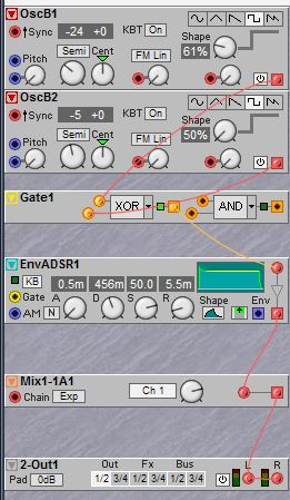

PostPosted: Thu Sep 27, 2012 10:26 am    Post subject: XOR Ringmod Like the ARP Odyssey? Reply with quote  Mark this post and the followings unread
http://en.wikipedia.org/wiki/Ring_modulation#Integrated_circuit_methods_of_ring_modulation
Here the ring mod for the ARP Odyssey is described:
On an ARP Odyssey synthesizer (and a few others from that era as well) the ring modulator is an XOR function (formed from two NAND gates) fed from the square wave outputs of the two oscillators. For the limited case of square or pulse wave signals, this is identical to true ring modulation.
Would this be the implementation on the G2?

Baby wrote:
...Would this be the implementation on the G2?
Yes, that looks about right.
The Realistic Concertmate MG-1 also uses the pulse waves from two oscillators into an XOR gate for this type of effect, which is named “Bell Tone”.
If you haven’t seen them already, here are some of my G2 patch experiments using XOR gates:
http://electro-music.com/forum/topic-13384.html
http://electro-music.com/forum/topic-43063.html

My Waldorf Pulse also has this and calls it Cross Mod.
