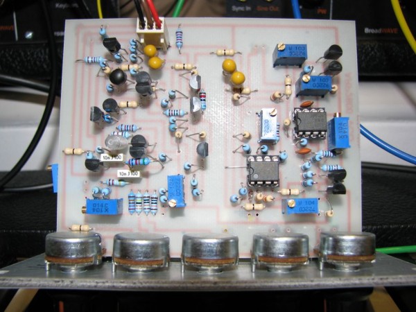

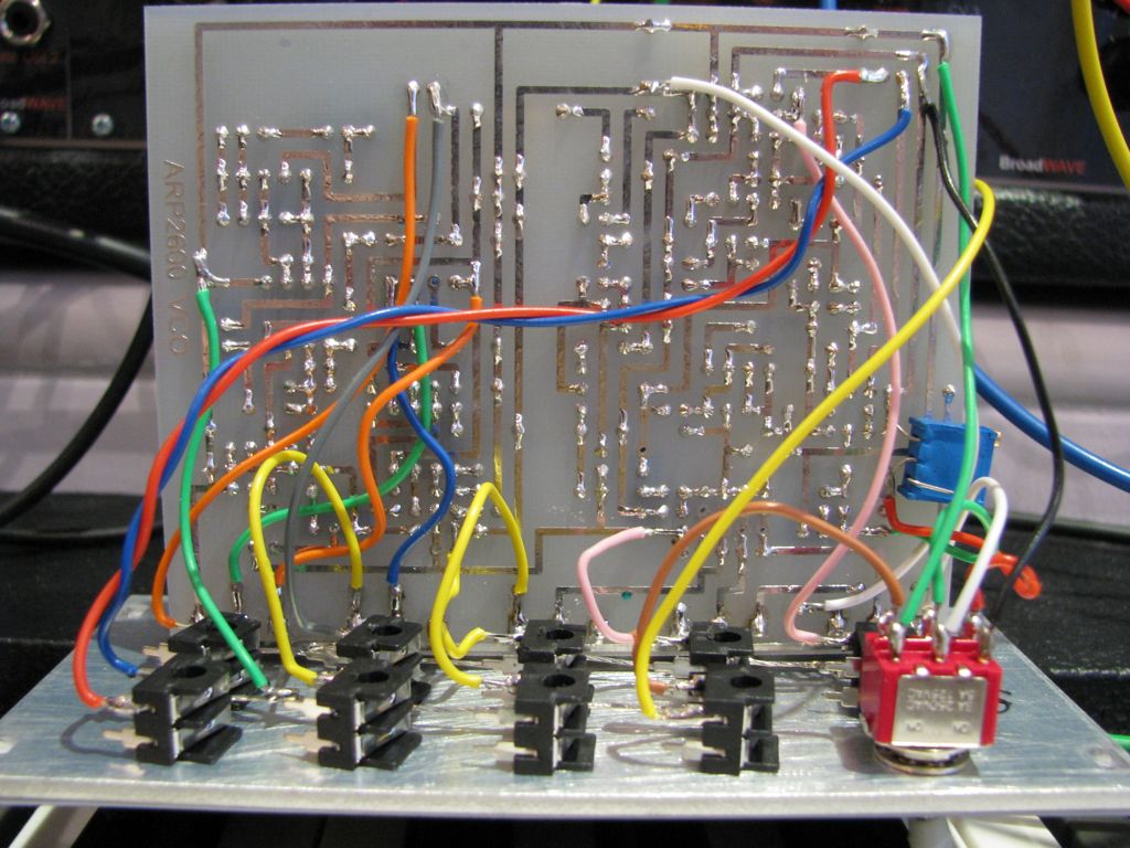

The 2600 VCO works great... unfortunately the PCB layout is still a mess (too many hardwired links have to be made, and the power is only 3 pin - struggling to find space for the full "Doepfer" style power connector, and I forgot the +15v supply to the frequency pots Rolling Eyes
So a re-draw is required, maybe on a slightly larger board - desperately trying not to use a double sided PCB. But it is getting there Wink
The main problem is, when you build for yourself you tend to think "Oh, that'll do" (even if it is a bit messy). But I'd prefer it to be right if I'm "going public" with something... or... maybe I'm just too fussy Very Happy
And for the life of me, I can't recall what that trimmer is for on the solder side! Don't you just love getting old!

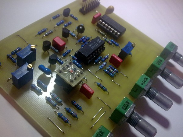

I posting here the untested changes I made to your PCB. With this Mod, the SMD Tempco and the BC847BPN are soldered together on a DIP8 adapter.

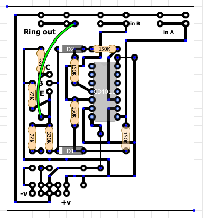

Hi there !
I'm trying to build some kind of eurorack-lite-odyssey system, and have already succeeded in making two of these great VCOs, plus the 4023 vcf. (thanks, AndyR1960 !). As i've never drawn any pcb, but would like to, I've decided to begin with the Odyssey's Ring mod.
Here's what i've done, so far...I've etched this pcb, and powered it, plugged in two square waves, but did not get any sound from the output. I've certainly forgotten something or made a typical newbie error. Could someone help me, please ?
 Filesize:  30.55 KB
 Viewed:  62561 Time(s)
PostPosted: Wed Feb 27, 2013 11:24 am    Post subject: Reply with quote  Mark this post and the followings unread
On its face, the schematic seems to match the circuit, so I don't see a problem there.
alcide
Joined: Apr 20, 2012
Posts: 5
Location: Lille, France
PostPosted: Wed Feb 27, 2013 11:19 pm    Post subject: Reply with quote  Mark this post and the followings unread
Thanks for your attention, elmegil!
The strange thing is : I don't get any signal from the output when this board is powered. But I do get something when it's not. And that's what puzzles me: on the schematics, CD4011 is clearly connected to v+ on pin 14, and grounded on pin 7...
(Note : I've already tried several IC's. All of them are TI CD4011BE, not AE...)
Broadwave
Joined: Feb 16, 2007
Posts: 347
Location: Manchester UK
Audio files: 6
PostPosted: Thu Feb 28, 2013 1:00 am    Post subject: Reply with quote  Mark this post and the followings unread
Don't forget that both square wave inputs need to be 0-10v... the Oddy VCO's have a separate 10v output for the Ring mod. The the 0-5v "audio" output is not enough to drive the ring mod.

PostPosted: Thu Feb 28, 2013 6:21 am    Post subject: Reply with quote  Mark this post and the followings unread
Since the NANDs are effectively hooked up as inverters (second leg tied to Vcc), could you use an inverting schmitt trigger (e.g. 40106) in place of the 4011 and get more sensitivity to incoming signals?

I've also noticed you have the spare NAND inputs floating i.e. not connected to anything (pins 1, 2, 12 & 13), CMOS doesn't like floating inputs, so it's best to solder those 4 pins to +V. It's perfectly ok to leave the outputs unconnected Wink
