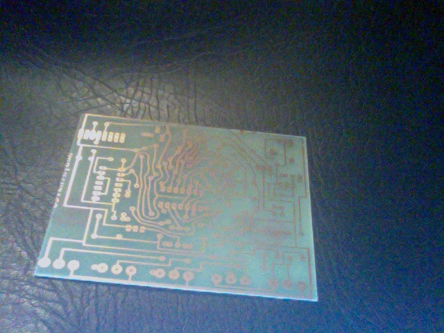

PostPosted: Sat May 04, 2013 4:25 pm    Post subject: Reply with quote  Mark this post and the followings unread
waiting for success ....
A picture of my boards.
I want to use some of them as LFVCO changing the cv1 input jumper for a toggle switch to 270K resistor. I see Furio's panels don´t include this socket but I think it is interesting too in this single version. Do you think there is enough space for add a socket for a miniature toggle switch in your panel?.
