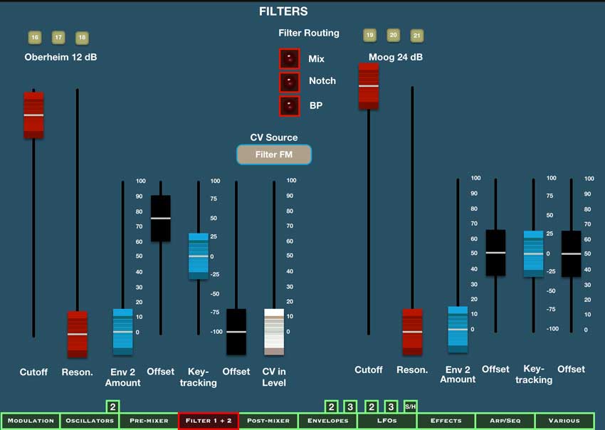

scd
Joined: Dec 26, 2003
Posts: 44
PostPosted: Wed Mar 13, 2013 8:14 am    Post subject: Reply with quote  Mark this post and the followings unread
The filter page as it is now
 Filesize:  37.72 KB
 Viewed:  1048 Time(s)

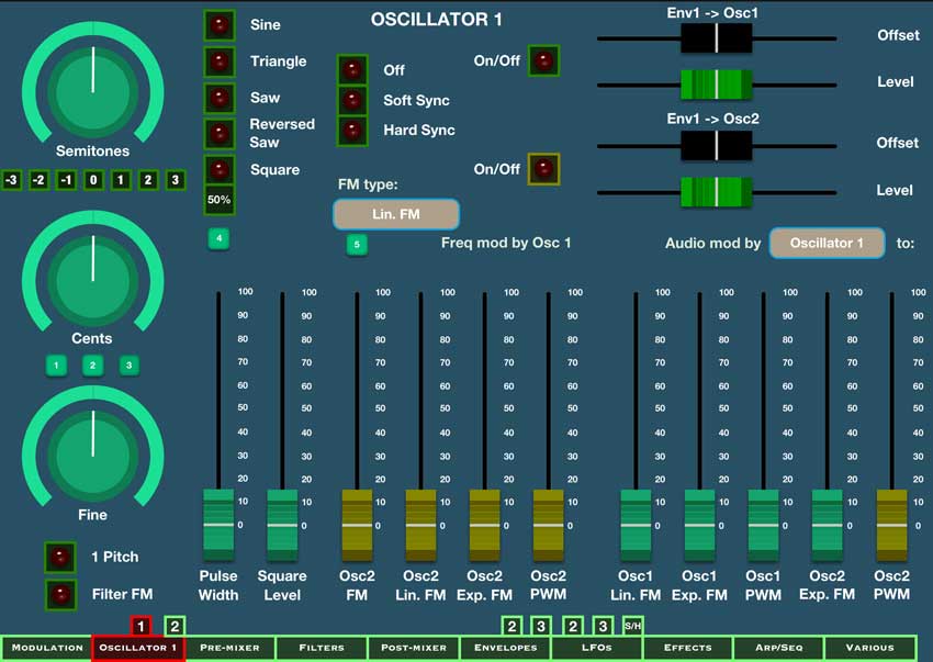

scd
Posts: 44
PostPosted: Wed Mar 13, 2013 8:15 am    Post subject: Reply with quote  Mark this post and the followings unread
The Oscillator 1 page (as it is now).
Things can change and things will be added in the future on pages that have room left.
I am thinking of presets for sections of the synth, extra navigation stuff etc.
By the way: colors have meaning in this editor Smile
