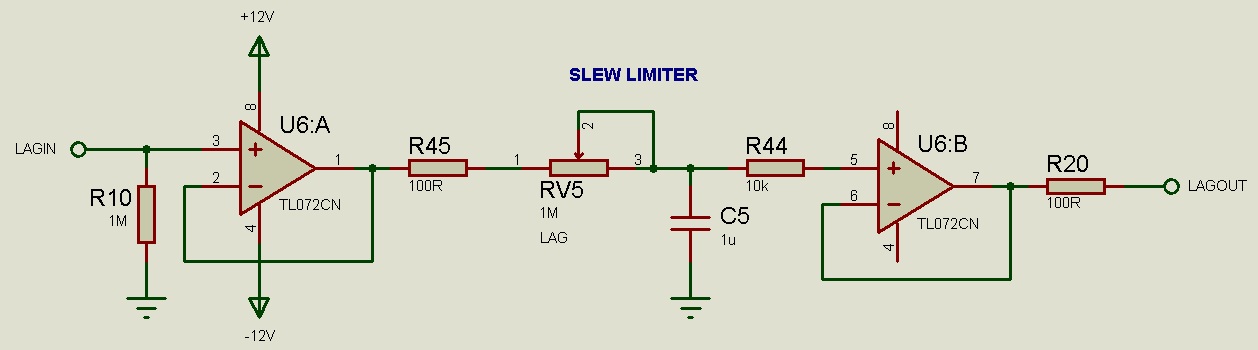

ok, i found something calls a "Slew Limiter".
maybe it can help me with the gate clicks?

PostPosted: Mon Aug 05, 2013 1:38 am    Post subject: Reply with quote  Mark this post and the followings unread
the slew limiter helped Cool
clicks is totally gone!!!
