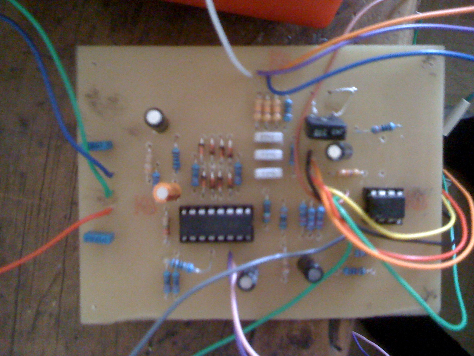

Hi. I've just finished the 3096 Steiner VCF using press n peel method.
Picture below.
I've tested it using an 8 step sequence from my SN voice Lux and am getting some positive results. I had to change R16 to a higher value to achieve self oscillation which I like but this particular one is pretty rough!
I've noticed that the output is a little quiet but I'll probably change the resistors on the input and output stages.
A question I have is: If I wanted to change the filter to accept inputs into the LP BP and HP (ala Ken Stone) instead of them being selectable via a switch, would I have to reroute the input stage... has anyone done this ??
Anyway, Thanks Mr USSON for such a great design. Cool
Steve.
