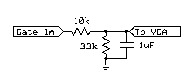

hallo, I have finished a VCA, and I made the settings.
It is working, but at every rise gate signal I hear a "click".
Is it correct behavior?
I have put the signal coming from yusynth VCO and a gate signal from a midi to CV converter by Midi-CV_Gate Obsoletetechnology.
Are there any modify?
many thanks

Hi ranioItaly,
You'd normally use an envelope to open the VCA, triggered by the gate from the MIDI-CV converter. The Gate would open very quick (it's a pulse wave/shape) and this may cause the click where it opens so quickly...

Yes, indeed, an ADSR should work here - I believe the click is the very quick 'cut' in the audio when it is turned on by the gate... you could try a passive slew in the meantime (before you have built the envelope) I haven't tried this myself, but it might be interesting. This page here:
http://www.doepfer.de/DIY/a100_diy.htm
Scroll down to '2. Basic circuits' and then see the 'simple lowpass' - using 1uF for C1 and 10k for R1 you obtain about 10 ms slew rate.

PostPosted: Thu Sep 26, 2013 5:41 pm    Post subject: Reply with quote  Mark this post and the followings unread
isak wrote:
Hi there.
sorry to interrupt like that, but a lowpass filter will not help you (been there, done that).
I have a hard time believing this. In the thread that you quote, you alude to the fact that my proposed circuit add on fixed the key down popping yet the key release pop still remained. I'm just curious if different values were tried. I might suggest a larger value for the resistor connected to ground.

The "slew limiter" referenced in the thread mentioned above IS a low pass filter. It's a simple RC filter surrounded by buffers. The buffers and pot make it easy to integrate into a variety of circuits and dial in a specific amount of filtering. With proper care, a resistor and capacitor can be made to work in a specific circuit without the extra components. I guess it depends on where you want to put your effort - buying and assembling more components or putting more thought into it.

Benjamin AM
Joined: Nov 04, 2010
Posts: 83
Location: Boise
PostPosted: Fri Sep 27, 2013 6:22 pm    Post subject: Reply with quote  Mark this post and the followings unread
isak wrote:
Hi Benjamin AM,
Sorry if you were ofended, but it's true.
After using the scheme you attached and this click/pop didn't went away I was trying to find an answer my self after you didn't replayed, the scheme I attached worked.
I'm not offended at all. I just want to make the point that a LPF will work. The values of from my previous attachment removed most of the sound from the sudden opening and closing of the VCA. They were suggested values and the end result is all a matter of preference. Don't be afraid of experimenting. I just spent 10 minutes with some alligator clips(bread board would work better) and found that the following values gave very smooth results. The control input resistors(R19 or R20) should be adjusted accordingly due to the loss of signal from the circuit.

PostPosted: Sun Oct 20, 2013 2:12 am    Post subject: Reply with quote  Mark this post and the followings unread
hi to all,
I 've fixed the problem with the simple circuit suggested by The Bad Producer, and no more click is heard when play the keyboard.
It's a alternative for a simple use. I've also built an ADSR for a more complex use.
