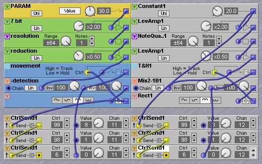

I've been working on a patch to control my Korg EMX-1.
But I'm having trouble understanding any documentation on (N)RPNs.
I got a few things to work but when I think I understand it and try to apply the same rules to other aspects of the patch it wont work.
In the documentation for the EMX-1 it says the Synth Wave parameter is NRPM 0801. So I send messages CC99-value8, CC98-value1. If I understand it correctly the EMX-1 is now listening to any message I send which will control the Synth Wave parameter. But the documentation doesn't say what message to send it.
I set up a MIDI listen device in Cubase and changed the wave on the EMX-1 Cubase received CC99v8, CC98v1, CC6v73, CC99v8, CC98v1, CC6v74...
So it must be CC6 that controls the wave.
I made this patch and sometimes it works but sometimes it doesn't.

The CC Send module will automatically send a MIDI CC message whenever its 'Value' parameter changes (either by moving the knob or by a changing input signal).
The problem in the NRPN scenario is that the first two CC messages of the NRPN protocol do not change. So, one has to detect a change in the value to be sent and use this to trigger the sending of the entire NRPN string.
The G2 'constant value' knobs are 7 bit, but they are smoothed -meaning that twisting them will output a continuous smoothed 24 bit control signal. Using this smoothed signal for the aforementioned value change detection will produce too much redundant MIDI data as the 24 bit numeric resolution will be truncated, resulting in many useless CC messages containing the same value clogging up the MIDI stream. So it is advisable to reduce the knob resolution to 7 bit before applying value change detection.
So the optimal solution ends up being rather elaborate.
Let me know if this works. (I patched it 'dry' on the editor without testing.)
UPDATE: New version uploaded.

exeterdown wrote:
OK, so my thinking was I could split a patch lead from the ConstantValue output, then any movement it made would trigger the CtrlSend. But you've taken the trigger from the rectifier. Is this because triggers have to be positive?
The CtrlSend module does have the functionality that it will output a MIDI CC message whenever it detects a value change -but this applies only to the 'value' input and knob. Since the two initial NRPN messages do not change, one has to trigger them in a conventional way.
My example detects knob movement by subtracting the current knob value from a value stored in a T/H and then taking the absolute value via rectifier. So whenever the knob is moved, a positive value (the absolute difference) will appear at the rectifier output, which I use as a trigger to initiate the NRPN sequence and also to update the new knob position in the T/H, so the circuit is ready for the next knob movement.
(Remember that anything that goes from negative or zero to positive can act as a logic trigger.)
So G2 modules have a higher resolution than MIDI?
Yes. 24 bit.
Inside the G2 have they kind of put a kind of portamento on the stepped 7 bits to make it slide between them and seem like a smoother 24 bits instead?
Exactly. These days, all synths whose knobs and parameters have to conform to the ancient coarse 7bit MIDI protocol do this (otherwise you'd have zipper artifacts everywhere when turning knobs).
Also, the values of the G2 dial go from 0-64 but the Korg's value I'm trying to control only has 76 values.
The Nord dial stops working at 37.5, is there anyway I can scale it to make this it's maximum value?
I made a mistake assuming that the CtrlSend module wants to see an incoming control value between 0-64. Reading up in the manual reveals that it expects 0-127 (conforming to 7 bit MIDI). So I modified and re-uploaded the patch above. It actually uses a module less this way. Try it and let me know if it works.
If the Korg goes to 37.5 when receiving CC values up to 64, it should go to 76 when receiving CC values up to 127. The G2 knob will still go from 0 to 64, but each 0.5 knob increment will correspond to a MIDI CC increment of 1, ranging from 0 to 127.

I spent some time playing with the patches you've uploaded to try and wrap my head around whats actually happening. I think I get the theory but I can't break down the math.
The particular NRPN I'm editing on the Korg only has 76 values not 128.
So when the G2 Constant Level reaches 19.5 (out of 64) the Korg is 76.
The first patch you uploaded was G2 - 37.5 (out of 64) the Korg is 76.
So with the new version only a quater turn of the knob jumps 0-76
With the old version it was half a knob turn.
I set the second LevelAmplifier to x0.30 and that seemed the best fit.
So now a full knob turn jumps the Korg 0-76
But I still don't really understand why.
I also deleted the TrackAndHold, Mixer and Rectifier and the patch still works just as I expected it to. Was it performing a function I don't understand?
