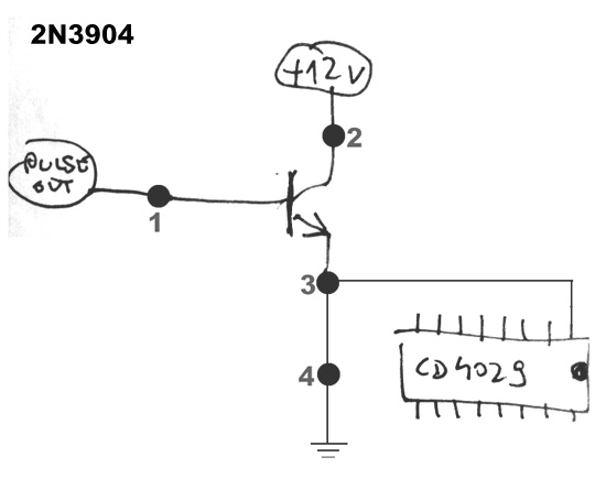

PostPosted: Tue Dec 10, 2013 9:50 am    Post subject: Reply with quote  Mark this post and the followings unread
analog_backlash wrote:
Hi Rogerlatur.
The label "to load" just means to the part of the circuit which will be drawing a current from the transistor. Looking at what you're trying to do, I would try pulling down pin 1 to ground with a 100K resistor and also connecting pin 1 to the collector of the 2N3906. Hopefully, when you send a pulse into R1, you should get a momentary 12V(ish) at pin 1 and the 4029 should reset.
I hope that works!
Gary
Hi Gary
Here is what I drawn before I saw your post.
I will now compare to your post.
 Filesize:  23.99 KB
 Viewed:  18383 Time(s)
rogerlatur
Joined: Dec 22, 2012
Posts: 118
Location: france
PostPosted: Tue Dec 10, 2013 9:54 am    Post subject: Reply with quote  Mark this post and the followings unread
I forgot resitor at 1.
Will add resistor between pin 1 and ground.
Will also change from NPN (2N3904) to PNP (2N3906) then.
I guess I also need to swap between collector and emitter !

PostPosted: Tue Dec 10, 2013 10:19 am    Post subject: Reply with quote  Mark this post and the followings unread
I was thinking of something like this:
 Filesize:  74.5 KB
 Viewed:  388 Time(s)
rogerlatur
Posts: 118
Location: france
PostPosted: Tue Dec 10, 2013 10:54 am    Post subject: Reply with quote  Mark this post and the followings unread
Very cool ! I was not sure about NPN or not. Thank you very much !
I will try this.

PostPosted: Tue Dec 10, 2013 11:17 am    Post subject: Reply with quote  Mark this post and the followings unread
Assuming pin 1 is simply grounded in the original circuit, you really don't need a "switch" here.
You probably just need to pull pin 1 down with a resistor to ground (if the reset input isn't permanently connected) and connect your reset pulse input directly to pin 1. Make sure pin 1 isn't connected directly to ground, otherwise you'll be creating a short.
The transistor circuit above is "buffering" in the input, which isn't necessarily a bad thing, but with a large pull-down resistor (e.g. >= 100k) you should have no problem driving it directly without a buffer.
You really don't want to think of this as "connecting two points of the chip together" when one of those points is VDD. You should be thinking of it as driving the preset input either high or low (active or inactive state).
"Connecting two points" implies passing a signal from one point to the other which isn't really what you're doing between pin 1 and pin 16.
You could say that's a semantic argument, and maybe it is, but this would be more typical of how we would explain what is going on here. Part of the "language" of electronics if you will.
Having said that, you may have an issue with the timing of the pulse depending on the circuit, but that's a whole other discussion Wink

PostPosted: Tue Dec 10, 2013 12:58 pm    Post subject: Reply with quote  Mark this post and the followings unread
I tried the circuit with the 2N3904 and it works. the pulse resets now the sequencer.
I tried before asking here all kind if things (...) and blew already another chip in the circuit making a short.
I did not know about the resistor between pin 1 and ground to protect from shorts ! Thank you very much for the advice, I will try what you suggest without the use of the transistor.
Also thank you for your clear explanations !!!

Hi again,
Glad that the circuit worked - I thought that it would. Actually, as gdavis has said, it should work without the transistor. I didn't think of that at the time, I was just thinking about how to get the transistor to work!
Connecting pin 1 to ground or +12V without the resistor should not have destroyed the chip (I've certainly built circuits with a 4029 pin 1 straight to ground). What the resistor is doing is pulling the pin to ground for most of the time (input pins shouldn't be left floating), but allowing it to be taken up to the higher voltage when needed (you cannot connect +12V directly to the 0V rail).
By the way, there may be a point in using a transistor to "switch" the input. I asked PHOBoS once why he often uses transistors in this kind of circuit and one of the things he said was that it would allow the circuit to be triggered by another circuit using a different voltage e.g. +5V from a microcontroller circuit.
