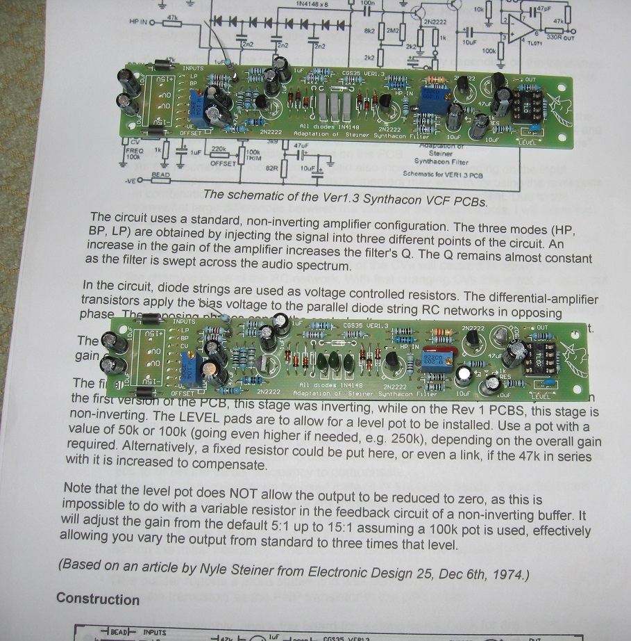

2 boards stuffed with components now.
The supply will be my usual +/- 12V, reading the documents, I have wire linked the 2 diode positions with the rings round them.

Module now wired & front panel finished , Tested the supply cables & powered it up without chips first, then power up with chips , all good so far .
Just need to set up the cv trimmer for the cutoff action and also set the trimmer I put in instead of the 2K2 in the resonance area.
I used 2N3904 for npn on one vcf and 2N2222 on the other vcf , both have 2N2907 for pnp ,the 2 vcf's sound pretty similar , but I've used up what was in the component drawers Smile .
