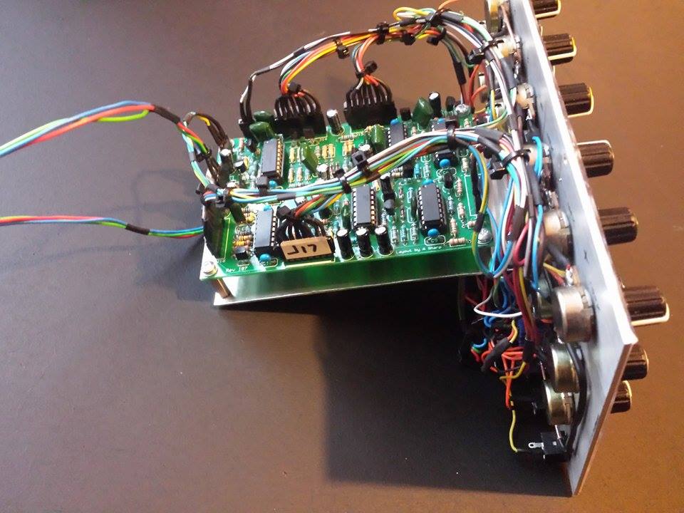

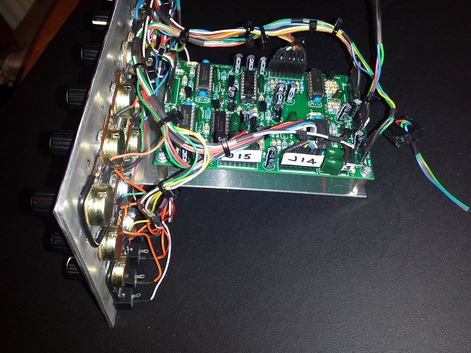

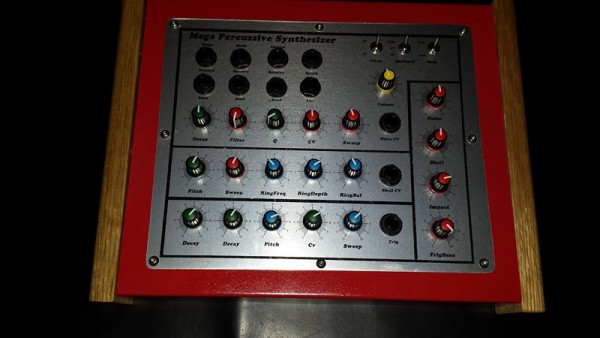

Decided to build another MPS after some one giving me a board so its going into my euro rack so far here a few pictures
P.S Installing a second power supply 15- ov 15+ for mps, Oakley little LFO,ETC

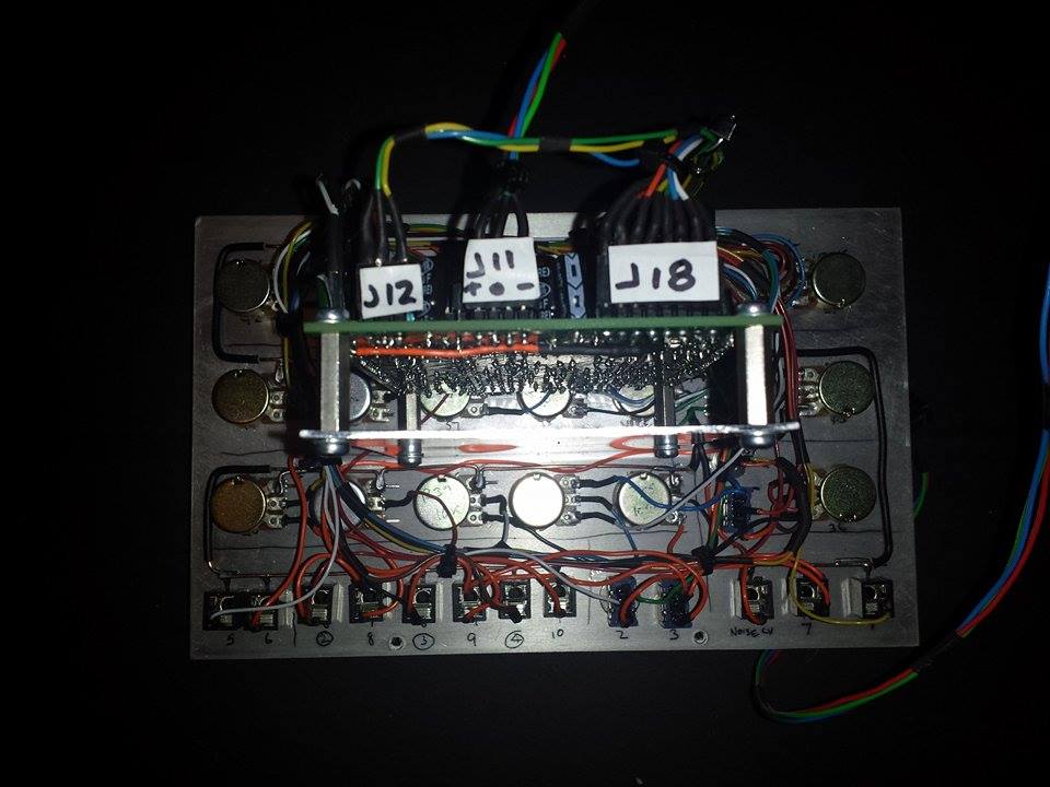

PostPosted: Thu Apr 17, 2014 3:30 pm    Post subject: Additional power inputs question
Subject description: MPS J12 and 19 unsure how to wire
Hi there,
I'm about to embark on building a couple of these and I have a question about something I've not come across before that is a bit basic I think, but as it's concerned with something on the MPS boards I thought I would post it here.
Back on page 24 of this thread kkissinger has kindly made a list of the wiring on the board. It shows J11 as where the main power comes in from the power supply. J12 and J19 also are listed as bringing + and - V in. I'm unsure how this works. From looking briefly over the schematics I'm assuming these additional voltages would be 15v. Am I right in thinking that? Would there need to be separate connections from the PSU for these? Or are they something else and if so can anyone guide me towards some info on how to get everything set up power-wise? I have a +/-15V PSU with a distribution board assembled ready for this project. This issue is the only thing stopping me getting on with the soldering at present so any help would be much appreciated,
Thanks,
Jon
PostPosted: Thu Apr 17, 2014 4:59 pm    Post subject: Reply with quote  Mark this post and the followings unread
J11 is power in
J12 is power out to the various pots that need it.
Not sure what 19 was for, mine is in the basement and not convenient at the moment; I could check it out later if you need.
jpjsenior
Joined: Jan 04, 2014
Posts: 3
Location: Bristol, UK
PostPosted: Fri Apr 18, 2014 8:17 am    Post subject: Reply with quote  Mark this post and the followings unread
Thanks man, that makes sense. Gonna spend a bit of time studying the schematic against the boards I reckon before getting started.

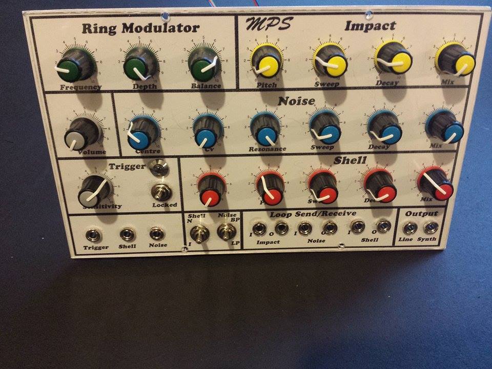

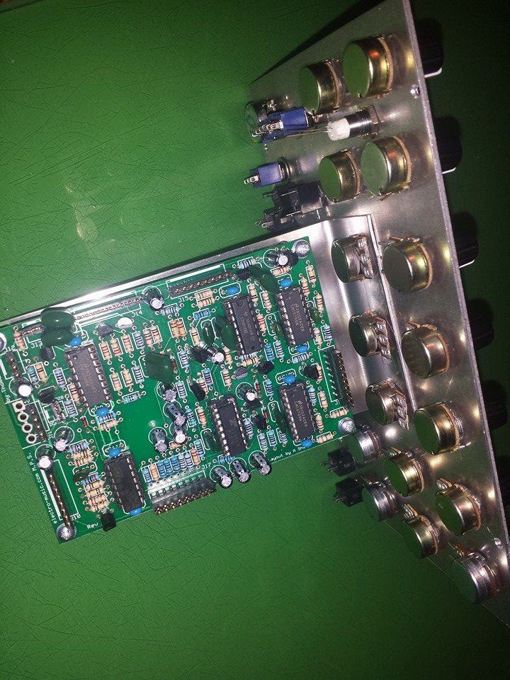

PostPosted: Sat Jun 14, 2014 1:55 pm    Post subject: Reply with quote  Mark this post and the followings unread

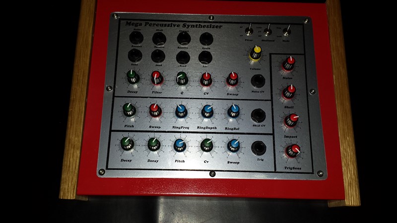

I would like to take full credit for this project but I cannot my friend wired the thing up and got it working I did make the front panel and drill the holes and solder the parts on the board with I guess some errors Smile

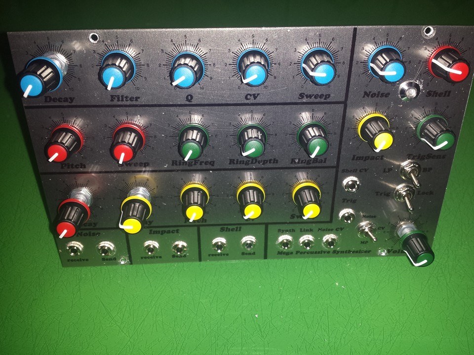

I just finished building a 2U MPS module. I was greatly influenced by sduck's design and tweaked it to fit my modular style. I bought the XR-2206 at Jameco and everything else at Mouser. I have photos and documentation on my MPS Module page http://modularsynthesis.com/electro-music/mps/th-mps.htm

I'm curious about the reasons for the modifications you listed....

I'm not sure who you are asking. If it is my modifications it is simply I bought a lot of 100K potentiometers so want to use them whenever possible. There were four 10Ks that were easy to change to 100K. The second mod is I didn't install the volume control but it is one half of the load on the output capacitor to bleed a charge off of it. I increased the load from 20K to 100K just because I wanted a higher DC resistance. The third mod is simply I wanted a manual trigger.
PostPosted: Sun Nov 23, 2014 10:56 pm    Post subject: Reply with quote  Mark this post and the followings unread
Yes, I was asking you Smile. Some of us have had issues with low output levels, even on the "Synth" level output, and I was curious if anything you modified was perhaps to address that. Obviously not Smile

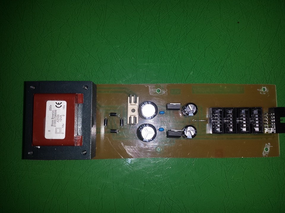

PostPosted: Mon Nov 24, 2014 1:33 am    Post subject: Reply with quote  Mark this post and the followings unread
My stand alone version runs of the mains

I updated my web page at http://modularsynthesis.com/electro-music/mps/th-mps.htm with scope images of the levels through each of the three sections. I measured at the source, at the VCA, and at the output. The issue is you are summing three sources, so if you want to keep the output at 10V pk-pk you need to keep the individual sections less than that so they add to 10V pk-pk. The Locked feature makes it easy to measure the levels. Impact is the largest at 4.3V pk-pk, Shell is lower at 2.7V pk-pk and noise is the lowest at 1.3V pk-pk. The overall output with all section at max is 8V pk-pk. Remember, these are measured so there will be some variation between builds.
If you want to increase any of the section levels, just decrease the corresponding mixer resistor R90, R91, or R92. These set the gain at the mixer and 200K sets the gain to 1/2. 100K will set the gain to unity (so it will increase the gain of that section by 2X). If you wanted all at equal output then you could adjust the resistors accordingly but the mix seems about right to me.
If you want to keep the mix then simply increase R77. If you increase it to 200K then the output levels will all double.

Remember also that if the ring modulator depth is set low then the ring modulator balance affects the shell level output. On mine full CW is louder than full CCW. I put an explanation of that on my site also. I eventually changed the gain of Shell by increasing it 4X and Noise by 2X. Details are on my web page.
I also found that the Impact envelope decay was erratic and added a 51 pF capacitor across R94. The trigger comparator was glitching quite badly and this settled it down. All changes are documented in my Modifications section.
