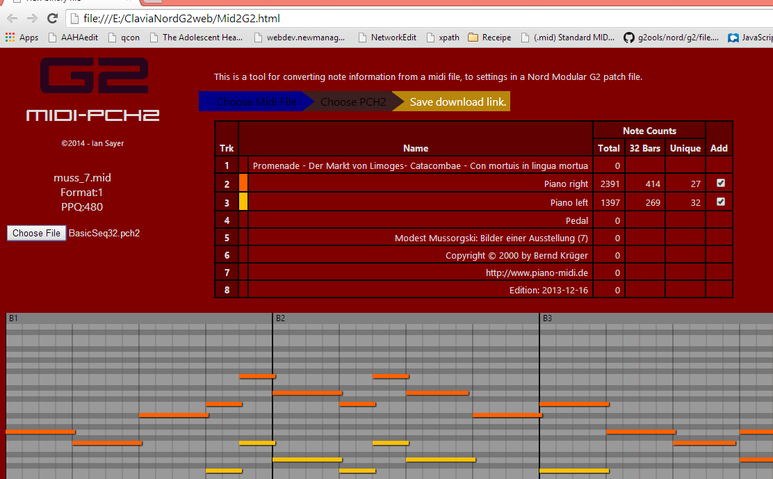

Here is a screen shot of the app. Still need to tidy up the code and add some features.

I like it! How many bars max, 32 ?
a new web based tool
you mean the tool will be hosted online ?

The template chains four seqlev modules for each row, I'm sure we could do eight for 8 bars per variation but we might have to spill into the fx area.
The first template works ok for 4:4 that is quantised to 16th notes. I have another that uses the x6 clock to give fewer bars at a higher timing resolution.
The bottleneck is the number of unique notes per variation. The allocation algorithm resets each note send to the note values used in the current variation while preserving any row that had the gate on in the last step of the previous variation. There is also only one velocity per step so it represents an average of all notes starting in that step.
The app is just standard HTML/css/javascript which will run on chrome/Firefox/safari. It almost runs on IE10 but the download link doesn't seem to work.
I'm not sure at the moment if I'll put it on line or make it available as a zip that you can run locally. I have a homepage account with my ISP but I think I have used all my space.

This site would be the most logical place to put it. I have found a 15Mb video on my homepage that was no longer required so looks like I have plenty of space for the Alpha version for the moment.
The app and resources are only about 70Kb so far.
So here is the link for the alpha.
This is purely alpha software at the moment so don't expect too much.
A lot of work to do yet.
You will need to download some midi files to your local computer and the template attached here. I used muss_7.mid which you should be able to find with google.
Known issues.
The code is currently dependent on the structure of the template patch, you can customize it but deleting any of the notesend or seqlev modules may cause problems.
I haven't coded for sysex in the midi file so it may fall over if present.

Before I used an external sequencer to fit a MIDI file into a g2 patch. It's very fast with your tool. It works well! Thanks!

New link has better version. The patch has been de-glitched properly with s&h modules. The page also lets you alter the time ref so if you have a file where the min note value is 1/4, you can scale it to get twice the length (halving tempo). Other factors allow for increase time resolution, the 1:6 might require switching to the 1/96 clock output.
Edit:
The last fix I did this morning corrected an issue with gates not extending to the last step in a variation seems to have caused some notes to be dropped. Will look at it again this evening.
When working, the code will go into a general purpose app that will accept midi, bin, wav, scala etc. I'm thinking of allowing js in the text pad of a pch2 file so you can write code to set sequence levels etc.
Turns out some of the compressed notes were simply running into each other. Added some code to make sure the last 16th step before a gate start is zero.
I think the code is good to translate over to the main app now but I'll take a little break.
