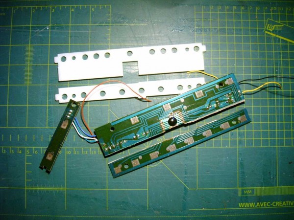

I don't have enough unfinished projects so i started on another one Rolling Eyes
A while ago I found some 8 position slide switches and got the idea of using them to make a simple (gate) sequencer build into a small keyboard.
The keyboard I will be using is very simple and only has an 8 note keyboard, 5 different voices: piano, bird, dog, frog, voice and a demo mode.
The idea is to use a counter (CD4017) with a slideswitch on every output to select a key to be triggered, so 8 keys is perfect Very Happy.
The keyboard keys are just switches that connect an input of the chip (blob) to the positive voltage (4.5V), so no scanning matrix and very easy to trigger.
There is a resistor (+ capacitor) that controls the pitch so I will add a potentiometer for tuning. Nice thing about this keyboard is that it has a lot
of space which is useful for the switches. Cool

Posts: 5939

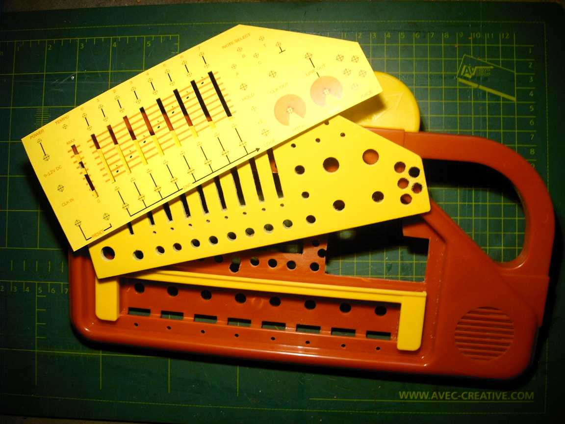

Posts: 5939

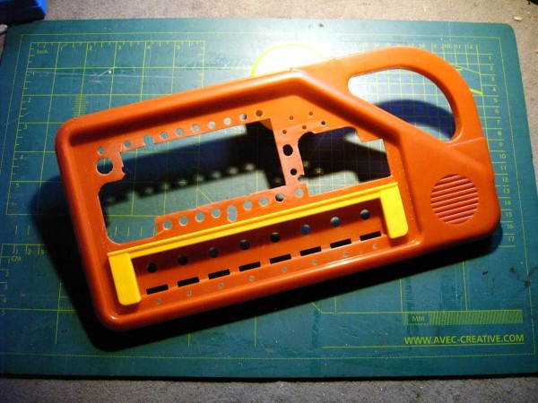

PostPosted: Sun Jul 13, 2014 1:53 pm    Post subject: Bay-B-Key - progress pics Reply with quote  Mark this post and the followings unread
I was just done putting a protective coating of glue on the panel when I dropped it on the carpet (like a peanut butter sandwich) Mad
It went ok on the second try,..
recently I cut my,.
 Filesize:  94.3 KB
 Viewed:  805 Time(s)
and I cut this too
 Filesize:  97.32 KB
 Viewed:  808 Time(s)
panel parts
 Filesize:  75.02 KB
 Viewed:  831 Time(s)

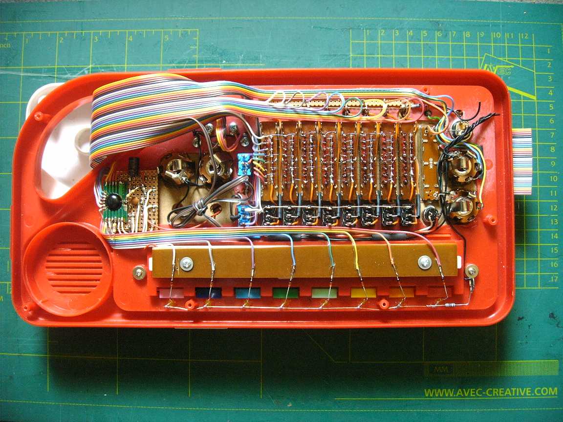

PostPosted: Sat Jul 19, 2014 2:14 pm    Post subject: Bay-B-Key PCB Reply with quote  Mark this post and the followings unread
finished soldering the PCB, now to wire it up and hope it works Cool

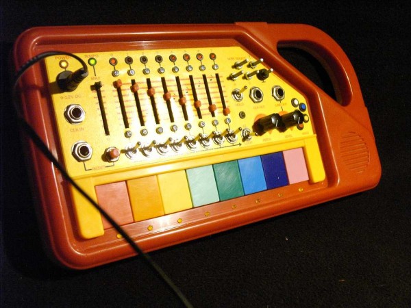

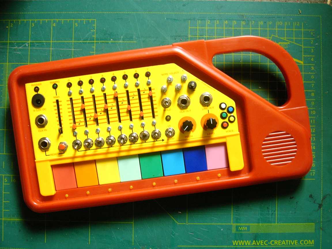

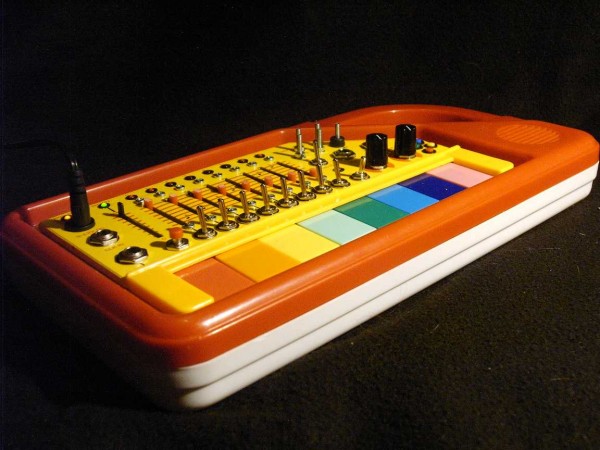

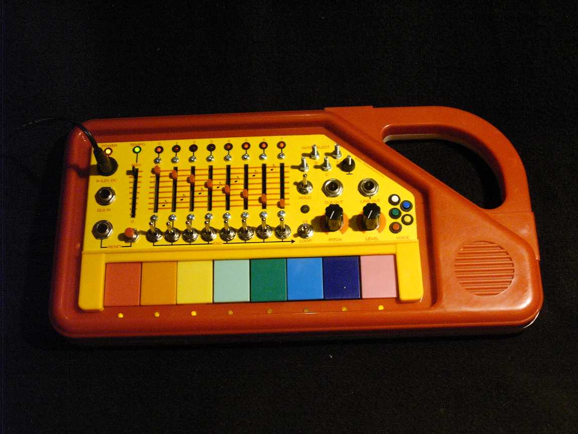

Finished it sunday and it almost fully worked on the first try except when I inserted the CD4051 mux it started acting a bit weird. I thought
I might have to put some diodes in series but I first tried another chip,. and that worked Very Happy not sure if the other one was faulty or because it's a
different brand (at least I think it is). Will probably record a demo, although when I try that it might turn into something else Wink
Here are some more photos. It doesn't really look much different but it has blinky lights now Laughing
