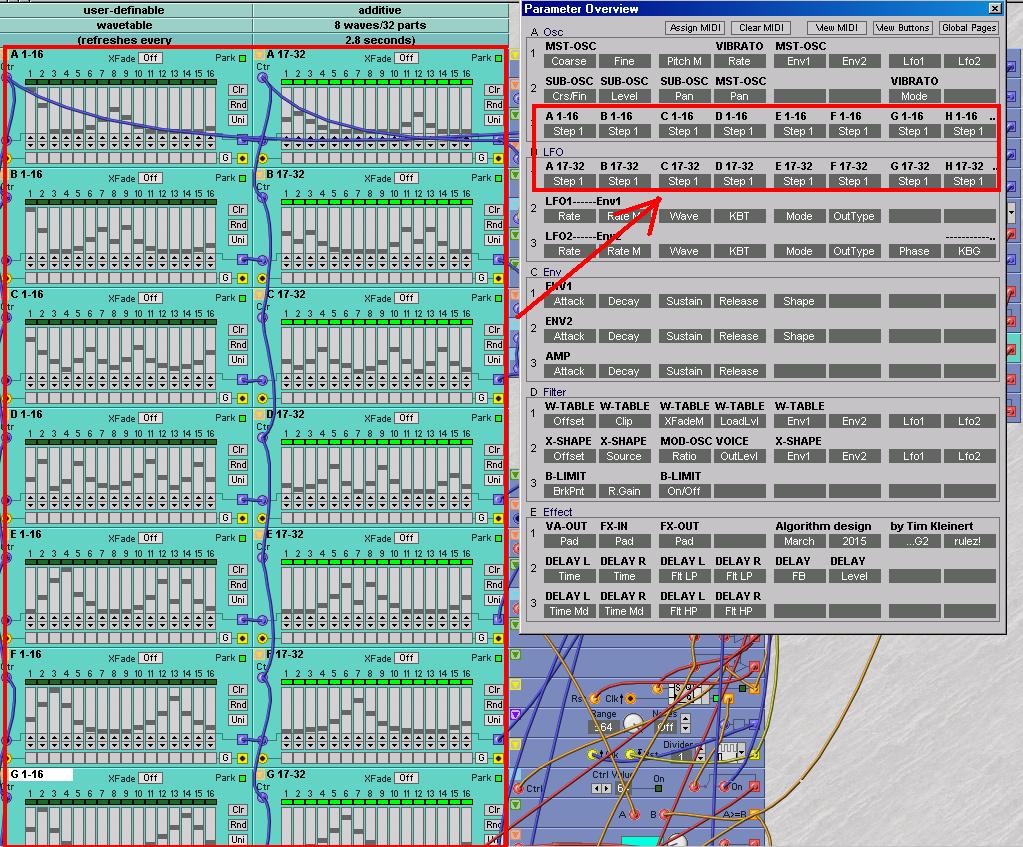

The control-sequencers containing the partial levels of the 8 wavetable stages obviously don't fit on the panel. They are however strategically placed in the first two columns of the FX section. By entering "patch" mode and scrolling down into the FX section, the wavetables can thus be directly edited from the panel. I was actually surprised how well this works, it's actually quite user-friendly. (Tip: assign the mod-wheel to wavetable position when you edit the waveforms, so you can conveniently move back and forth while tweaking.) The 8 additive wavetable stages are labeled A to H, each comprised of two control-sequencers (further labeled by 1-16 or 7-32 for the partials).
All variations are populated with quick'n'dirty stuff, as I've barely scratched the surface of what this patch can do. The first 7 variations each demonstrate one of the waveshaping modes. Variation 8 is a default init setting.
I use a workaround for this. I just assign the 1st step from each sequencer to the 'parameter page'. Like this, I need 2 pages to fit 16 sequencers.
The shorcut :
1. Press : Copy + the module sequencer you want to access (from the parameter pages)
2. Press Patch.
After that, you can access any sequencer quickly. If you just need to edit 'E 1-16' or F 17-32".
I edited the parameter page in the patch to understand what I mean.
