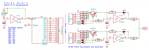

Yesterday elektrouwe, Christoph from roboternetz.de, and me had a great time during a spontaneous Lunetta meeting organized by Uwe. Thanks Uwe! We didn't build anything, but we had a lot to discuss. Christoph showed me a circuit that would divide down a pulse train and that sparked an idea. The original circuit used a 4066 analog switch, a pot, and a diode in series. Instead of that I though about using a resistor network and a transistor in series and omit the diode. It actually worked right away.
I call this thing a pulse controlled oscillator because it needs a high frequency pulse or square wave to work. These pulses are sent to the transistor which opens for short times and allows a current from the resistor network to load a capacitor. Once the capacitor voltage reaches the trigger level of the 40106 Schmitt-Trigger inverter, the output changes to low and the capacitor is immediately discharged. Then this process repeats, resulting in a series of short negative pulses at the output of the inverter. The frequency is determined by the current that is switched onto the capacitor. By using a resistor network of three resistors plus a pull-up resistor, I can generate eight different tones by connecting the resistor to logic levels from other CMOS chips. Five oscillators could be built this way from the inverters of a single 40106 chip, sharing a high frequency oscillator made from the sixth inverter.
Below is a circuit that shows how the oscillator could be used. A low frequency oscillator from one inverter feeds a 4040 counter to get a series of low frequency clocks. These can be patched to the inputs of two pulse controlled oscillators. Actually, you could build two more and still would need only one 40106 chip. If you try that I recommend that you use two 680nF capacitors for the additional oscillators.
By connecting the resistor network to different outputs of the 4040 counter, you get different sequences of eight tones. In addition to the resistor network, I added three diodes connected to the base of each transistor. Two or four diodes would be possible as well. These work as a wire-AND gate together with the 100K base resistor. By connecting the diodes to the 4040 counter outputs you will get different rhythm patterns for the melody by disabling the oscillator every time any of the diodes is connected to ground level. You may leave any of the inputs open, there is no need to connect each of them.
In this circuit the output frequencies from the oscillators are finally added via 47K resistors. Instead of using resistors to mix the outputs, they could also be combined by a logic gate and then fed the result to a counter or flip-flop to get a square wave again. That sounds much nicer, but I wanted to keep the circuit simple.
In the recording I start with a nice pattern and after a while begin patching the inputs randomly to other outputs. At about 3:00 min I increase the speed of the 4040 clock for a while. The sound of the circuit is pretty raw. If this is too raw for you, try adding a delay of 0.2 to 0.4 seconds to it and it will become really interesting.

PostPosted: Sat May 02, 2015 11:24 am    Post subject: Reply with quote  Mark this post and the followings unread
cool circuit.
could a saw wave be taped from the capacitor?

Nah, this circuit wasn't ready for posting yet. There are a few things I need to add. First, the high frequency switching does have an effect: it does divide the pulse rate down a bit. However, the oscillator works fine without it as well. To make things simpler I removed it. The capacitor needs to be increased a bit then. Also, a small resistor in series with the diode in the feedback path makes the pulses a bit wider. That makes it actually a current-controlled oscillator. I changed the topic text for that reason. And finally, two diodes for the wired-AND are enough. I haven't used all three of them so far. That makes a couple of changes and thus here are two more pictures and a new recording.
I am still not perfectly happy with the circuit yet. Even with two identical capacitor values (well, face-values), there are a lot of dissonances. The capacitor and resistor values will never be so well tuned that the frequencies become harmonic. Maybe there is a way to sync the oscillators somehow so that the dissonances go away? Any ideas are welcome.

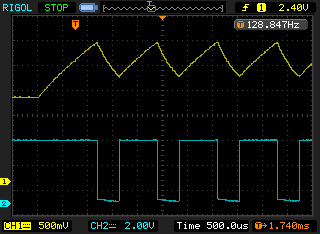

Sorry glot, didn't mean to ignore your question. I needed a bit of time to clean up my messy workplace and move the circuit close enough to the scope Embarassed
Here is a picture captured from the input (yellow) and output (blue) of the inverter. There is indeed a saw-ish wave there, but it probably cannot be captured here without buffering. The output is a pulse wave. In the picture the pulses happen to be quite wide, but most of the time they are much narrower. To get a nicer waveform I found it easier to add a capacitor of a few hundred nF at the output. This is exactly what I did for the next version of the circuit.
Here is another recording sample to whet your appetite. Nicer waveforms, but so far only two oscillators of five used. The circuit will need only two CMOS chips.
