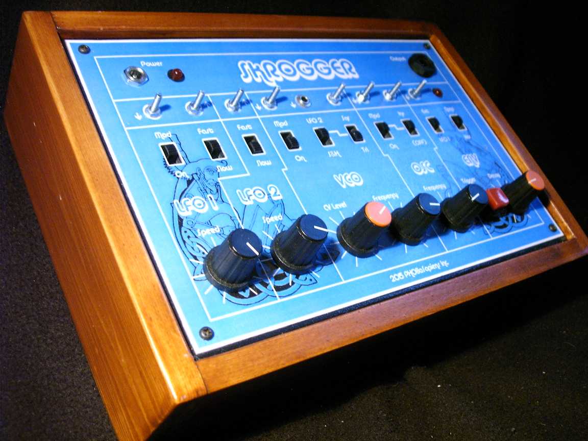

So I'm using them to make a simple (lunetta) synth. I thought about using the 555 for an envelope generator
and the 4069 for a filter but that's not what I did. Instead I'm using the 555 for a VCO and the 4069 (together
with some gates of the 4025) for some (LF-)oscillators. The 4066 + LF351 immmedialy seemed useful for a S&H
but I wasn't sure what to do with the other 3 switches. Eventually I used one for a VCA, which works pretty
much the same as the diode version, and the other 2 as inverters. The 4011 NAND gates are combined
for an XOR-ringmod.

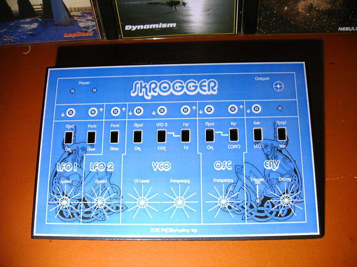

I will post the schematic after it's all hooked up and tested but here's a photo of the frontpanel.

Nice Skrog inspired blue Smile

I used the exact same shade of blue as the Super Sequencer panel layout he posted here.
Of course it's not done with the same printer so it might be slightly of but it's the idea that counts.

WoW , Amazing Smile Smile , fantastic panel , I like the 2 celtic pipers Very Happy and what a lovely shade of blue, good choice Very Happy Very Happy .

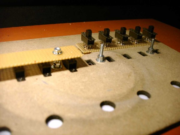

Here's a photo of how the slide switches are mounted.

That's a great way to mount the switches , saves having to source 2mm thread screws for the switch tabs, good stuff Phobos.

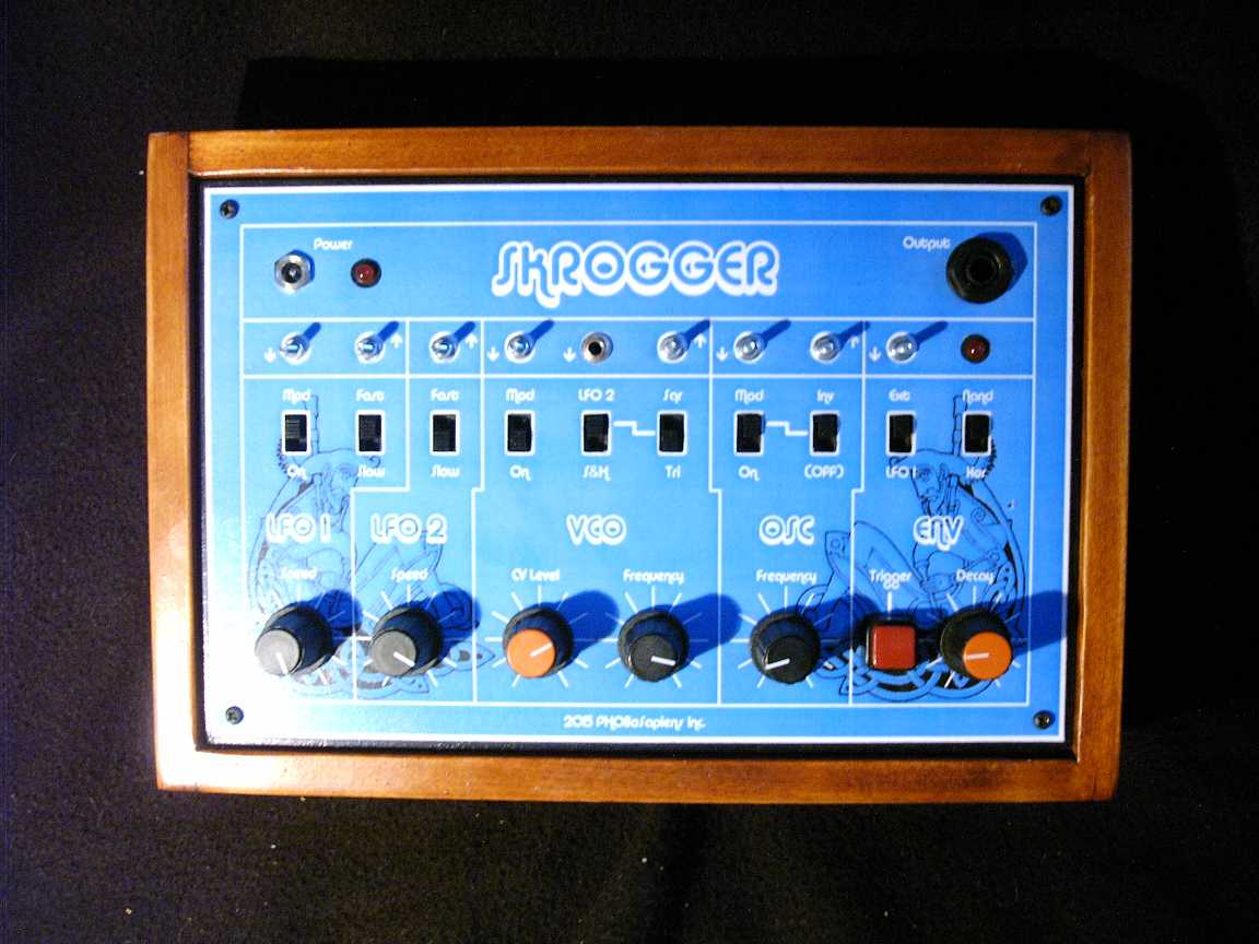

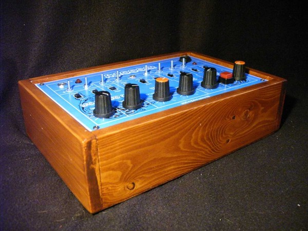

I used some stained wood for the case this time instead of the usual MDF. And I wanted to record a demo but when I started playing
around with it yesterday I also added some other stuff (as usual). You can find some excerpts of that Skrogging session posted here. Razz
And you can also here it at the beginning (and throughout) Phytoplankton.
