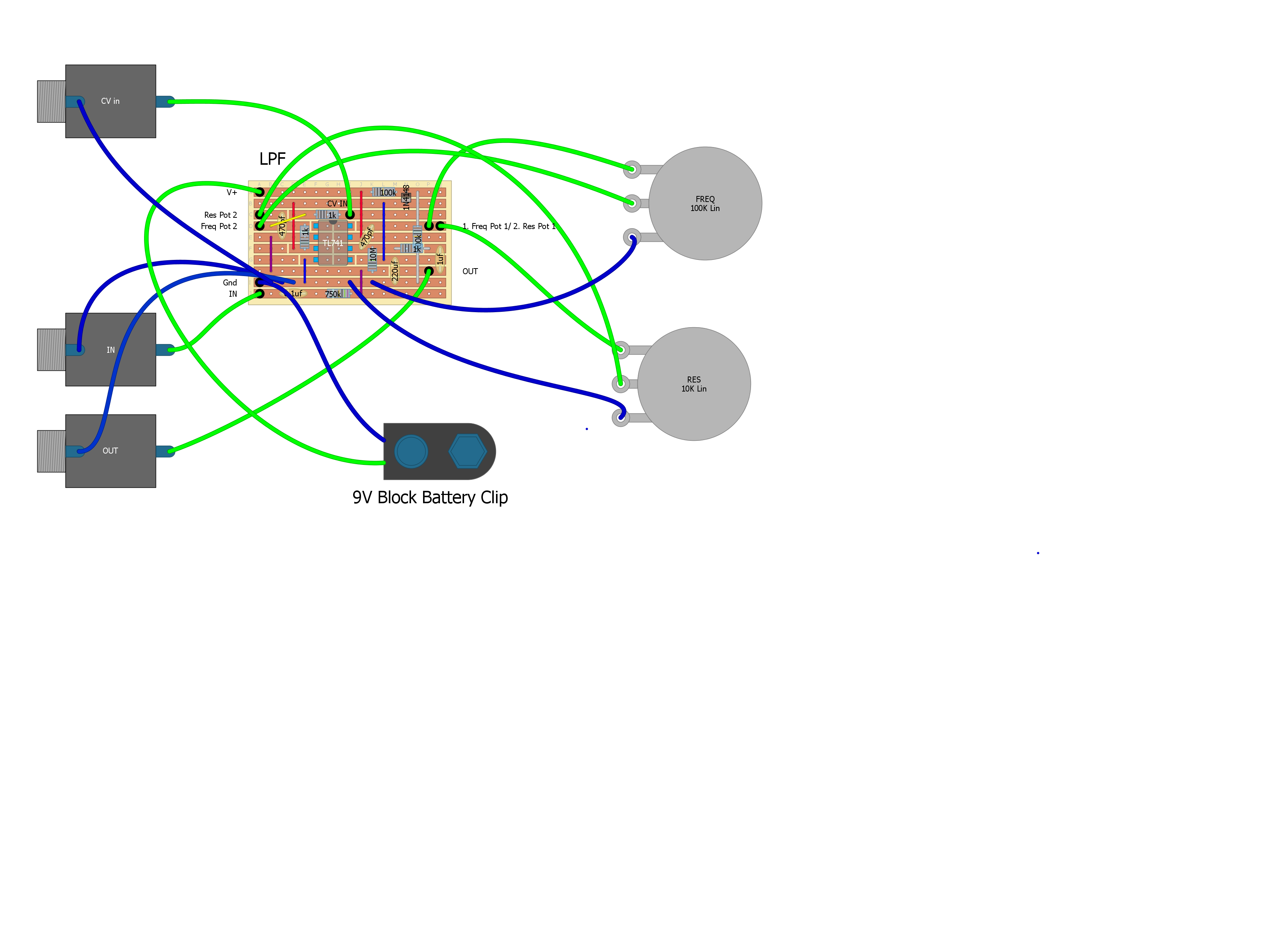

i know this post seems very dead! but i made a stripboard version of the vcf for a microcontroller based application and i want to hear your feedback. Any mistakes?
i am pretty new and not very into electronics. only getting started Smile

wackelpeter
Joined: May 05, 2013
Posts: 461
Location: germany
Audio files: 10
PostPosted: Thu Aug 13, 2015 9:41 am    Post subject: Reply with quote  Mark this post and the followings unread
i think it would be better to post schematics instead of a layout as most of us (especially myself) are a bit lazy...
schematics are better to look at and see to see if something looks suspect..
first of all i would add in Input resistors for all external Inputs... and then i'm not sure if a 741 will run on 9V... i think it's supposed to be run on a + and - supply... the LM3900 or LM324 can be run on single supplies i know...
but maybe i'm talking nonsense and the 741 will do the job... well as i said i'm not sure...
Ray_Ketamu
Joined: Nov 03, 2014
Posts: 48
PostPosted: Thu Aug 13, 2015 10:09 am    Post subject: Reply with quote  Mark this post and the followings unread
thanks for the reply. its the conversion of the picture of breadboard on bottom first page of this thread.
resistor to input. check.
i will check the ic issue.
