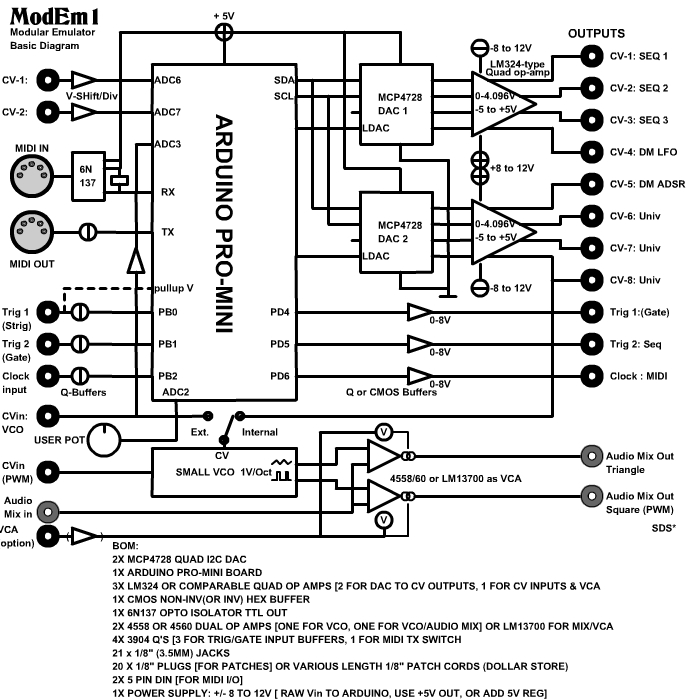

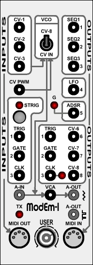

Joined: Feb 25, 2015 Posts: 8 Location: Vancouver BC
Posted: Sun Sep 06, 2015 7:30 pm Post subject:
Aw it's too bad this topic didn't continue. For some reason most of the images & links aren't loading.
I've been designing a simple MIDI to modular converter as a matter of necessity and came up with this (supposed to be euro rack but I think is too high!)
And the basic schematic
for anyone thinking it over, maybe this is a good way  |
