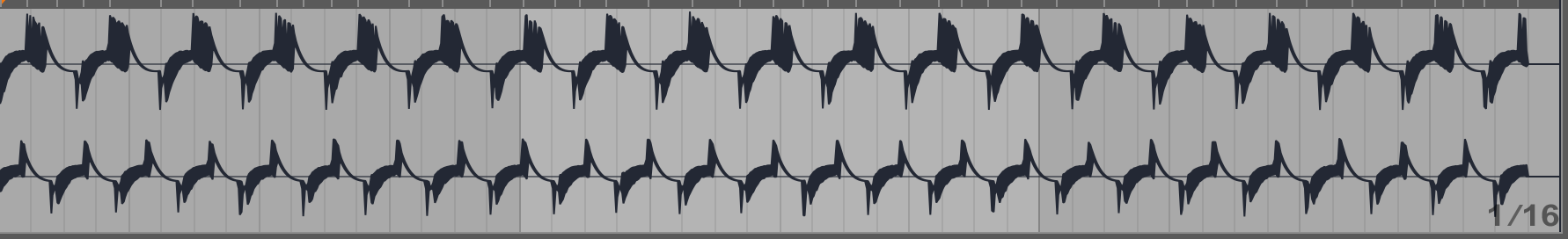

I thought it might be instructive to look at some waveforms. I worked with low frequency pulses near the temporal boundary between distinguishable pulses and pulses that merge into bass tones.
This post shows the new Galaxy AXS-10 (the red mixer) with L and R saturated and the compressor fully engaged for my default.
I'll show the other mixers in posts below, so as not to run out of attachment space.
| Description: |
| AXS-10 pulse train approximates a clean reverse sawtooth |
