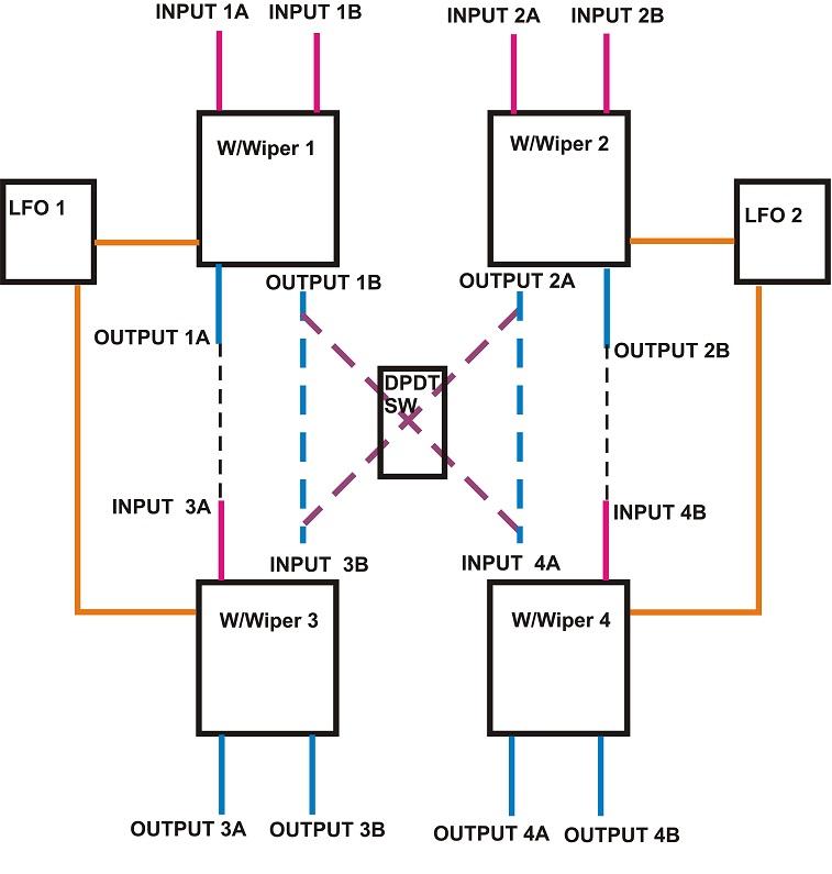

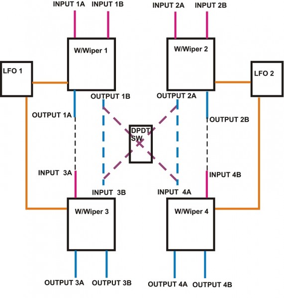

Phobos helped me out when I had a wee anomaly on the breadboarded V2.1 circuit , thanks again .
I had an idea for something using the wave wiper and done some tests to see what happens when running 2 wave wipers in series and also to see what it sounded like with FX / filters / wave folder / 5pulser etc between the wipers almost like a send & return loop , the results were that pleasing I have decided to build a 4 wave wiper module Smile Smile Smile Smile .
I was initially thinking of having 4 fully modular wipers , and changed my mind to have 2 fully modular ones with a slave wiper under each with an added cross over switch to swap over output 1B and output 2A , which will be wired through, going into input 3B and input 4A, also a couple of veroboard simple LFO's
The diagram below is showing the inputs and outputs & how the cross over switch operates in the middle and the lfo destinations.
The bottom file is version 4 of trying a few hardware layouts ( to be turned skrog blue once im ready for ordering a panel sticker) .
Dave.

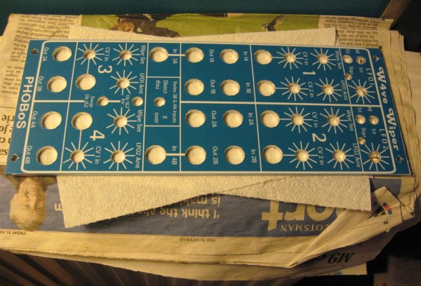

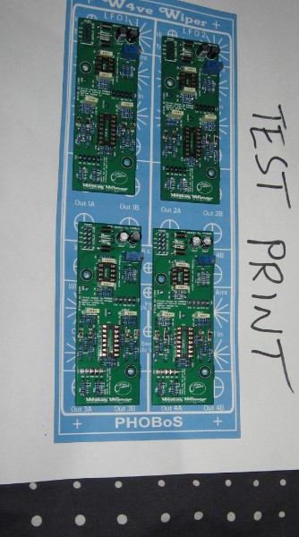

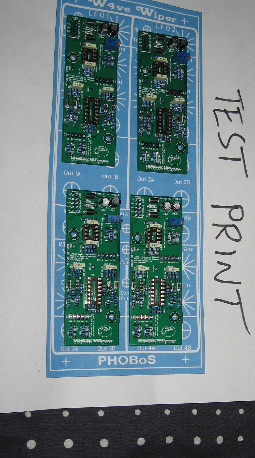

PostPosted: Sat Jan 30, 2016 5:47 am    Post subject: Reply with quote  Mark this post and the followings unread
Hi Smile

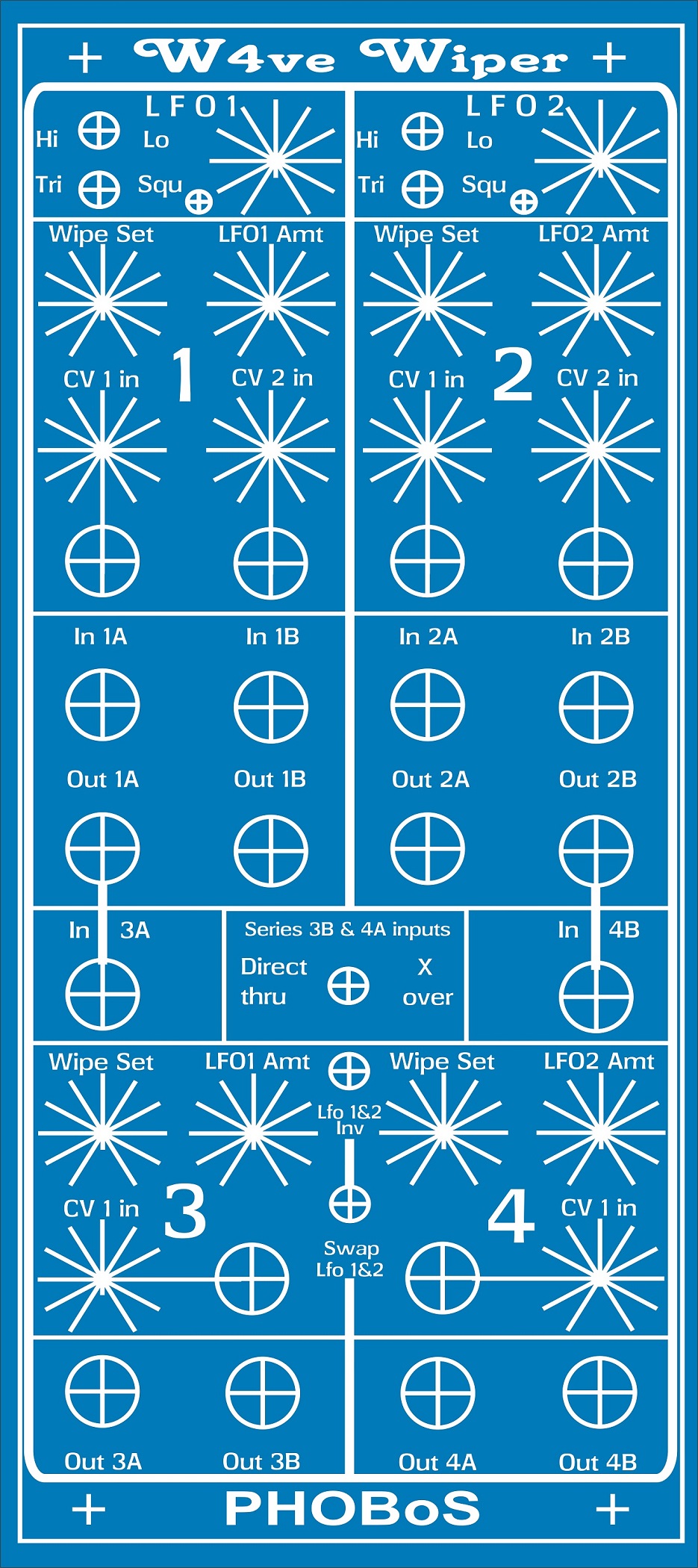

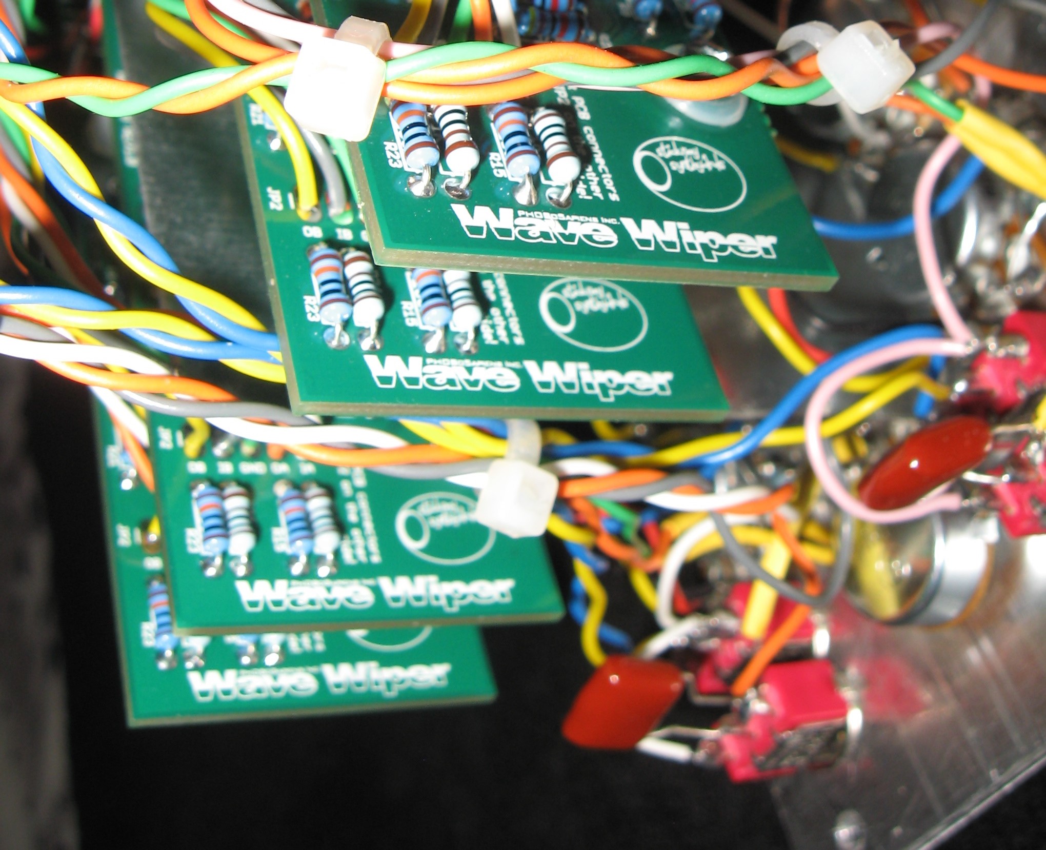

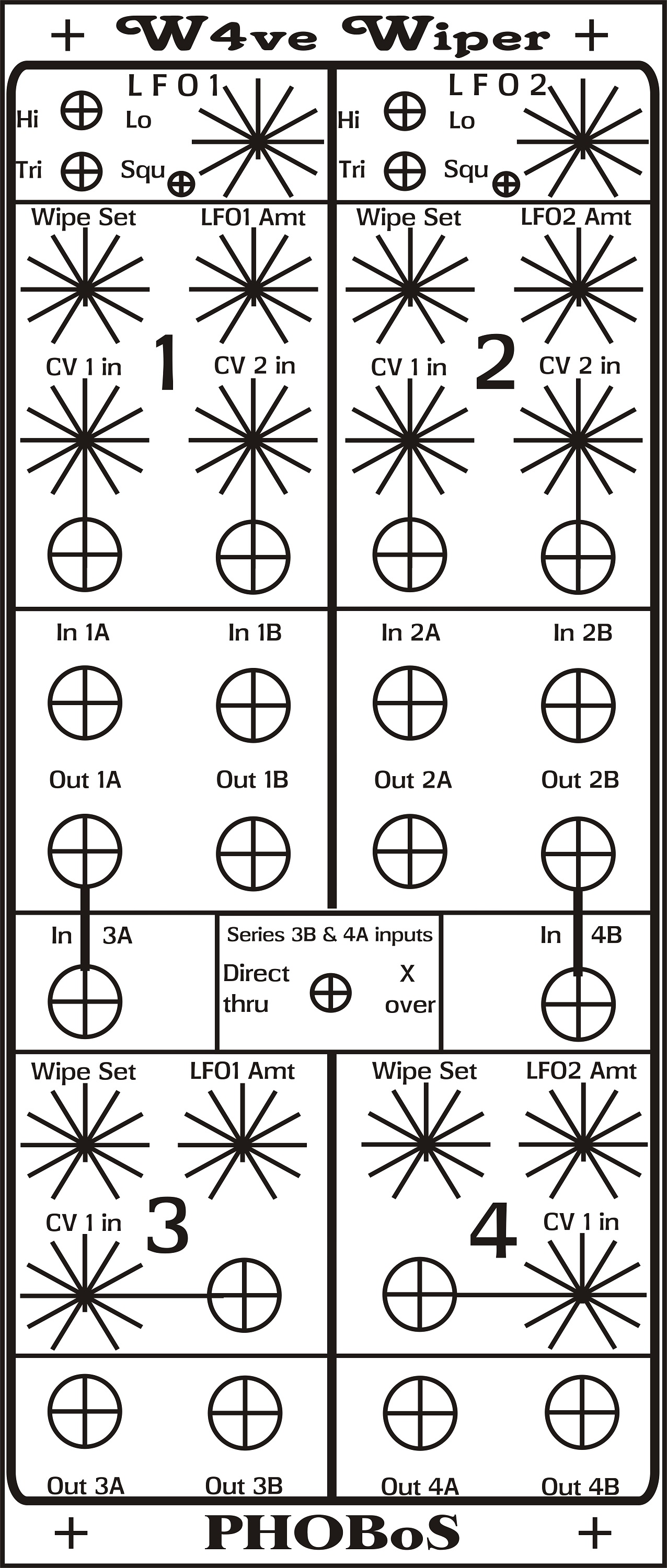

Boards arrived early in the week , thanks Phobos , snapped off the top boards & got to work soldering the diodes / resistors / ic sockets / caps etc onto the 4 main pcbs .
Also finished the final layout on the panel (100mm x 250mm) , legends converted to blue and was thinking about the lfo's controlling a series wave wiper stack each , both stacks lfo amount into 1&3 / 2&4 would be swept the same direction , so I squeezed in 2 extra switches , one inverts the respective lfo1 / lfo2 into the slave wipers only, and the other switch will swap lfo 1 & 2 over (lfo2 to wiper 3 , lfo1 to wiper 4)
Hope to get the final sticker design ordered through next week sometime.

Posts: 5905
PostPosted: Sat Jan 30, 2016 8:25 am    Post subject: Reply with quote  Mark this post and the followings unread
looks promising dave Very Happy

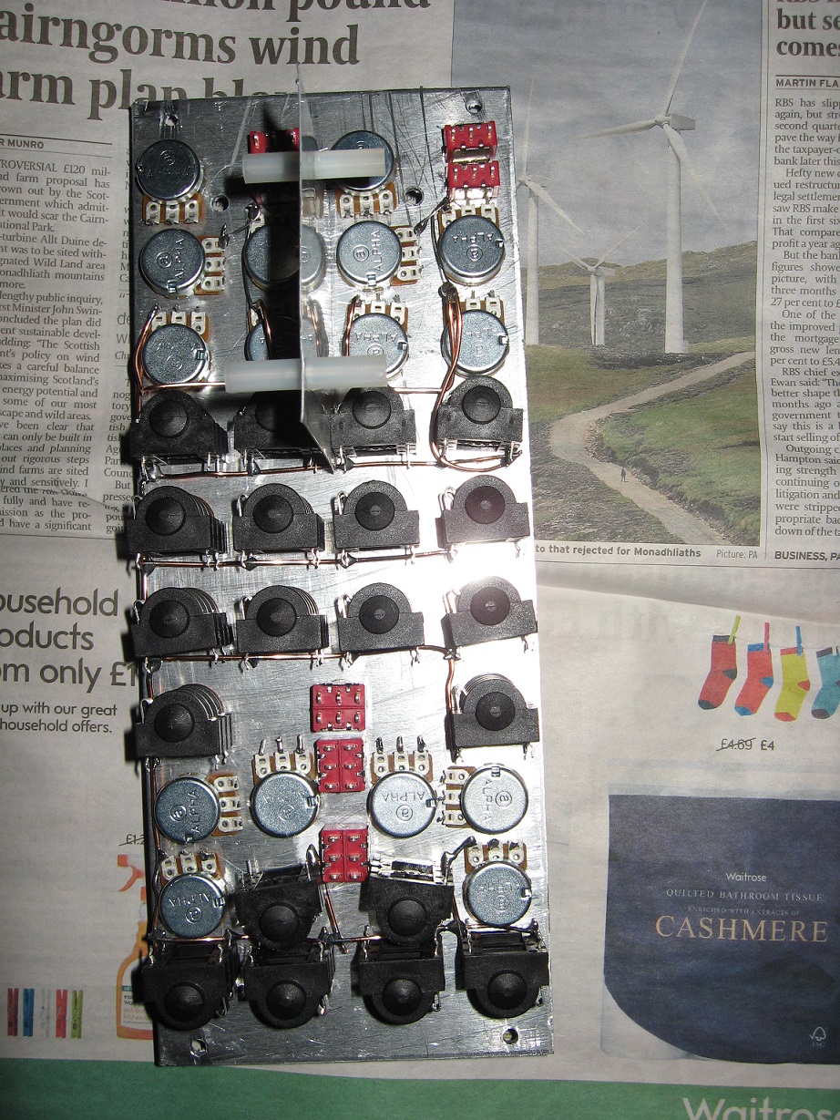

Hi all , I was bedridden with a nasty flu bug most of last week , managed to do a bit of construction on the W4ve wiper Friday evening & yesterday.
Panel drilled & sockets, pots , switches fitted to faceplate now , 4 boards plus add on veroboard circuit with the 2 LFO's is attached .
wiring to pots & jacks all done, now ready to test & record some demo sounds later tonight....
Dave.
 Filesize:  848.25 KB
 Viewed:  637 Time(s)
 Filesize:  545.07 KB
 Viewed:  624 Time(s)

Posts: 5905
PostPosted: Sun Feb 14, 2016 5:09 am    Post subject: Reply with quote  Mark this post and the followings unread
That looks great Dave! can't wait to hear it. too much coffee
and nice solution with the bracket sandwich.
