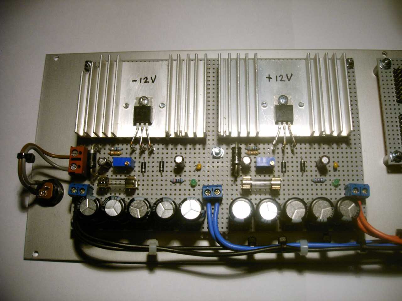

I couple years ago I bought two 19" rack cases. I modified one of them, turned it over with the front facing down
and used it as the case for my modular lunetta.

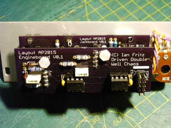

I had been thinking about using the other case for a synth with some chaos modules and maybe some (VC)LFO's.
I wasn't really planning on starting on it yet and first finish up some other stuff but for xmas I got a PCB set
from AlanP (thanks Alan! Very Happy) for a "Driven Double Well Chaos Module" (Ian Fritz design), to be used as a euro module.

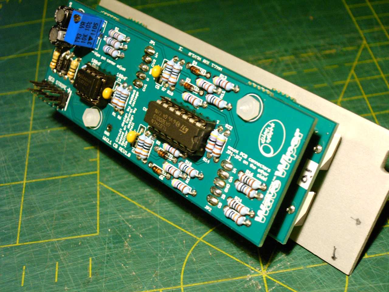

I also designed a PCB set for the WaveWiper to be used as a euro module as well. And to test those
I need a case with a PSU.

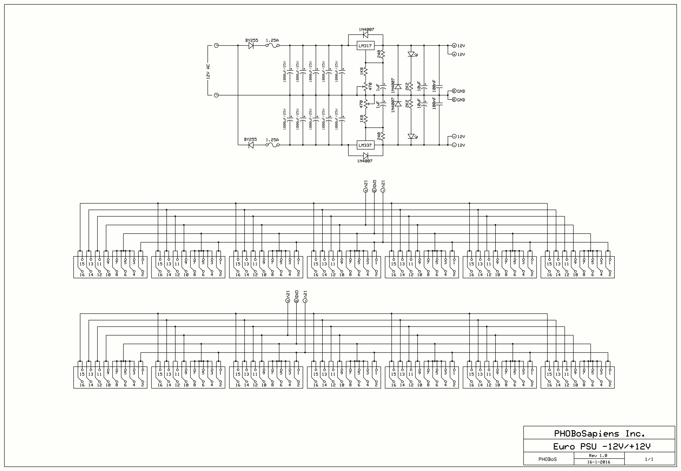

So that's what I started with. I made a LM317/LM337 regulated -12V/+12V supply powered by a wall wart.
Reasons for using a wall wart are weight, size, safety and I didn't have a suitable transformer.
Here are some photos and the schematic.

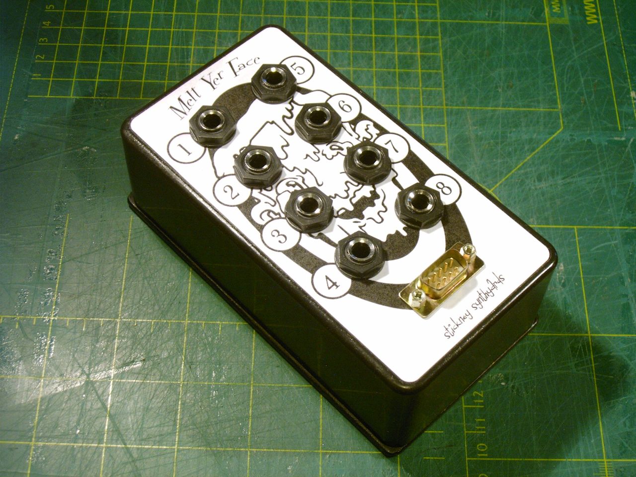

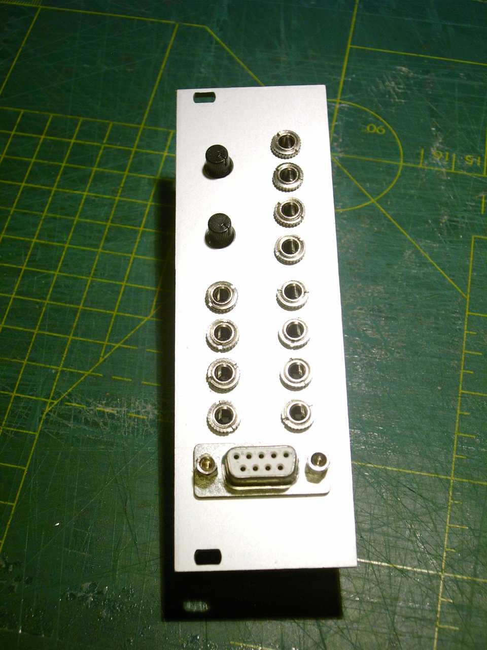

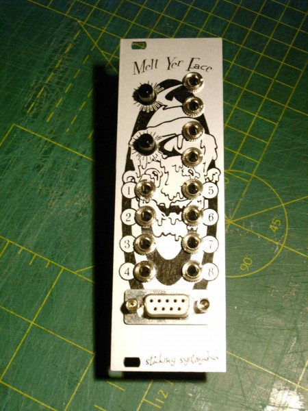

All my other synths use 1/4" jacks so I need something to convert those to 1/8". My initial idea was a panel
with both 1/4" and 1/8" sockets but you can't get a lot of 1/4" on a panel. So instead I made a panel
with 8x 1/8" sockets connected to a 9P sub-D connector. This will plug into a breakout box with 1/4" sockets
which, as an added bonus, I can put next to my synths. when nothing is plugged in on the other side it
also acts as a multiple. It can also be used as a multiple when something is plugged in but than I have to
leave a minimum of 2 sockets unused. Since there was some panel space left I also added 2 attenuators.

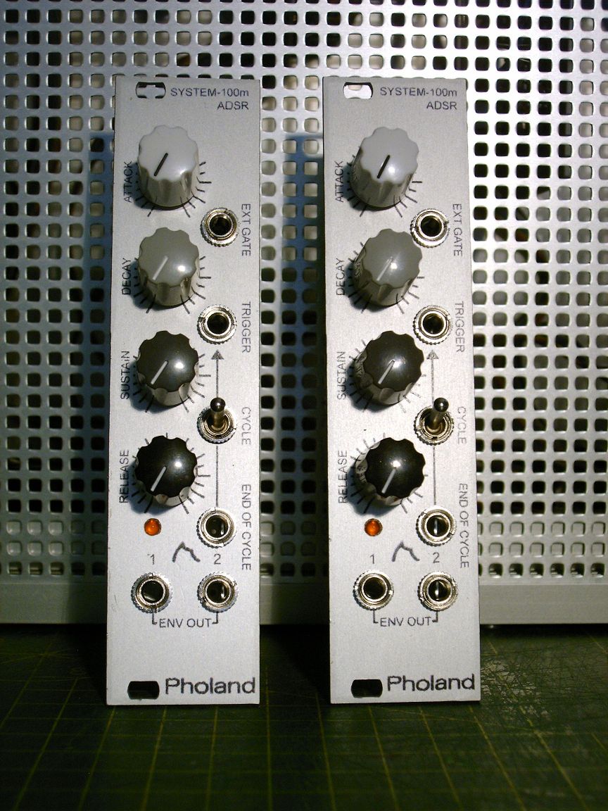

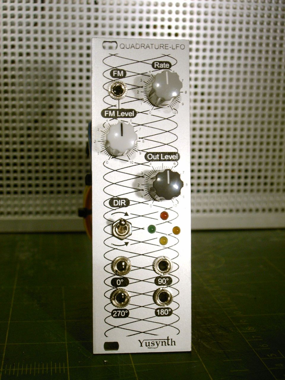

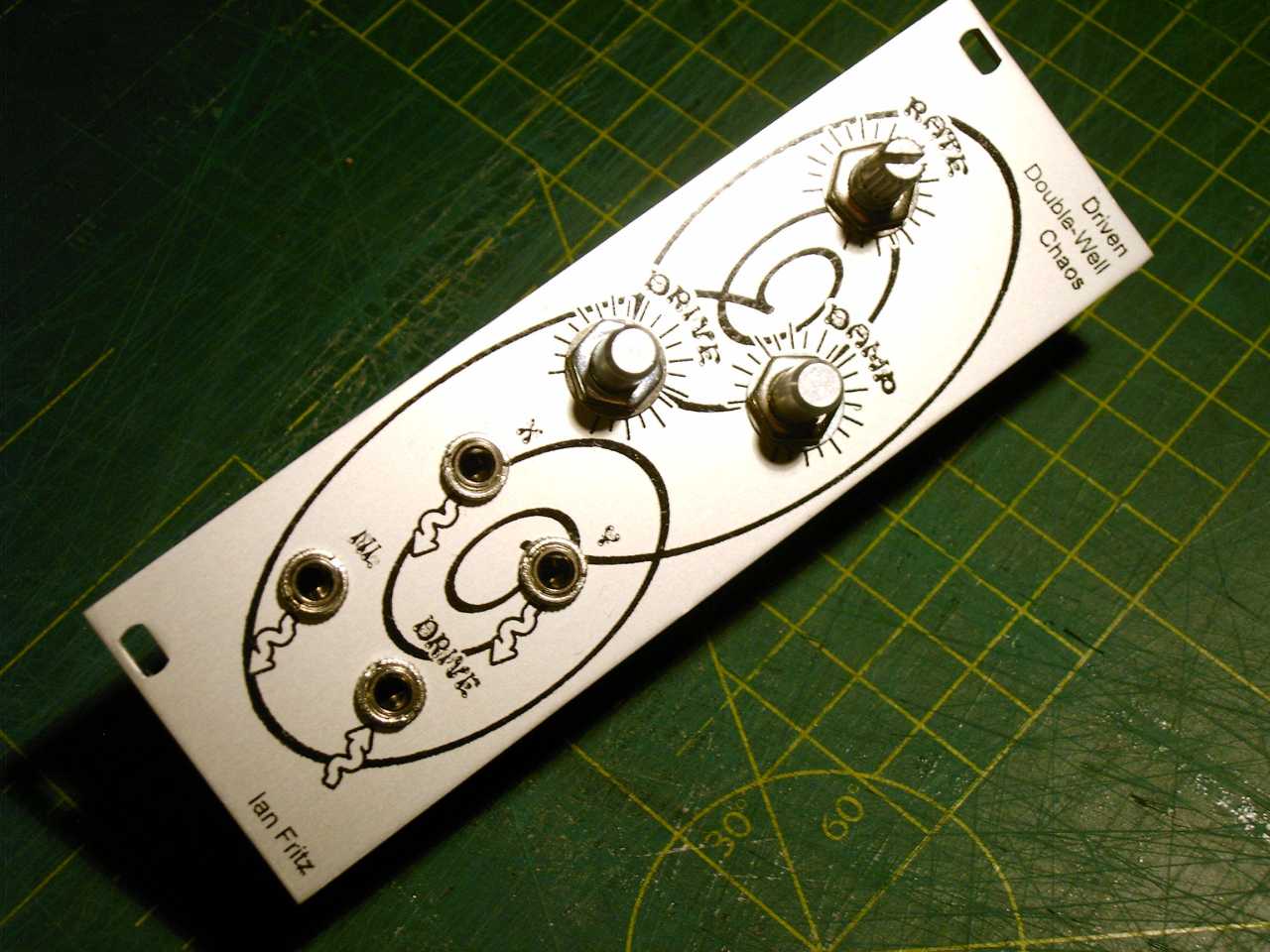

PostPosted: Fri Feb 19, 2016 2:17 pm    Post subject: toner transfer front panels Reply with quote  Mark this post and the followings unread
I had seen some people having nice results with the toner transfer method to make front panels so I gave that a try myself.
I first tried it with some regular paper but that didn't work very well. So next I tried some pages from a couple of different
magazines. I got much better results but the toner didn't take 100% and I also got some of the print of the magazines itself
on it. But what was transferred looked good and was pretty scratch proof.
So I ordered some photopaper to see if that would work any better. What I only relalized after I got it was that it was
made for inktjet printers. It didn't say that it wasn't suitable for laserprinters though so gave it a try anyway.
Well,.. when it came out of my printer it sounded like unwrapping some candy Shocked The print had cracks in it and the
paper had become all bubbly. So that did NOT work. I looked for a bit more info and actually came across some warnings
against using glossy inktjet paper in a laser printer. Apparently the glossy coating can melt and stick to the fuser,
ruining the printer. Luckely that didn't seem to have happened. However there are people who are getting great results
with it even using the exact paper I tried. So you could try it but be warned!
I read up some more about toner transfer method and somewhere someone mentioned getting great results using cheap transfer
paper from china available on ebay. So I ordered some of that (pretty cheap indeed and no shipping costs!). That was all
about a month ago and I had almost given up on receiving the paper when it arrived yesterday Laughing
So I could get back to testing. It came out of my printer looking great, but while cutting it to size I did notice that the
toner didn't stick very well to it. Of course that's exactly what you need to make good transfers but you also have to be
very careful when handeling it. The first tranfer I made looked horrible and much worse than the ones I had made using the
magazine paper. Confused So I gave it another try. Sofar I had been emerging the (very HOT!) aluminium in water after the transfer
to rub of the paper. But the scrap piece I was testing on didn't really fit in my sink so only a small part got emerged this
time. Now, when I pulled of the paper (you don't have to rub this transfer paper of) the part that was emerged looked bad
again but the part that wasn't looked great Very Happy So on the next try I just let it cool of by itself and that seem to do the trick.

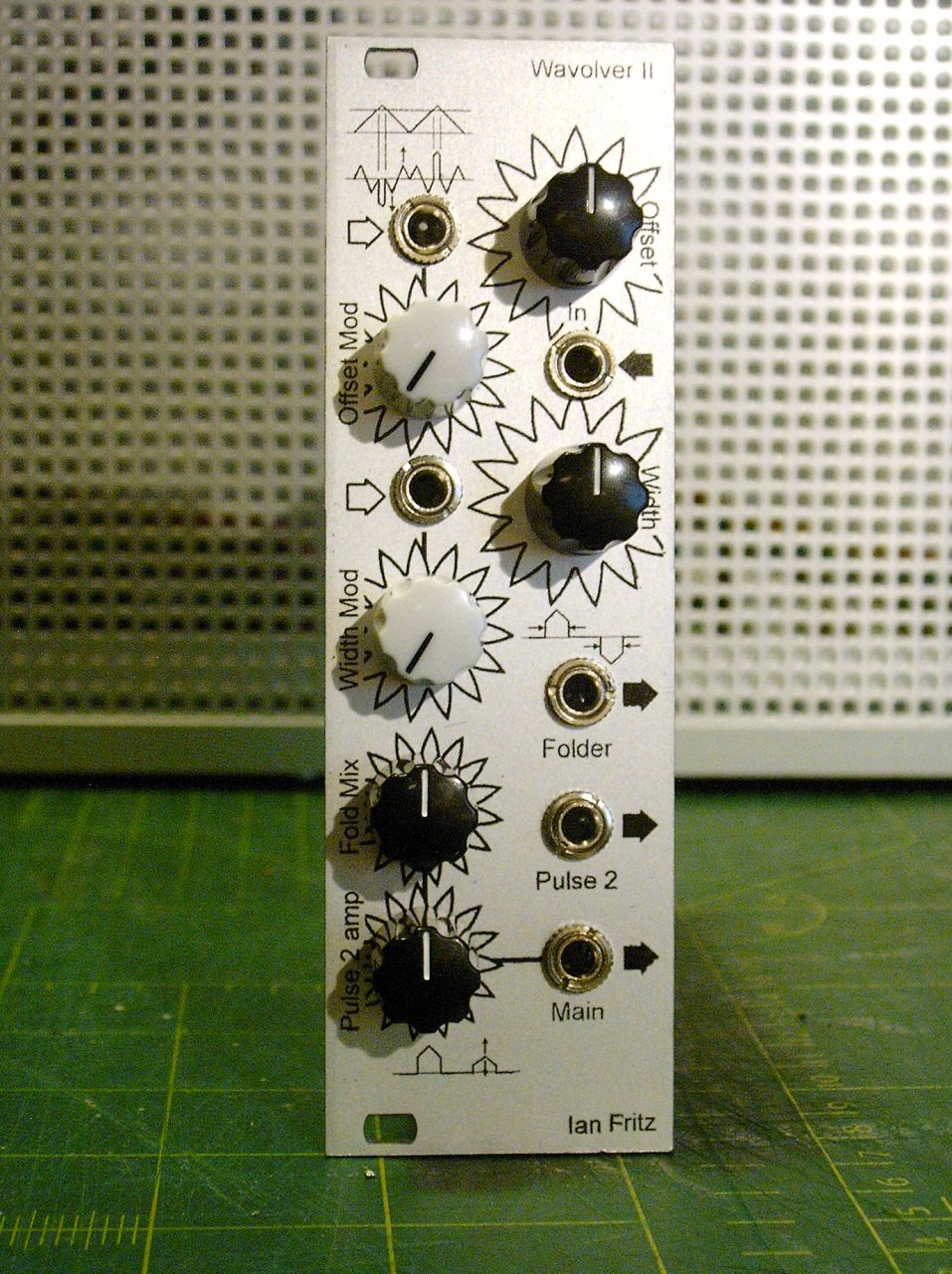

I made 4 panels sofar. the 'Melt Yer face', EZChaos for which I got the PCBs from AlanP and two WaveWipers. I had some trouble
getting the large black area of the WaveWiper panels to tranfer 100% but after a couple of tries it worked. Here are some photos.

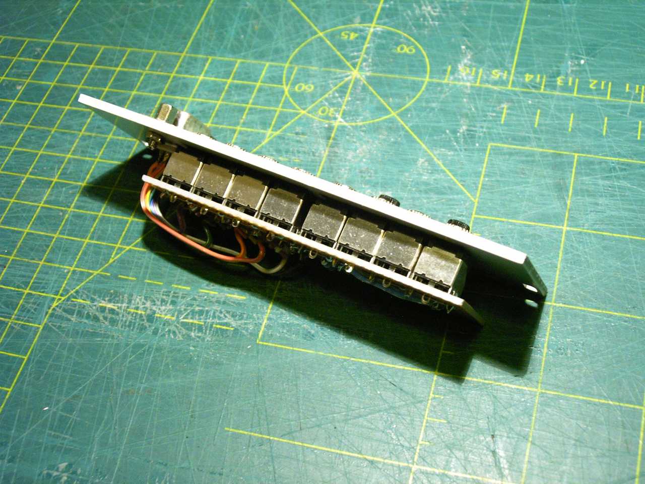

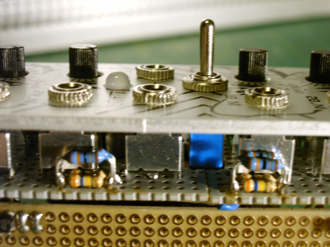

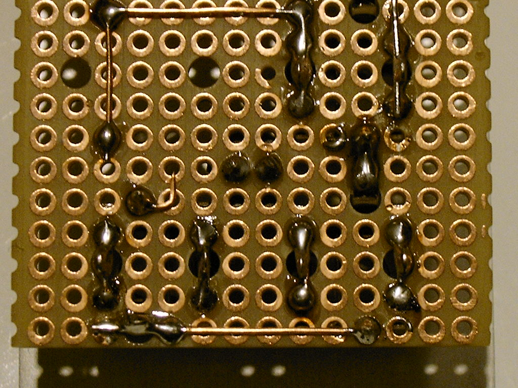

Hi PHOBoS, I have a question. Looking at your MeltYerFace module, I see you mounted jacks with solder lugs on a perfboard. They seem intact so how did you manage to squeeze them through those holes?
Posts: 5881
PostPosted: Wed Mar 09, 2016 4:42 pm    Post subject: Reply with quote  Mark this post and the followings unread
I drill 2.5mm holes for 3 of the pins, the 4th one can just be pushed through.
You can probably use a smaller drill but that's what I have and works.
The holes might be a bit hard to see because of the solder so here is a close
up of another board I am working on. Because the holes remove all the
copper I use some small pieces of wire to secure the pins.

PostPosted: Fri Apr 08, 2016 4:29 pm    Post subject: Melt Yer Face breakout box Reply with quote  Mark this post and the followings unread
I finally got some sockets to built the Melt Yer Face breakout box Very Happy

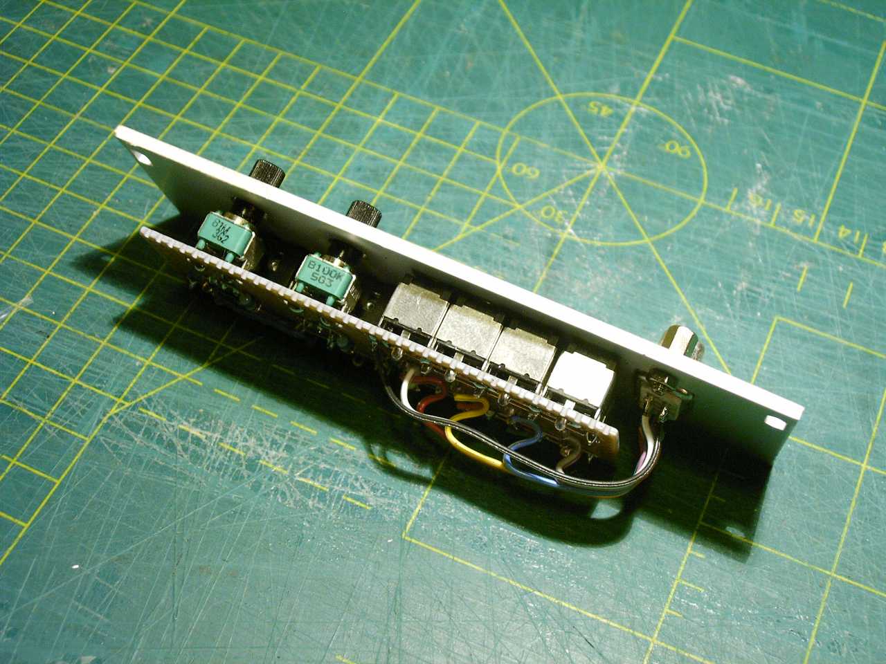

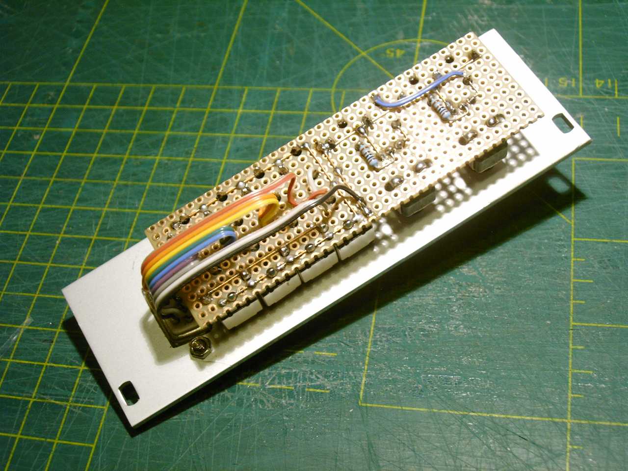

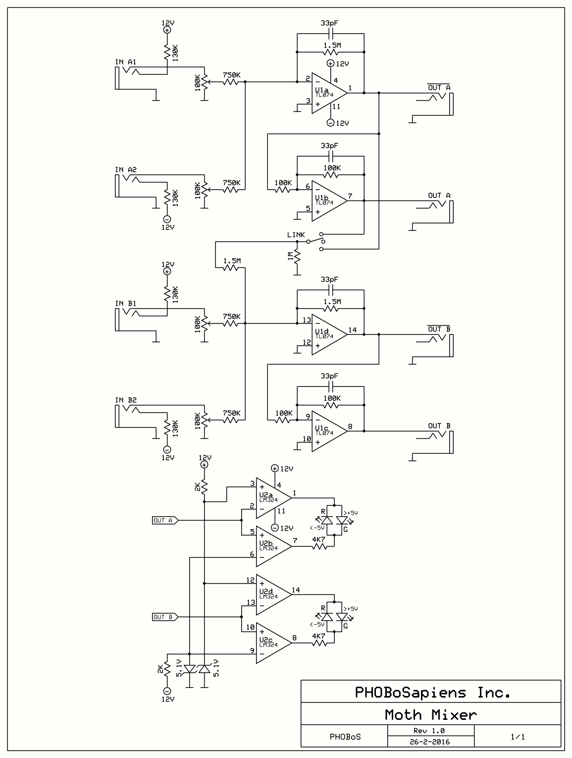

Posts: 5881

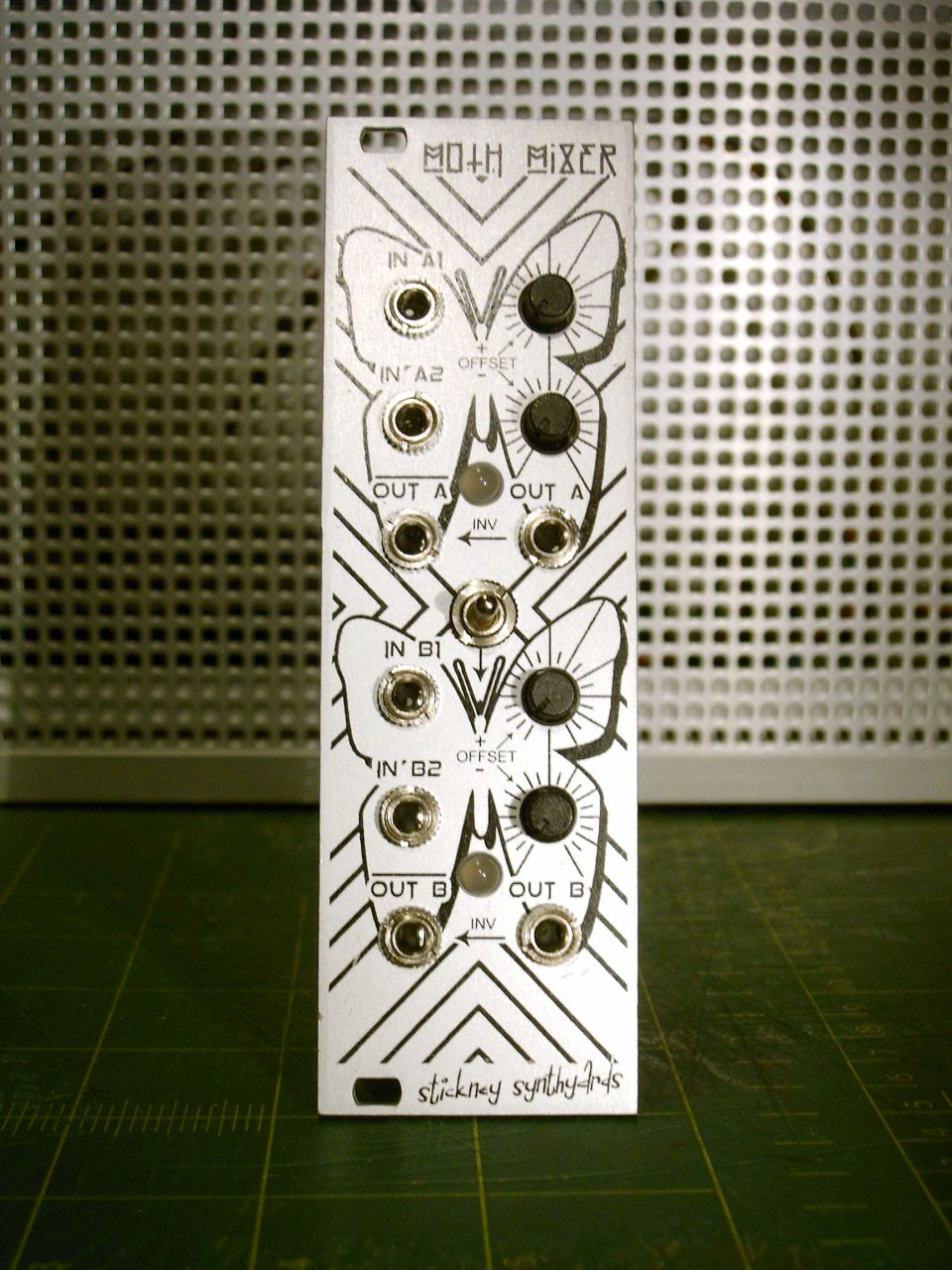

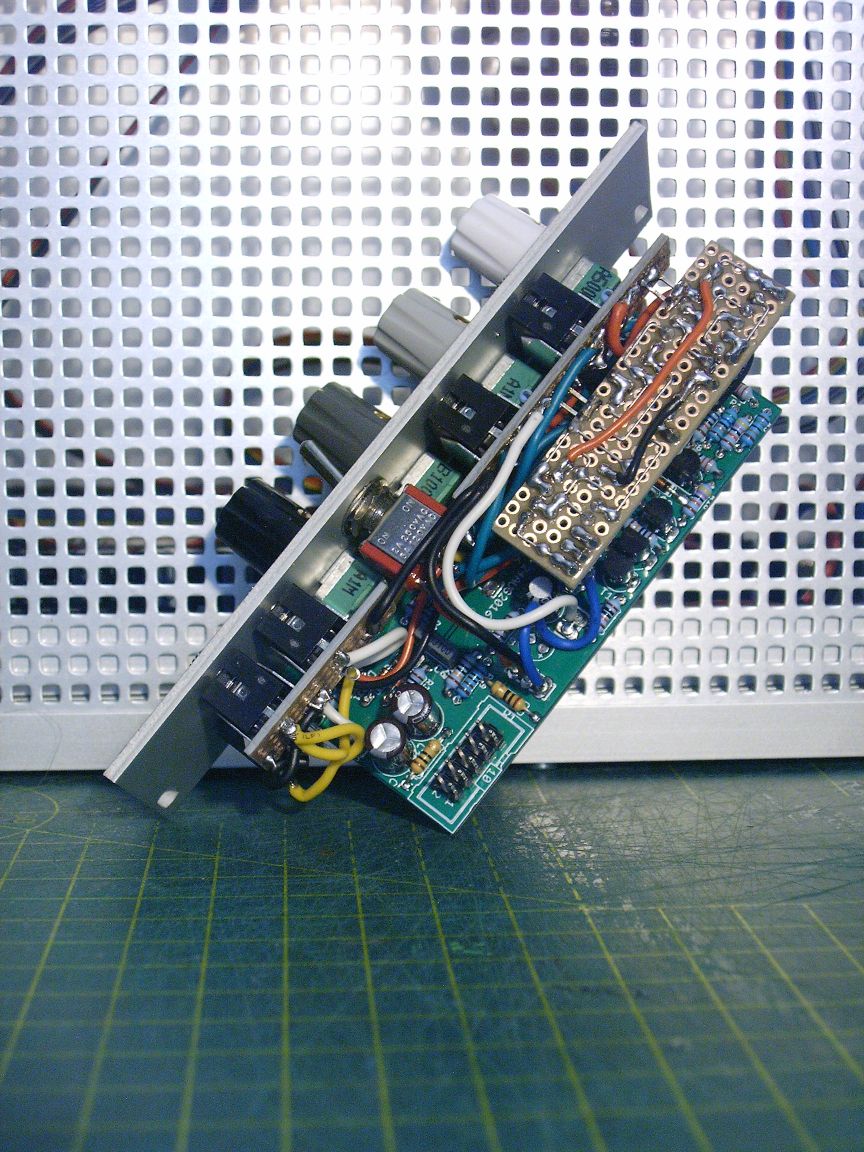

PostPosted: Sun Apr 10, 2016 1:29 pm    Post subject: Moth Mixer module Reply with quote  Mark this post and the followings unread
I also got some pots so I can finish some modules. Here is the first one, the Moth Mixer. (yes those are butterflies on the panel)
I wanted a simple mixer but I added some extra features. With the resistors wired to the switch contacts of the input sockets an offset
voltage can be added when nothing is plugged in, +10V with the pots connected to A1/B1 and -10V with the pots connected to A2/B2.
Besides using it as an offset control it could also be used to create a DC voltage. Both mixers have an inverted output and there is a
switch to link one of the outputs of mixer A to mixer B creating a 4 input mixer. I also added some indicators that light up if the output
voltage is lower than -5V (red) or higher than +5V (green).
I made one mistake. When I drew the PCB layout I somehow labeled the 130K resistors as 360K Confused so that's also what I
soldered on the PCB. They are located in a spot where I couldn't replace them but I managed to solder some resistors in
parallel to bring them down to the correct value.
 Filesize:  35.4 KB
 Viewed:  672 Time(s)
 Filesize:  200.23 KB
 Viewed:  615 Time(s)
 Filesize:  227.75 KB
 Viewed:  567 Time(s)
 Filesize:  159.57 KB
 Viewed:  577 Time(s)

And another one finished: the Yusynth Quadrature VC-LFO.
It didn't go a slow as I wanted it to be so I replaced the 10nF caps with 100nF ones.
After I had done that I wondered what the trimpot was for. doh So now it can go
very slooooooooooooooooooooooooooooow.
I should get some new sharp drillbits so holes will actually be where I want them.

And the last one for now: The Wavolver II (with an extra Pulse 2 output).

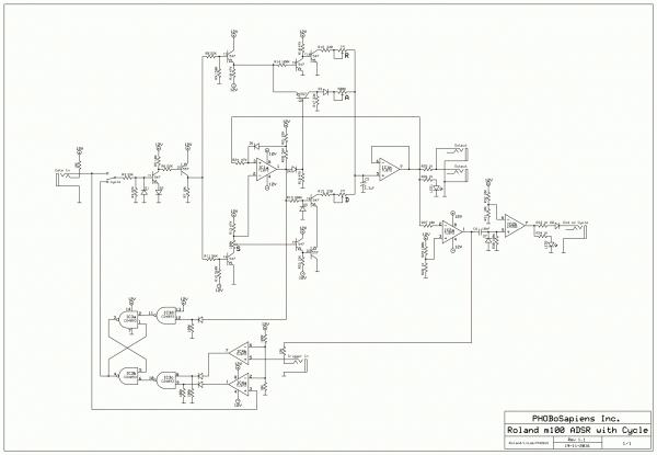

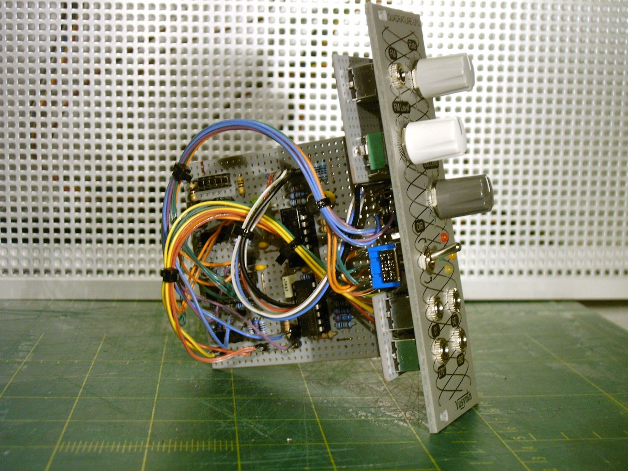

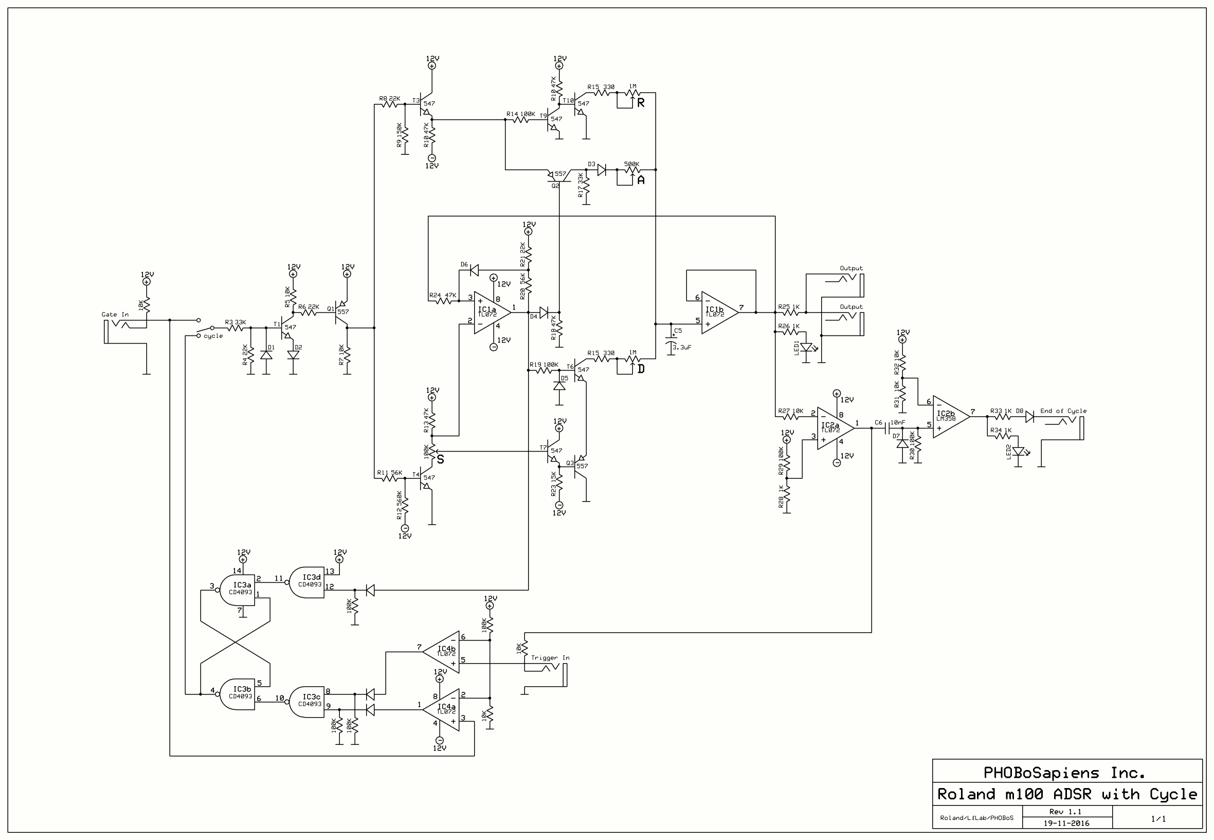

PostPosted: Sun Nov 20, 2016 6:55 am    Post subject: Roland 100m ADSR with cycle mode Reply with quote  Mark this post and the followings unread
I finished 2 Roland 100m ADSR modules with PCBs from LFLab who added an End of Cycle output to the design. I was immediately curious if it
would be possible to use this output to turn the ADSR into an LFO by connecting this output to the GATE input. I tested it but it didn't work.
So I took a closer look at it and noticed 2 problems. First of all the E.o.C. output is a pulse output and as a result it is usually low. So if you would
connect it to the GATE input it would never trigger the ADSR unless you jumpstart it. Using the output of comparator IC2a instead solves this
problem but there is a second problem. As soon as the ADSR starts its cycle and the output voltages rises the output from this comparator
becomes low and as a result the ADSR immediately goes into Release. So even if it cycles it would be at a fairly high frequency and the output
amplitude would be very low.
To solve this I added a Flip-Flop made with NAND gates. So when the ouput of Comparator IC2a goes low the ouput of the Flip-Flop stays
high preventing the ADSR from going into Release. Of course without resetting the Flip-Flop it would get stuck at Sustain because the GATE
input is still high. Luckely the ADSR already has another comparator that changes state at the end of Attack and I used this to reset the Flip-Flop.
So now it cycles between Attack and Release (it skips Decay and Sustain)
Initially I was only using NAND gates IC3c and IC3d as inverters because the Flip-Flop triggers on a high to low transition. But NAND gates have
2 inputs and because the GATE input isn't connected to the ADSR in cycle mode I can use it to enable/disable the Flip-Flop turning it into a gated
LFO. By adding a resistor btween V+ and the switch connection on the GATE input it will still cycle when nothing is connected. This does have
another effect though which I guess is a bonus feature. In normal ADSR mode when nothing is connected to the GATE input it will get stuck in
Sustain, which means you can set a DC output voltage with the Sustain control. I also added another input between the output of the IC2a
comparator and the input of the Flip-Flop that functions as a trigger input.
This all worked fine but there was one minor issue. The NAND gates need a fairly high voltage to trigger, so using +5V which is pretty standard
for gate outputs wouldn't work. To solve this I added 2 more comparators to the inputs of NAND gate IC3c.
 Filesize:  195.62 KB
 Viewed:  649 Time(s)
 Filesize:  224.39 KB
 Viewed:  628 Time(s)
 Filesize:  88.78 KB
 Viewed:  726 Time(s)
