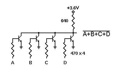

I love blinky LED's, don't you? We add them to our circuits in abundance just for the fun of seeing them light and dim according to the signals in our music circuits. Now, given that fact, wouldn't it be really cool if circuits could be made of LEDs? Well they can!
For the longest time, years and years it's been, I have wanted to make logic circuits for Lunettas and other designs using LEDS for outputs and CdS cells for inputs. This would be optical logic so it would matter how you oriented the I/O connections and watch out for light crosstalk (maybe an enhancement too). I'm already losing you so let me show you a picture worth a thousand words, attached.
If we take those inputs, hook them up to the supply voltage and replace them with CdS cells, then the incident light would turn the transistors on and off. Adding an LED in series with the output resistor should give our logic gate optical output which can be physically directed at the input of another optical logic gate.
That's the plan at least. I'm going to do a little testing now and hopefully I can get something working, then I will return with a report on the results.

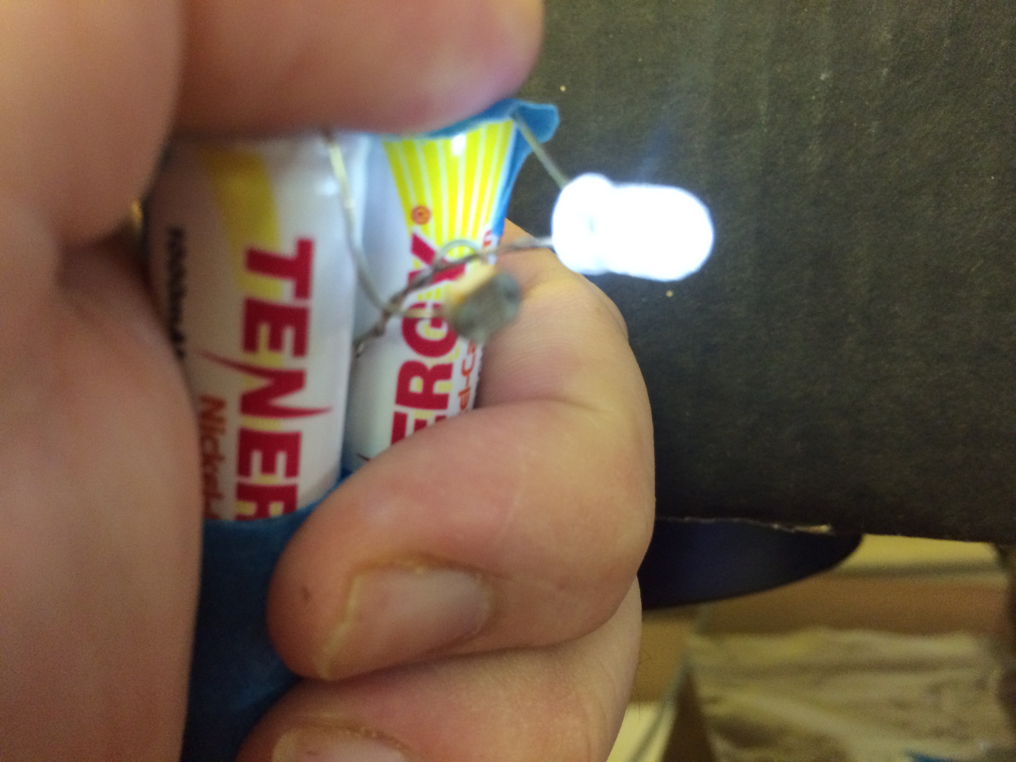

OK, I did a simple test for starters. I wanted to find out if the component values I chose (10k Ohm CdS cell and white LED) would light up properly in room lighting.
I found on the web that the recommended voltage drop for a white LED is 3.3V, any less than that and some of the white LEDs may not light. Well I happen to have four rechargeable NiCd batteries so I figured three or four of them connected in series would suffice as a power supply.
So I taped them up with blue painter's tape that I have from 3D printing and took one CdS cell and one LED, connected them in series at the positive terminal of the LED (CdS cells are non-polarized), and taped them to the battery ends.
Due to the awkwardness of the connection technique, I had intermittent contact but sure enough the LED lights bright and strong! Then I covered up the CdS cell and the LED glowed dimmer than with it fully lit by room lighting and also from some light from the LED itself. So yeah I know that four NiCd cells act as a good power supply for this project, plus we also know that the LED lights brightly under these conditions and can be made to dim.
That's all fine and dandy, but have I created a propagating circuit? No! For example it would be great to make a logic gate from this arrangement. What would happen if we added another CdS cell in series or in parallel with the first one?
This would create a multiple input circuit with logic-ish configuration but would it operate like a logic gate? The answer is no and I'll tell you why - it's because it attenuates with each stage in propagation. To get a strong signal we need to use a transistor.
Once we add an NPN or PNP transistor, there are a few configurations that will work as a propagating, inverting logic gate. So now I'm off to figure out how to set up such a thing. I'll be back to report soon.
