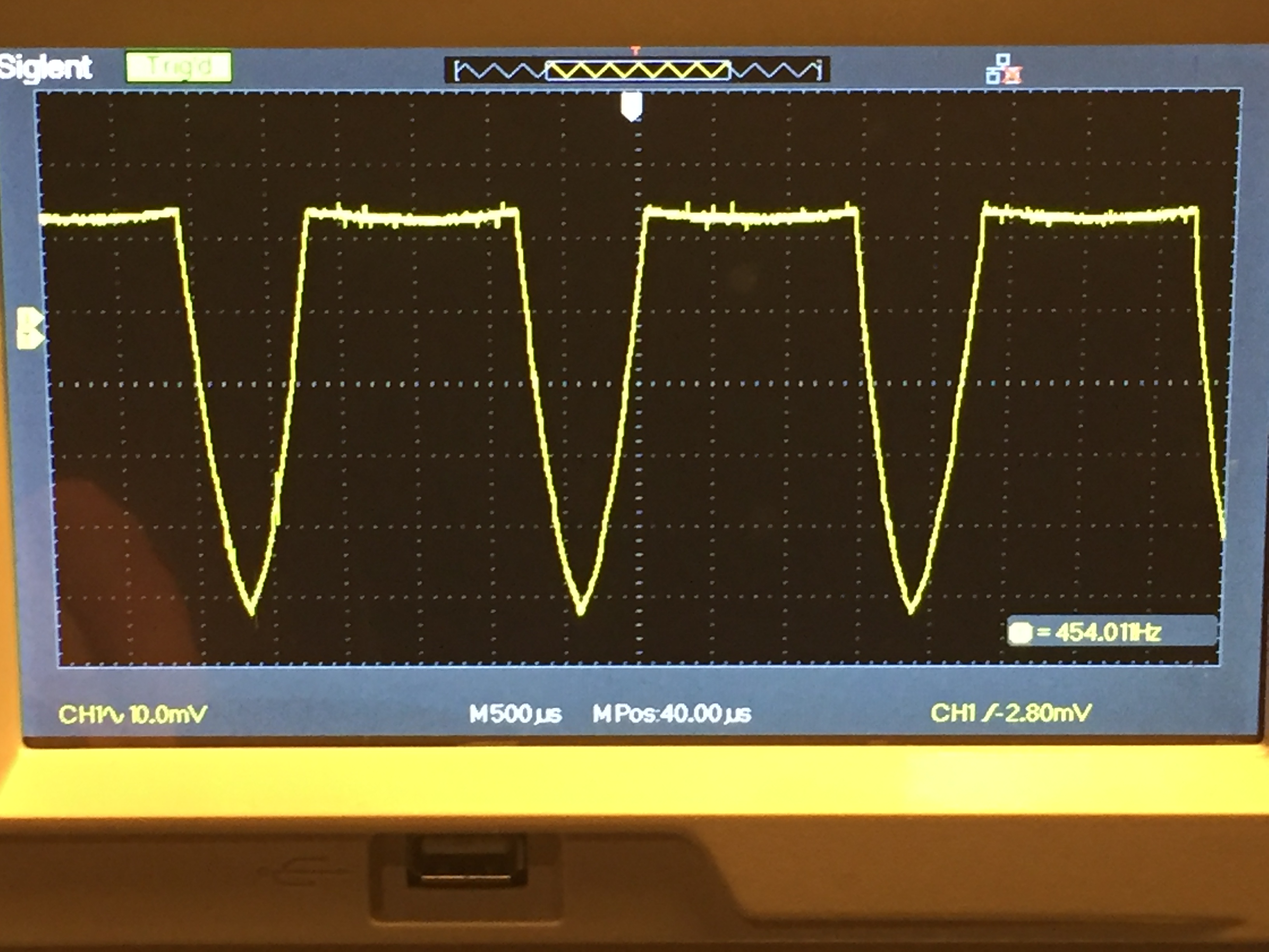

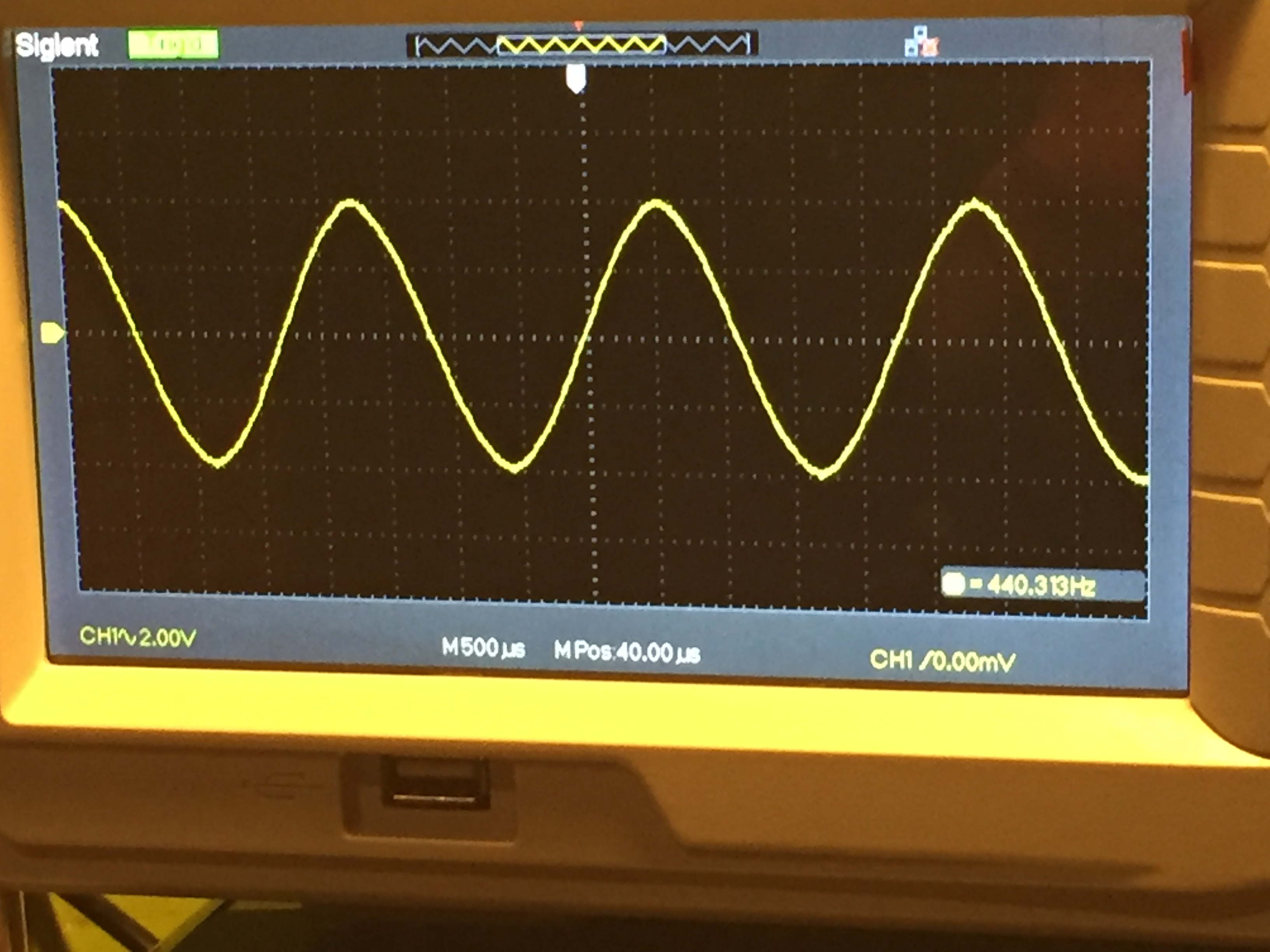

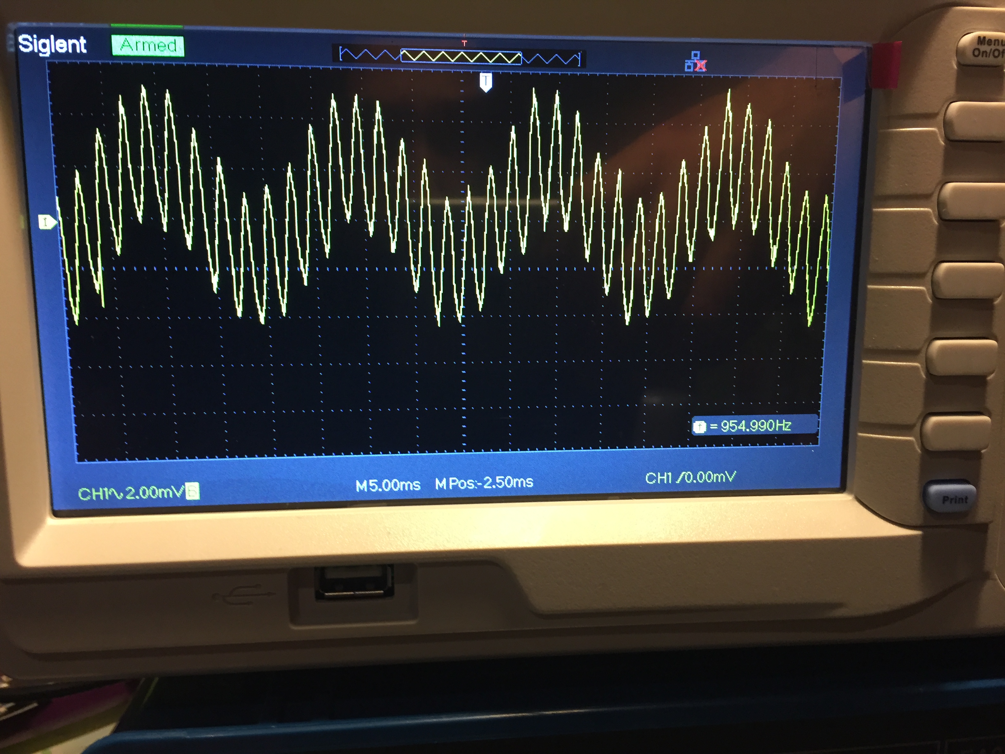

Hi everybody, i've just joined this forum after my first endeavours into the wonderful wold of DIY modular synthesisers. I have successfully built my first module, a Yusynth VCO, and I am now looking for some insight into a problem I'm having with the VCF; I just can't get the damned thing to work. Not getting any sound at all.
Ive checked all the components and my soldering. Im getting a signal out of the TL072 amp, but I cant seem to find anything worth noting in the ladder.
Ive replaced all the silicon apart from the transistors in the ladder, so I can be fairly sure its not a chip that has gone. Ill attach some pictures of my build. Any help would be very much appreciated!

Signal going into the VCF:

Signal at pin 4 of U1:

Can you point me to a schematic?
also, IMG_1665.JPG does not have a description, what signal is it?

PostPosted: Wed Dec 14, 2016 3:03 pm    Post subject: Reply with quote  Mark this post and the followings unread
Thanks for the welcome!!
That picture is the signal at the collector of the 1st transistor in the ladder. All of the info for the build can be found here:

PostPosted: Wed Dec 14, 2016 3:16 pm    Post subject: Reply with quote  Mark this post and the followings unread
IMG_1664.JPG shows clipping, which should not happen .. what does U3b pin 7 look like?

PostPosted: Wed Dec 14, 2016 3:28 pm    Post subject: Reply with quote  Mark this post and the followings unread
Pin 7 of U3 is identical to that picture. The 120K resistor in series with the input signal is trimming the top off

PostPosted: Wed Dec 14, 2016 3:51 pm    Post subject: Reply with quote  Mark this post and the followings unread
The amplitude of the signal at U3 pin 7 should be much greater than at U1 pin 4, about 4V peak to peak based on your input picture.
It shouldn't be.
Measure the input with the scope in DC mode, not AC, and make sure that the signal is centered around ground.
