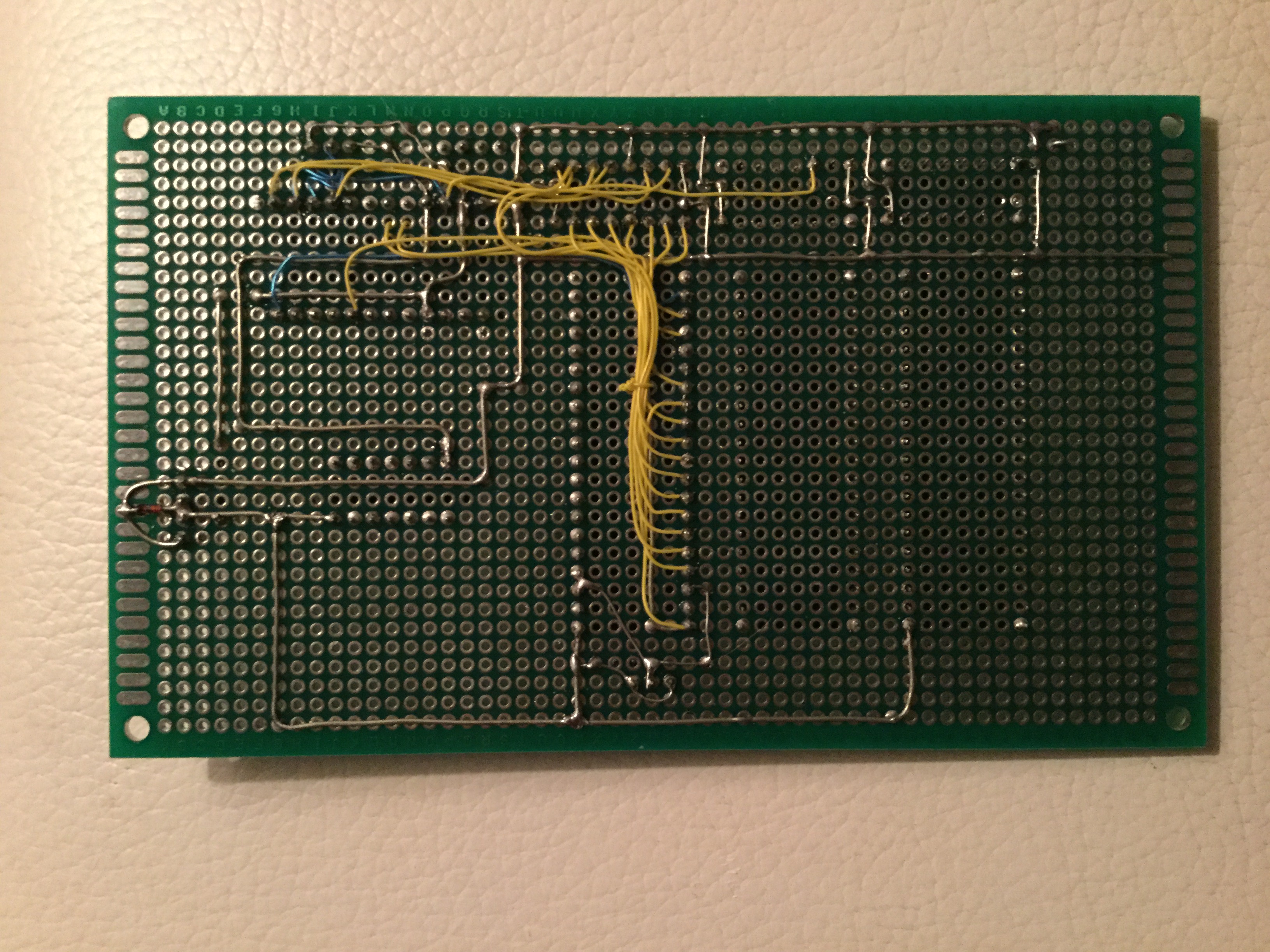

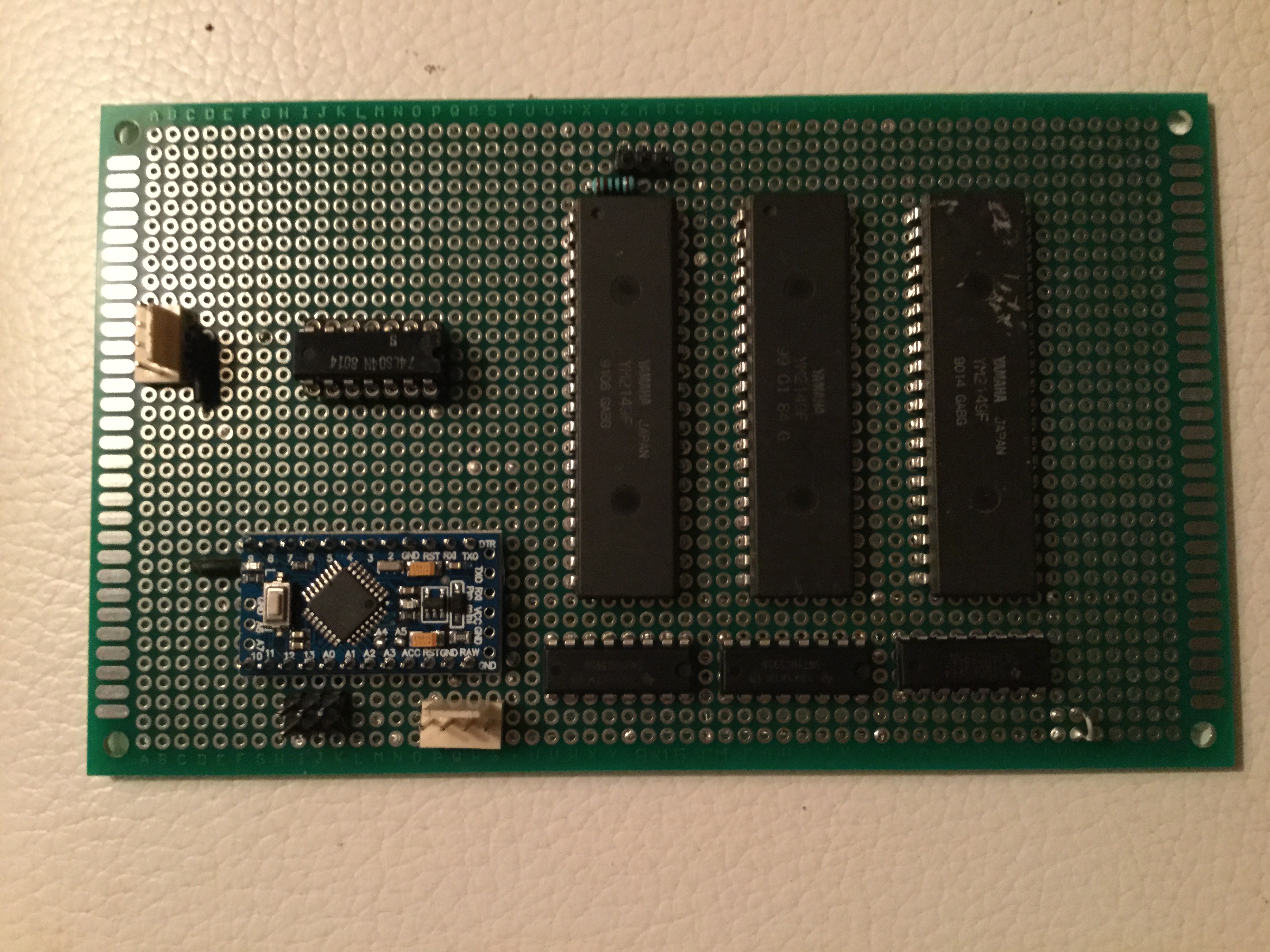

PostPosted: Sun Nov 13, 2016 1:47 am    Post subject: Reply with quote  Mark this post and the followings unread
to show that I'm still working on this idea...
One music generator (YM2149) wired, time to start coding to see if I can get it to work.
After that: three more generators to wire...
 Filesize:  1.63 MB
 Viewed:  583 Time(s)
 Filesize:  1.74 MB
 Viewed:  589 Time(s)

PostPosted: Sun Nov 13, 2016 8:55 am    Post subject: Reply with quote  Mark this post and the followings unread
You do really neat work grumble!

Posts: 1313
PostPosted: Fri Dec 30, 2016 8:39 am    Post subject: Reply with quote  Mark this post and the followings unread
I quit with the approach to this project.
The three psg's are working, but there is only one envelope per chip (= three voices) so it is not going to work.
But I don't give up, so I've ordered some new chips being some YMF262, which is an FM Operator chip and see what I can do with this type of psg.
