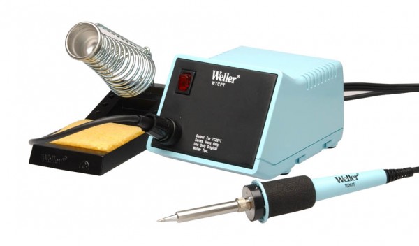

PostPosted: Sun Jan 22, 2017 1:07 am    Post subject: Reply with quote  Mark this post and the followings unread
I have this one, it temp is controlled by the type of tip I place in the holder.
Usually a 7, thats 370 C

Posts: 1310
PostPosted: Mon Jan 23, 2017 2:29 pm    Post subject: Reply with quote  Mark this post and the followings unread
alanwilder81 wrote:
isnt'it the principle that regulates the fancy and expensive temperature controlled irons ? just a wild guess,i wait for advice Smile Smile
thanks
No, the tips I,m using will loose its magnetic strength once the temp is reached. This is called a magnastat.
http://codeandlife.com/2012/03/06/weller-magnastat-autopsy-and-repair/

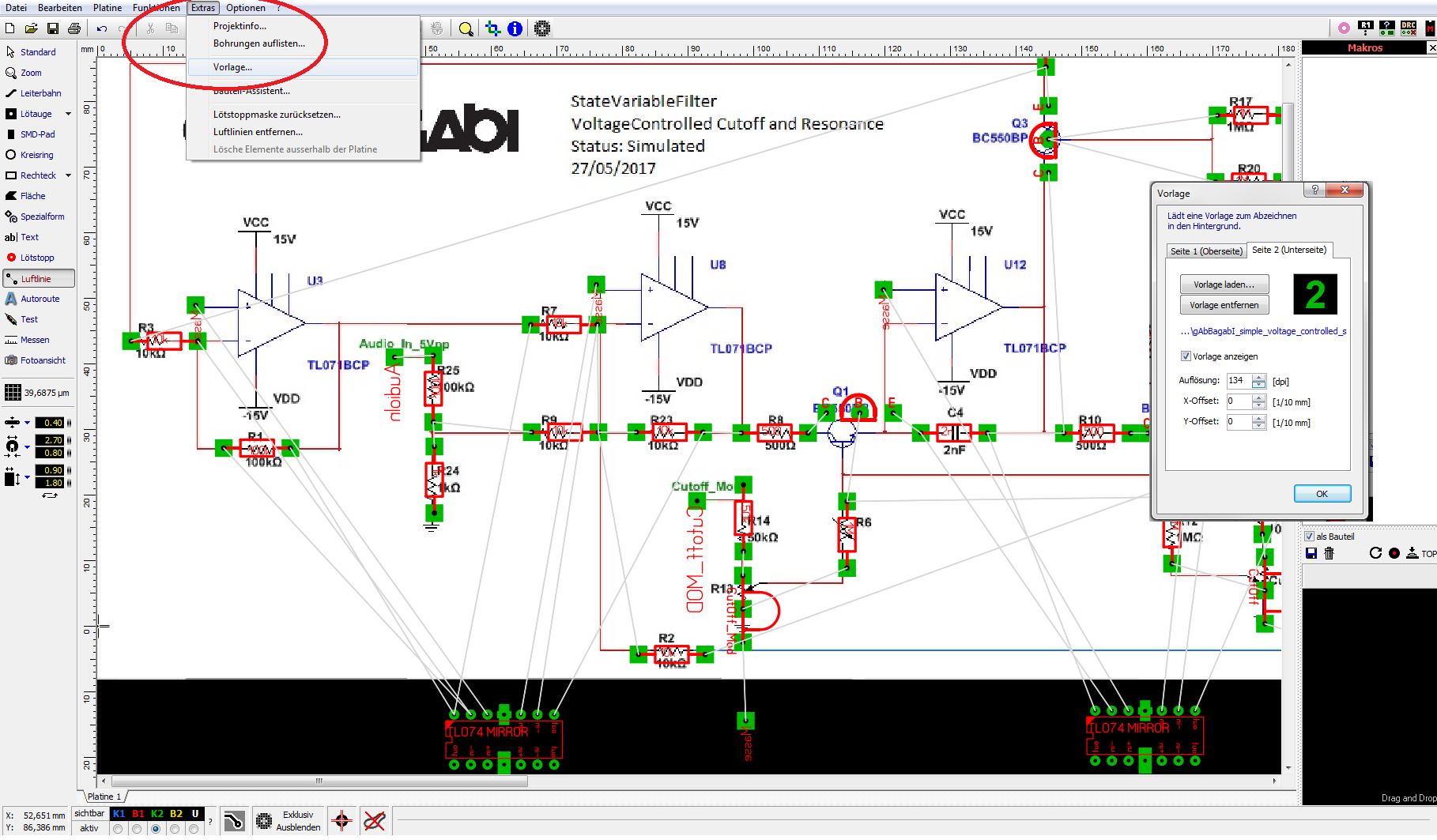

PostPosted: Sun May 28, 2017 5:19 am    Post subject: Reply with quote  Mark this post and the followings unread
Regarding Sprint layout schematic capture
first: thanks again to phobos for reminding me on "sprint-layout", ive forgot about it cos i found it not usefull back in the days. Only now i can appreciate the usefullness and the freedom it gives you.
I bought the 6.0 (german) version.
there you find under "extras" a menue point that is called "Vorlage" (in english it should be something like "template" ), there you can load a (schematic)Picture.
then you can just put your components on top of the pic, conect them with air-wires. Use the dpi value to adjust the dimensions.
Then just discard the pic and the fun can beginn!
