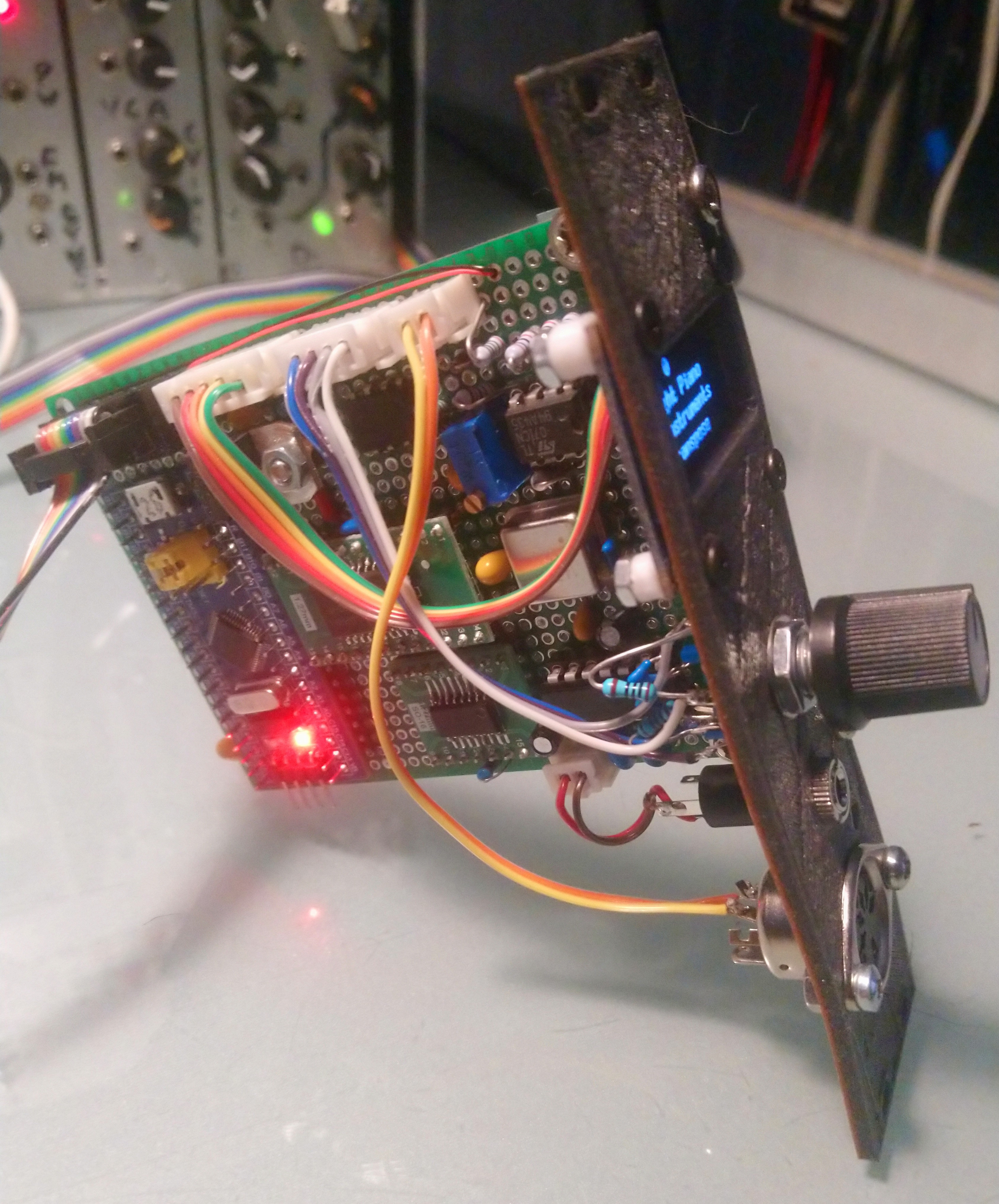

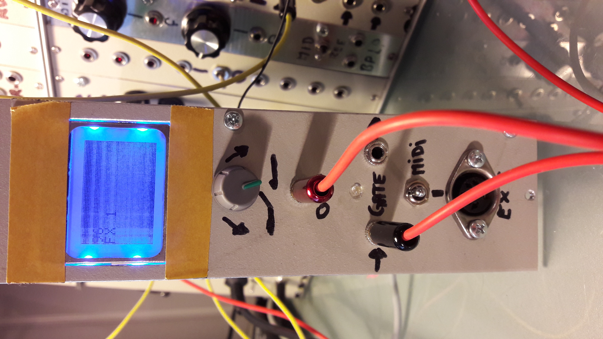

I'm working on an OPL3 player module.
Started ordering a few YMF262 Yamaha FM chips, which have been used in a lot of synthesizers in the 80ties. Along with these YMF262 I ordered some DAC chips YAC512.
The module is far from ready, but the basics work, I can select from 128 instruments and have them played frm the internal midi and gate.
Todo is to have the ext. midi to work so I can play from a polyphone keyboard or ext. sequencer.
Also I want to be able to change the instrument parameters so I can fiddle around with the sound of the instruments.
Here a link to my OPL3 player:
https://youtu.be/-WvVVEAcwWw

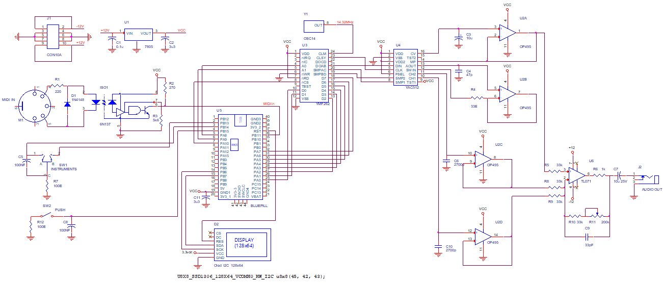

Have been playing around with this new module. As for the hardware it's nearly finished, but the software is another story Rolling Eyes
Originally I put a MCP6044 quad opamp in this module, but it sounded terribly.
I didn't realized that an opamp could make such a difference in a simple circuit like the output circuit of this module.
So I made an audio file with three opamps: first the TLC274, the MCP6044 and last one the MCP6284.
The MCP6044 (that's the most "expensive" of the three 1.75€) is the worst qua sound, while the MCP6284 (the cheapest, 1,39€) sounds the best to me...
Also I am asked for the diagram of this module, so I added it as well.

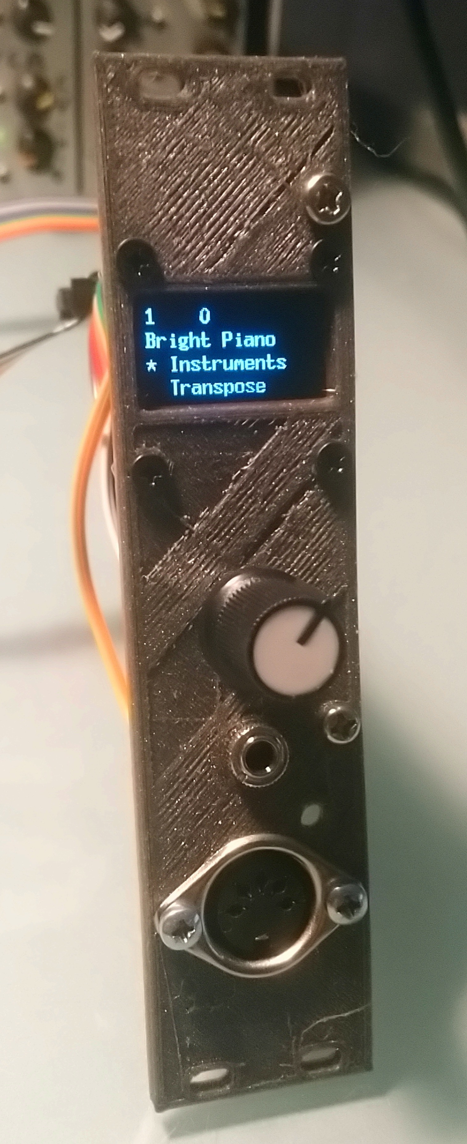

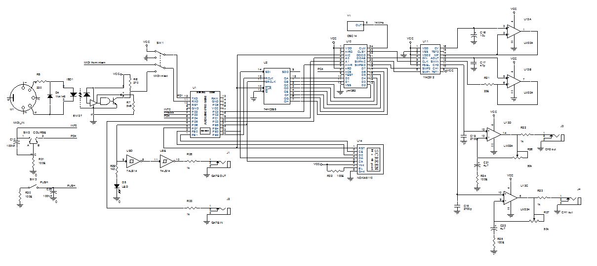

PostPosted: Sat Dec 05, 2020 5:49 am    Post subject: Reply with quote  Mark this post and the followings unread
Second iteration, this time I used a Stm32 Blue Pill.
edit: corrected an omission in the Schematic

PostPosted: Wed Apr 14, 2021 12:37 am    Post subject: Reply with quote  Mark this post and the followings unread
Small changes made.
Now the clock frequency for the YMF262 is generated by the BluePill.
