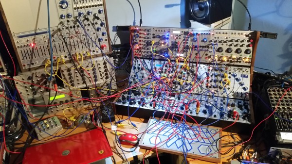

Building a Buchla system
Buchla modules are extremely expensive. A system of reasonable size has the same price tag as a new small car.
I have built a system lately, and here are my experiences of lowering the costs:
One way is to use modules from Eurorack or Moog i conjunction with the Buchla, there is a separate post on that topic.
In my 27 space Buchla modular, only one is a brand new Buchla module. Most of it is 2nd hand, and there is also some clones built by Roman and Mark Verbos.
Ebay has 2nd hand modules for sale. Cheaper than new, even though the prices are fairly high. I have also bought from friends that change modules in their system.
On the same time, the price level of 2nd hand modules i stable. If you buy one, you can sell it for the same price.
The clones are normally cheaper than the original, but the price has been high due to the fact that BEMI have difficulties to deliver new modules to the market.
There are several Eurorack modules that copies Buchla modules. Doepfer has made copies of both the LPG and the SoU. They are pretty good but can not be compared to the original units.
Mark Verbos, who make Buchla clones has a series of Eurorack modules inspired by the Buchla design. I have not used them, but I guess they are good, according to how good his clones are.
On big difference is still the depth av versatility of the Buchla modules. For example, the 291e Triple Morphing filter can be used as a three to one voltage controlled mixer, a triple amplitude and frequency modulation unit, a formant filter, an EQ, a sequencing filter pattern module, a 3 x VCA and probably more than that.
Another aspect of the Buchla project is what modules that are essential,.
The sound of the Buchla is its VCO and the sound of the vactrols in the low pass gate.
The Source of Uncertainty may be seen as an expensive S/H, but it is not. The note patterns and interval that it produces is definitely an essential part of the Buchla sound and the Buchla experience.
The normal start kit is a four unit boat with a Complex Waveform Generator, a Quad Dynamics Manager, a Quad Function Generator (Envelope generators or LFOs) and a Midi Control module.
Another side of building a system is the amount 0f analog mist that the VCOs produce. With a few Buchla Complex Waveform Generators, it is quite possible to fill the whole soundscape. The Buchla System 7, a 24-boat monster with a price of USD 30 000 has only four VCOs.
I have eight VCOs i my Buchla, and it is almost impossible to put hem all in work because of the analog mist effect. I should sell one or two, but they are different and I like them all.
And so the warning. It can become a habit.
I started with three 2nd hand modules and no boat.
I now have a 29-boat that has 27 places filled, and is planning the next expansion.
It has cost me a great deal of the money I had saved for my retirement.
But I rather be poor but having a great time with great gear, than unable to have a great time, lacking great gear,
Per Wikstrom
The Buchla. To the left is a 2 x 4 Buchla boat (or rack) with a Roman-buildt Easel clone, and a Verbos Frequency Oscillator clone.

Wow, it looks like you have built great Buchla system there Per Exclamation

Thank you. Today an Pendulum /Ratchet arrived so now the rack is full. I worked with G2 and Eurorack for several years but one day it became boring. I knew it too well. This source in this destination, I knew it befor connecting. It was no adventure and no exploration anymore. With Buchla I am back int the frontier territory again.
