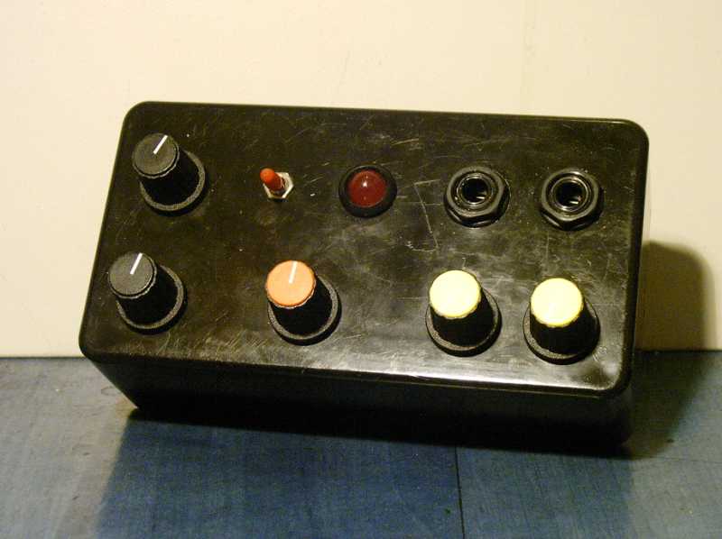

Recently egasimus asked how to make a common detune control for
multiple 40106 oscillators
. One obvious thing that came to mind was
using vactrols. Of course the oscillators won't detune exactly the same
which can be very useful for creating droney sounds.
My initial idea was to take a PWM controlled 10mm LED and place 6 LDR's
around them controlling 6 oscillators (40106). I did some experiments and
eventually ended up with using only 2 vactrol controlled (or is that vactrolled ?!)
oscillators.
So here's the first circuit: "3240106 Droner"
- It has 2 oscillators to set a base drone one of which is slowly and slighty
modulated by a triangle wave provided by a third oscillator.
- Then there are the 2 vactrolled oscillators. The vactrols are driven by
a PWM controller which in turn is also modulated by a triangle wave.
Modulation depth and speed can be adjusted. The 100k trimpot is to set
the offset to get a nice vactrol responce. I made mine from a ordinary
5mm red LED, a LDR and a piece of heat-shrink tubing.
- The oscillators are passively mixed together using resistors and I added
a small cap to make the sound less harsh.
The enclosure is probably temporary as I'm planning to build a couple of
drone ciruits and put them together in a box with a mixer, delay, filter and
what else might be useful to create some nice drones (tips are welcome!)
I'm thinking of adding a cheap circuit bent keyboard aswell.
here's the schematic, a photo and some demos:

Posts: 5939
PostPosted: Wed Jun 15, 2011 8:48 am    Post subject: XOR Stereo Droner Reply with quote  Mark this post and the followings unread
For the second droner I experimented with a XOR ringmod, which resulted
in the following circuit: "XOR Stereo Droner"
- as with the previous circuit this one also has 2 oscillators to set a base
drone, but this time both are slowly and slighty modulated by a triangle
wave. The outputs are attached to an XOR. What I didnt know before is
that if you add an LED to the output it will fade in and out in sync with the
frequency shifting produced by the 2 oscillators. So this is also very
usefull to use in future drone circuits as an indicator.
- I used this fading effect to modulate a third oscillator which is also XOR'd (?)
with the other 2 oscillators.
- with so many outputs and a spare inverter I decided to make a stereo
version. Mixing is done in the same way as the previous circuit but I did
use different resistor values for the XOR outputs and the direct oscillator
outputs.

PostPosted: Thu Aug 17, 2017 6:01 pm    Post subject: Reply with quote  Mark this post and the followings unread
Hey hey,
First post here, lurking in the shadows since a while though Smile
Just wanted to share my build of one of the Phobos droner design (thanks for the schematics !)
I took the 3240106 Droner and added the filter section of the Casper Electronics Drone Labs (low pass into distortion into 2x resonant band pass filters, with audio input)
Nice textures are going out of this thing !
Here a sound example, with just a delay added, feedbacking into the audio input: https://soundcloud.com/user-624222268/otoro-drone-02
And a pic of the thing (etching of the panel in process)
So, thanks again Phobos, and Casper, for the inspiration, much apreciated Smile

Posts: 5939
PostPosted: Sat Aug 19, 2017 10:30 am    Post subject: Reply with quote  Mark this post and the followings unread
Now that I looked at the circuit again I think you could replace the 100K mix resistors with different values which would
result in a waveform with more steps. You could go a step further and replace them with potentiometers. A simple output
buffer might not be a bad idea either.
