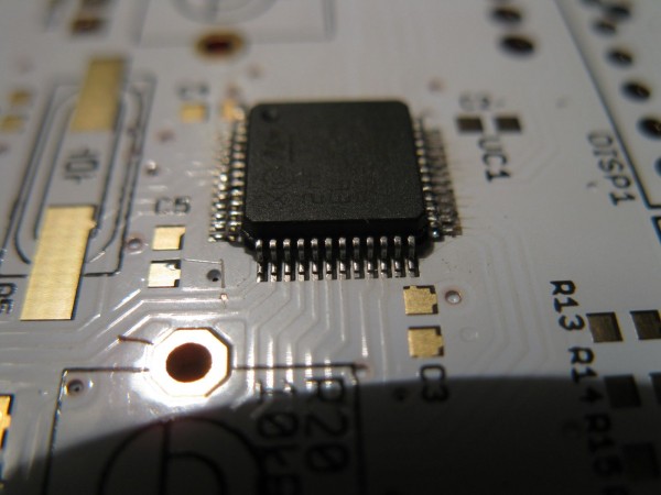

There are 2 things about the The Braids PCB that are a challenge for me, first of all the very small parts
but also the firmware flashing which I am actually more worried about. But let's focus on the SMD
parts for now. I don't have any experience with soldering them except for some 100nF capacitors which
where slightly larger in size. So to prevent screwing up the braids PCB I ordered some practise kits.
The first 2 practise kits I got have a bunch of 1206, 0805, 0603 resistors, some cylindrical 1206 diodes,
SOT-23 transistors and a SOP16 chip. There is also a space for a SSOP28 chip but that one is not included.
The resistors and diodes are wired in series with an LED and there are 2 solder pads for power so you can

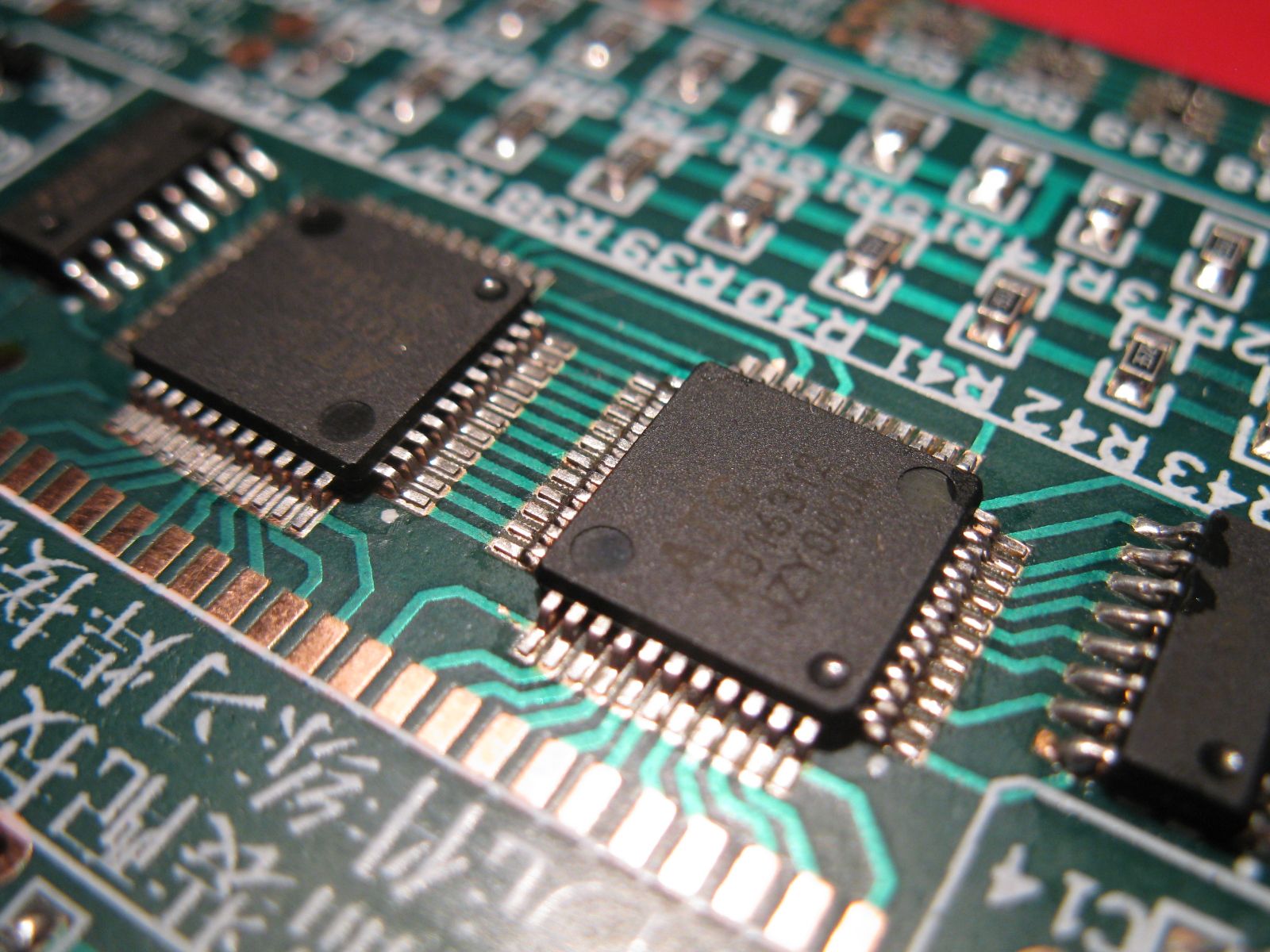

test if those parts are soldered correctly. The second practise kit has pretty much the same part but also
has 2 16-pin chips and most importantly 2 chips in a PQFP44 package. It also seems to have resistor arrays
in a 0603 package which should be a nice challenge.

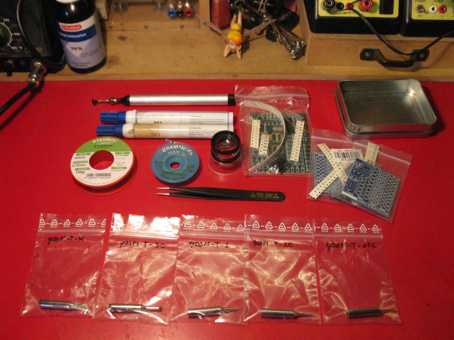

Besides the solder kits I also got some 0.7mm solder (I usually use 1mm), 2 flux pens, which I have
already made some use of and I can recommend it to anybody who does any DIY soldering, a selection of
different soldering tips* and a very crappy probably useless vaccuum placement tool. And to help me out
a bit more I' ll be using a pair of tweezers and a jewelers loupe (15x).
*soldering tips I have are:
900M-T-K (knife shaped)
900M-T-1 (pointy 1mm)
900M-T-3C (horseshoe C shaped 3mm)
900M-T-1C (horseshoe C shaped 1mm)
900M-T-0.5C (horseshoe C shaped 0.5mm)
I'll start with the 900-T-1C to see how well that works. I think for the electrolytic caps on the braids board
the 900-T-0.5C might come in handy.
So wish me luck and any suggestions are welcome (no, I don't have any blu tack alan Wink).

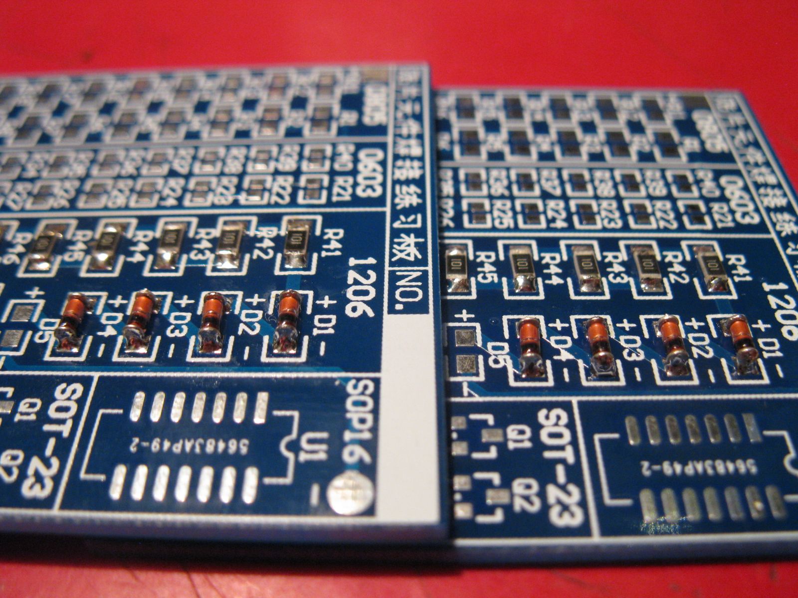

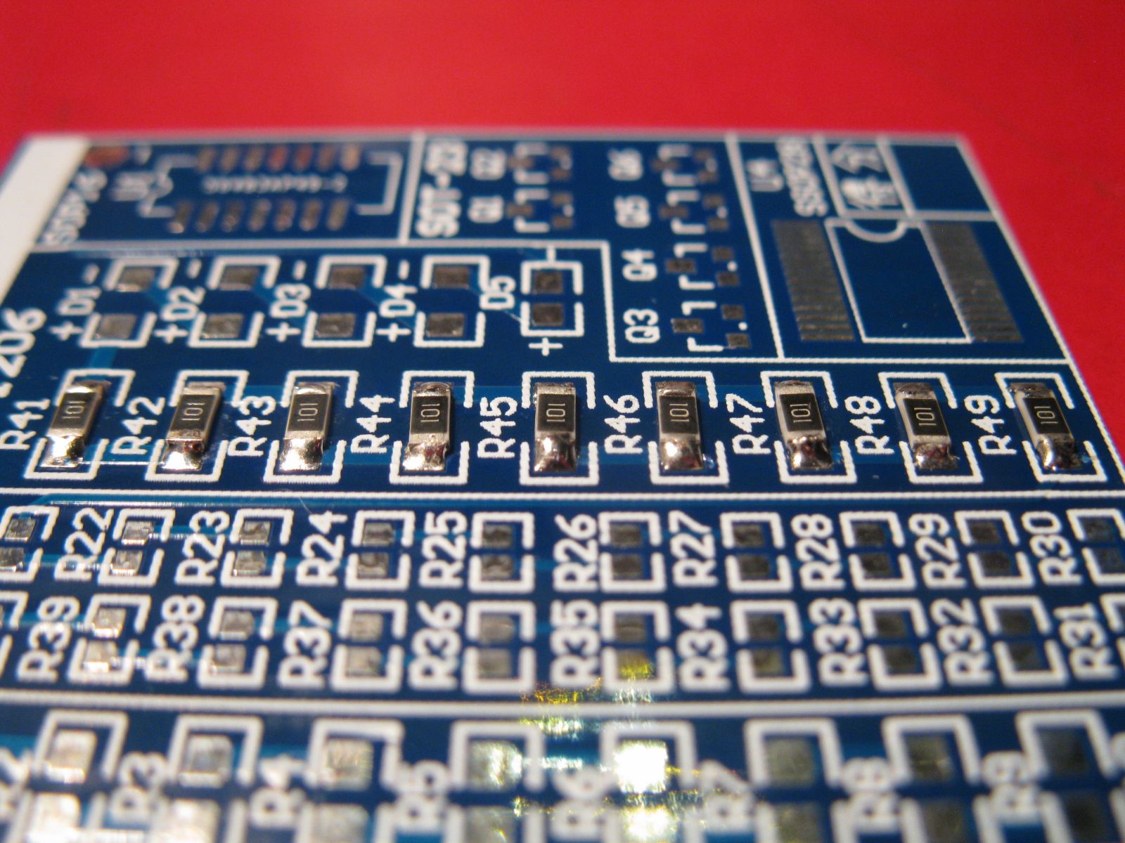

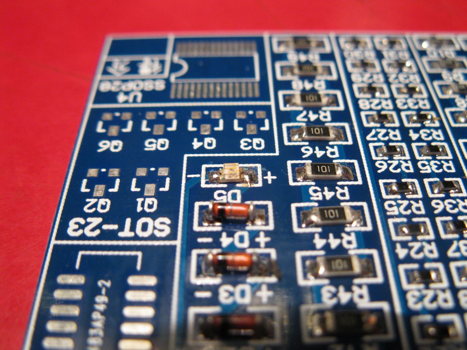

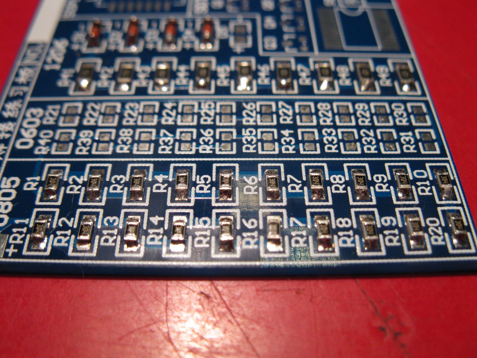

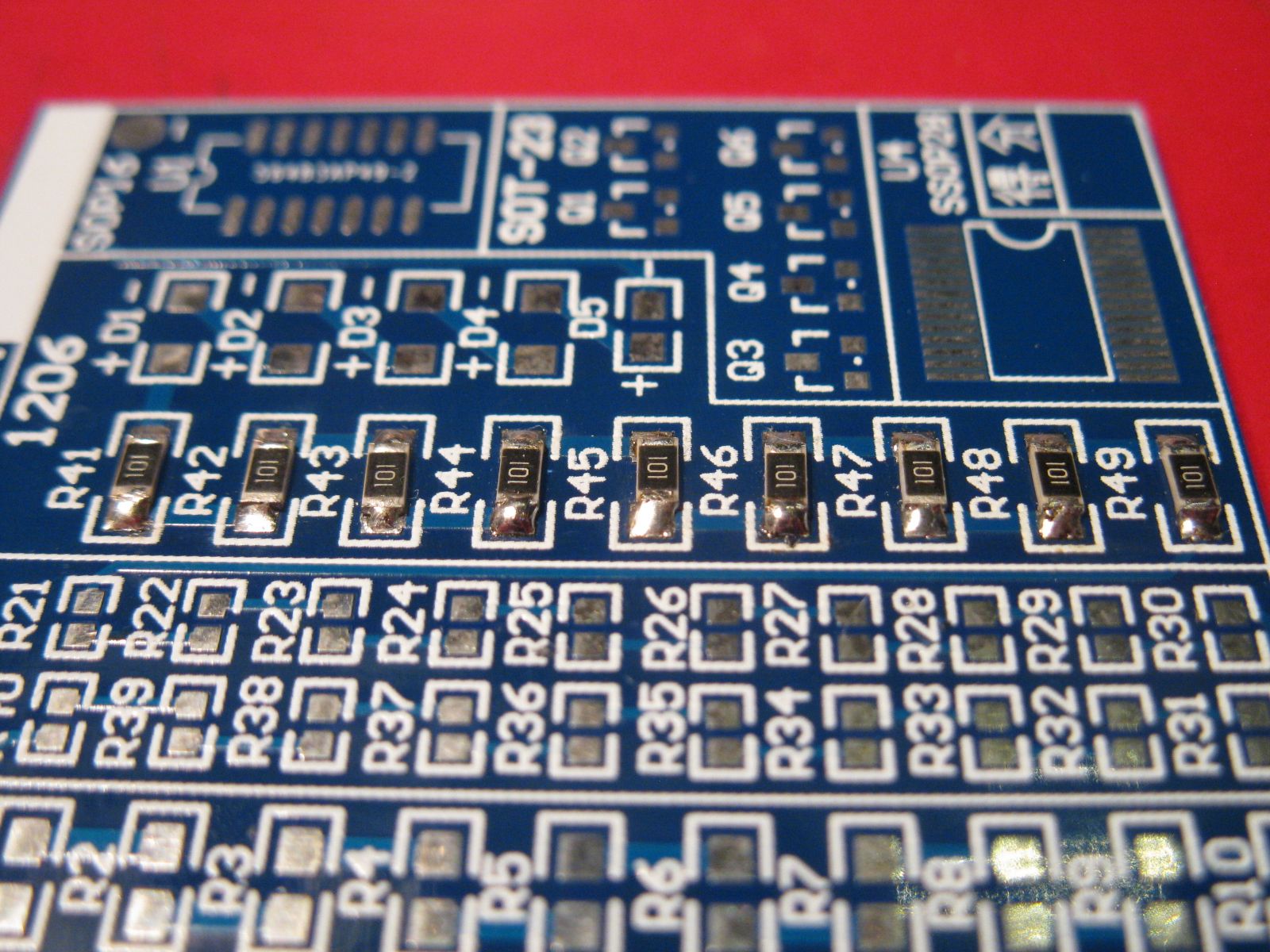

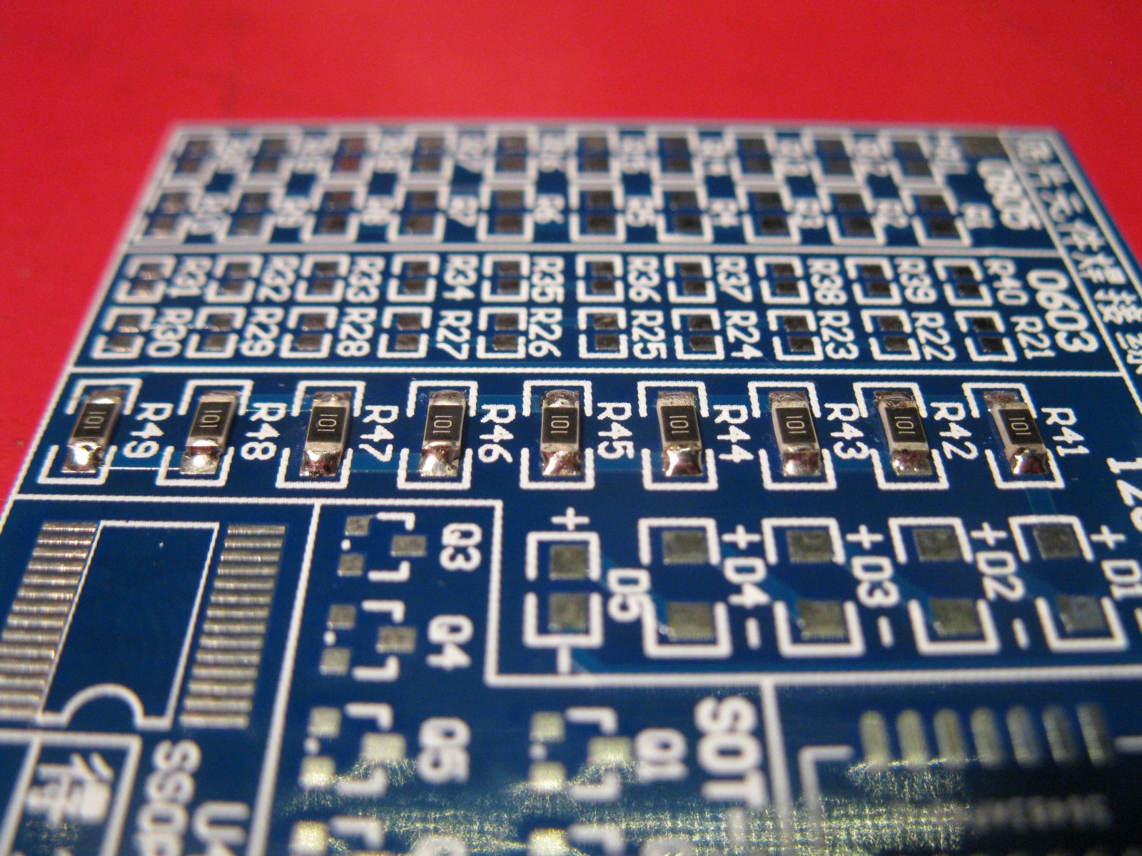

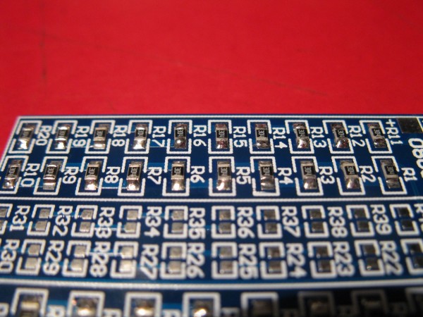

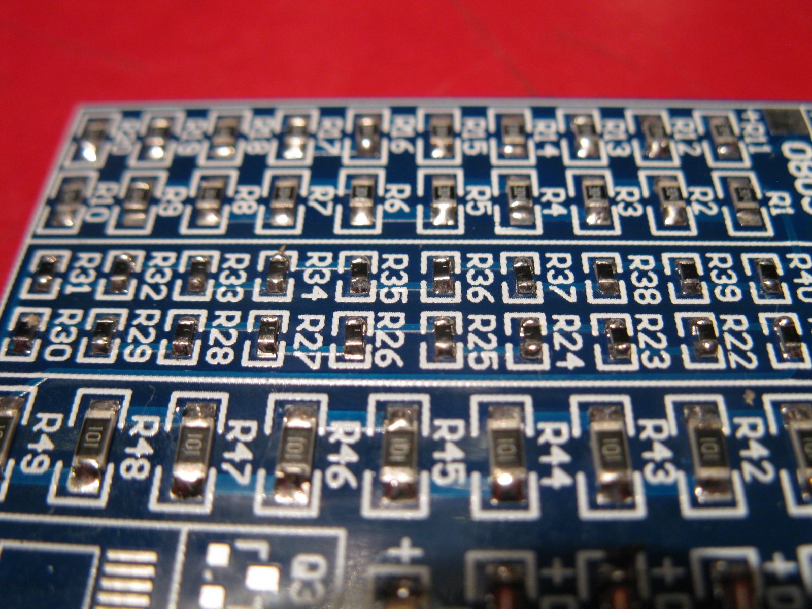

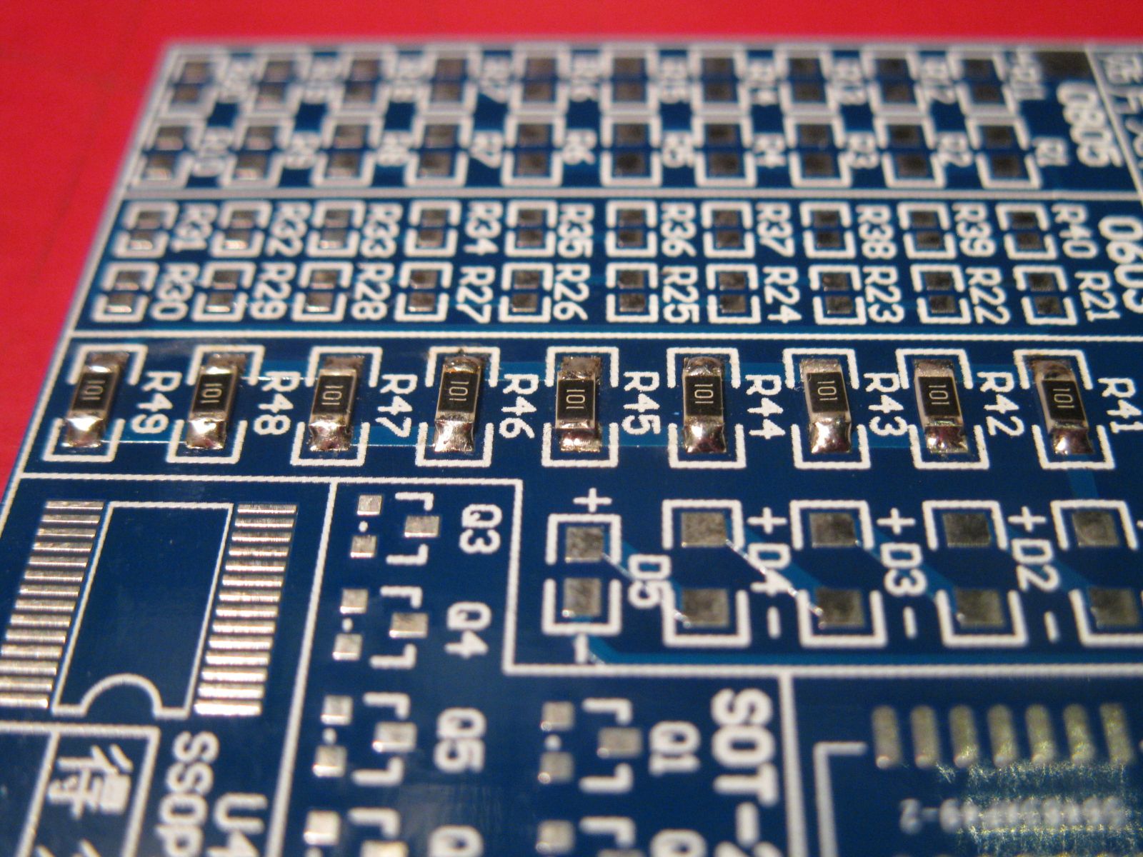

The first 9 1206 resistors are soldered. I have to admit it was already a bit more difficult than I had expected (any tips on
turning over an SMD component ?) but I think I doesn't look too bad. I did clean up most of the joints with some soldering
braid and in some cases applied some fresh solder. By the looks of it I can still use a lot less of it, which is a bit tricky but
I haven't tried flux yet. The soldering joints for R42 and R45 on photo 03 look like what I am aiming for.
Since I have 2 of these boards I will first solder the 1206 resistors on the other board and than probably try the diodes.

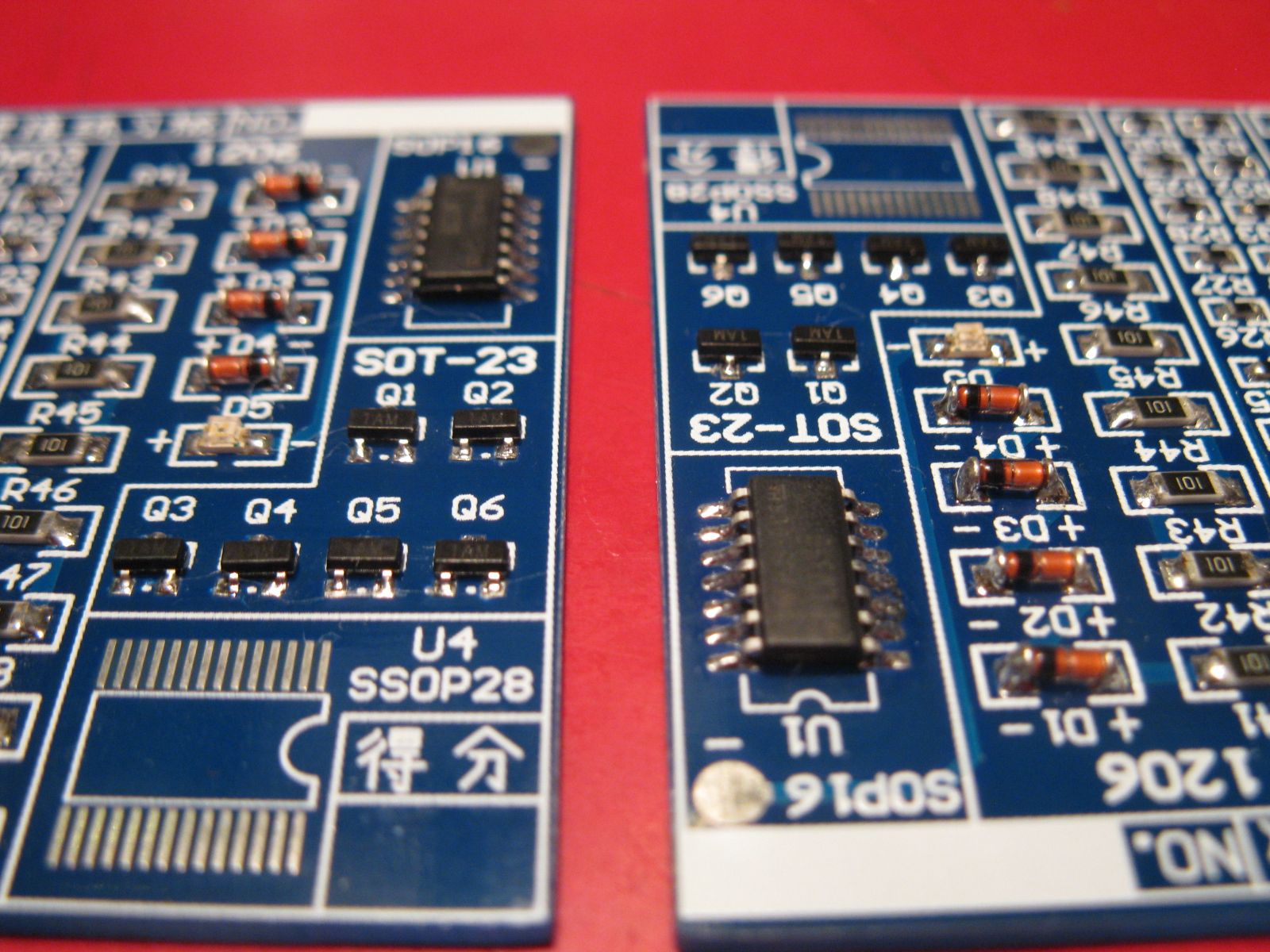

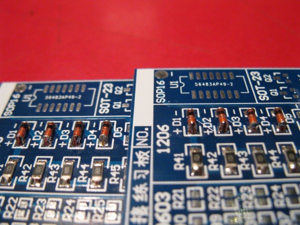

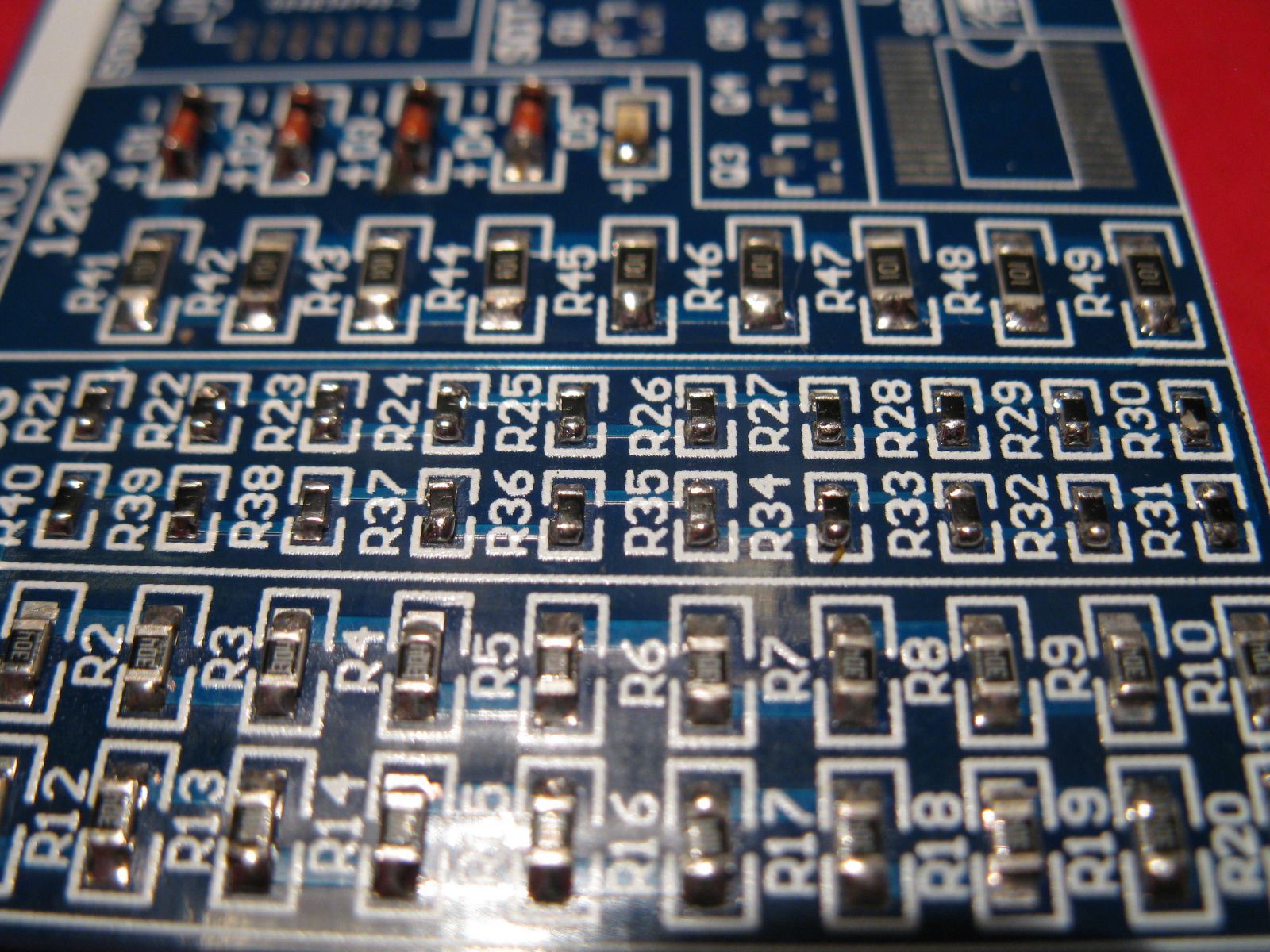

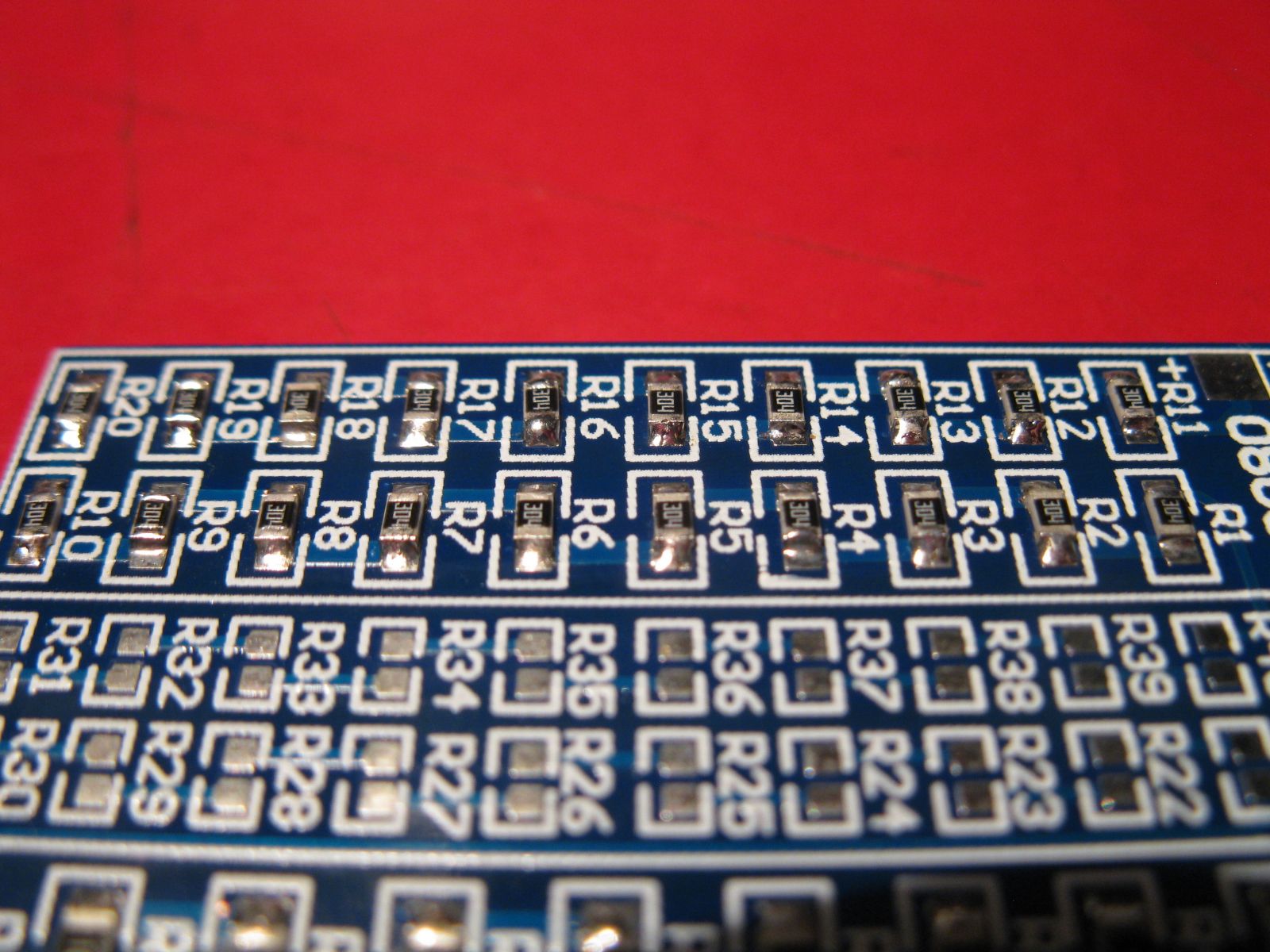

I changed the tip and tried the 900M-T-1 which works a lot easier. The joints are still a bit blobby but I didn't do any cleanup this time.
Flux also seems to help a bit but is not really necessary.

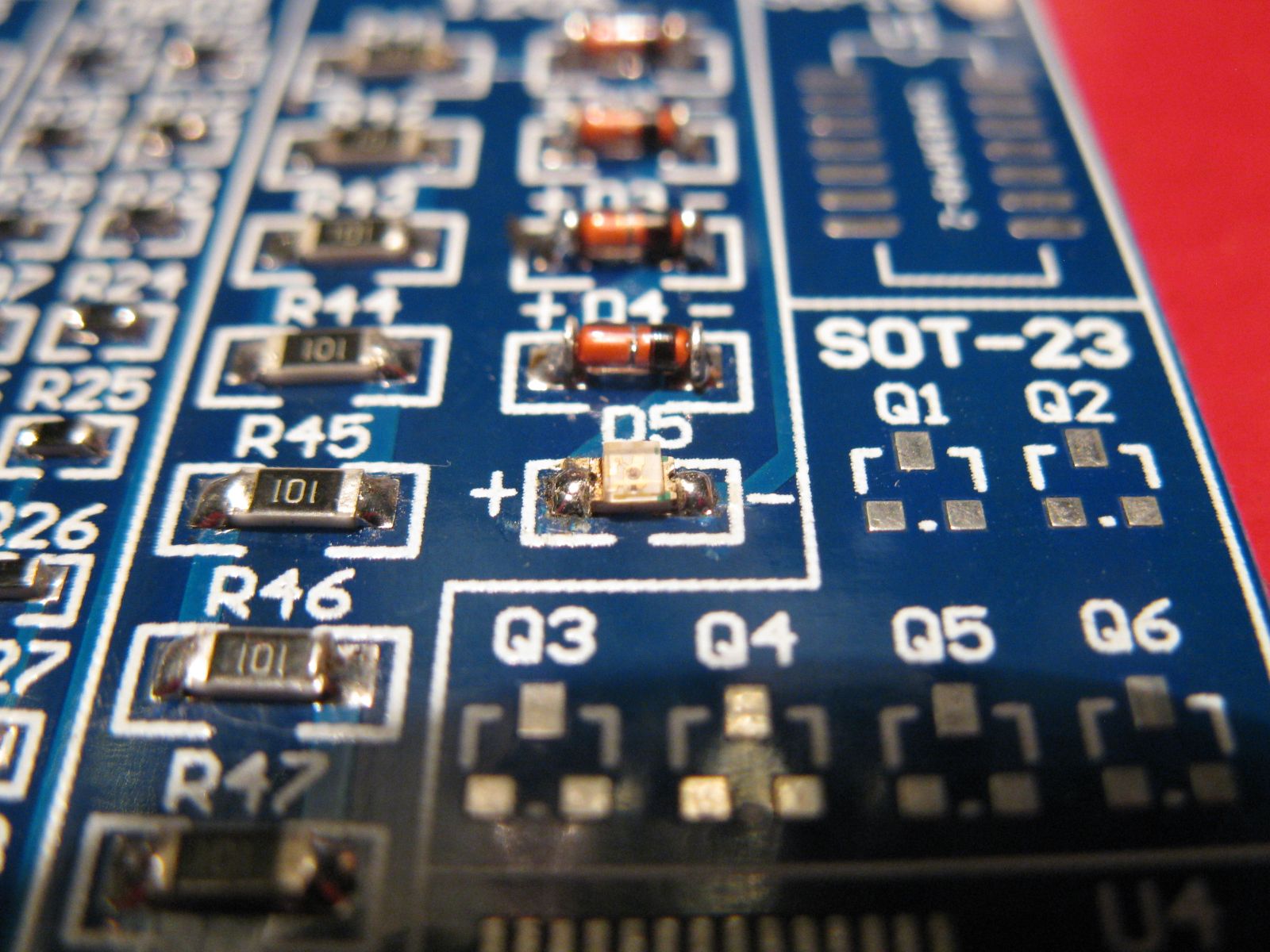

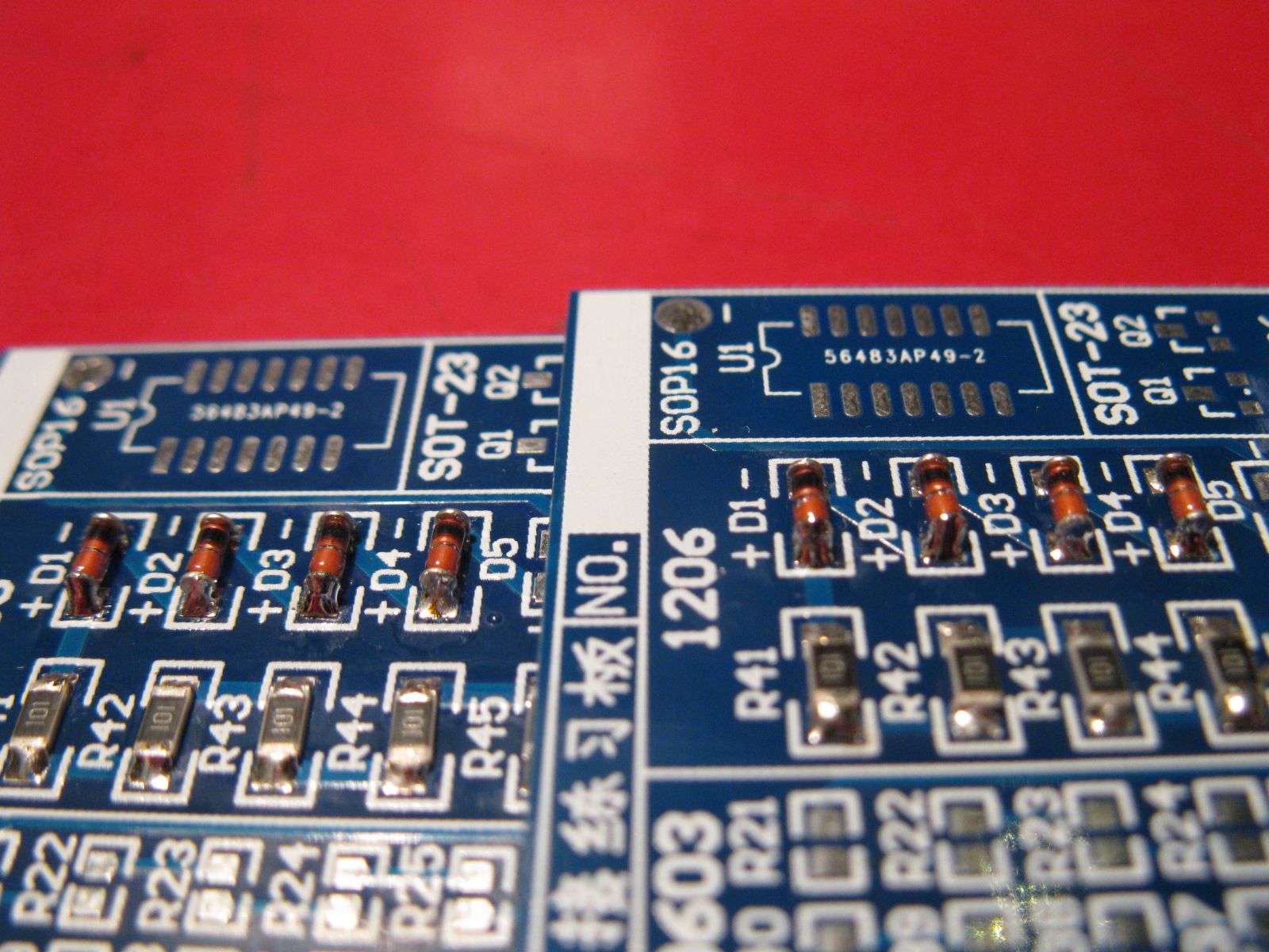

The diodes were not that difficult to solder just slightly tricky to hold with the tweezers. I don't think the Braids module
uses any of these though.

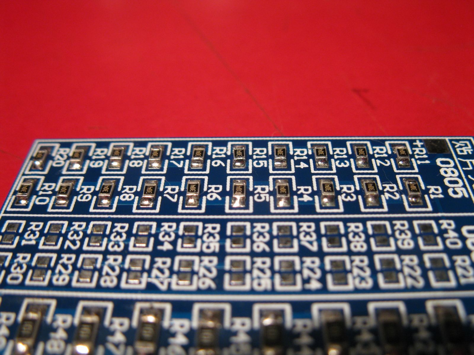

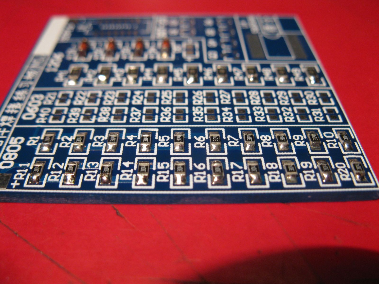

I think the 0805 resistors came out pretty nice. I am using the maginfier in my desklamp now which definitely helps
but also soldering slighly different. I first add a bit of solder to one pad position the component and tag it on then
solder the other pad. But what I've done different this time is that for the other pad I add flux and add a minute
amount of solder to my iron instead of to the pad directly. Sometimes the solder on the plated pads is even enough.
The 0603 resistors are going to be a bigger (or is that smaller) challenge of course.
(yes the resistors are upside down as I initialy thought it said 10E instead of 304)

I just tried the 0603 resistors and these are too small for what I would say is comfortable. Not that it is impossible it actually
went pretty well I think, but 0805 are a nice size for manual handling and soldering. With the 0603 it gets so small that
you quickly have too much solder and positioning is a lot harder. I am pretty sure the Braids PCB uses 0603 but they aren't
really designed for DIY. I also soldered on the LED which was actually a lot harder than I had expected and I really don't
like the solder joints on it. It looks like it is just sitting in the solder, but it works.

I use a flux pen. Put on the pads, place the component, a little dab of solder on a clean iron tip, just touch the tip to the pad and edge of component and the solder wicks right in.

I've learnt to solder the 1206 without flux by dropping a blob on one pad and then sliding the resistor in with tweezers. Previous flux and resistors was haphazard.
Diodes wise I made the mistake of choosing some package which is hard work even with the magnifying glass and is a constant source of poor connection.
ICs ,on a sea of flux, I'm happier with anchoring one pin then doing individual pins and only resort to drag when I get in too close or there's too much solder.
That's how I am doing it at least for one side, the other side I use flux and solder added to the soldering tip.
seems to work pretty good. Positioning is a bit of a hassle sometimes especially with the very small ones as
they stick to the tweezers or the solder pulls them in the wrong direction.

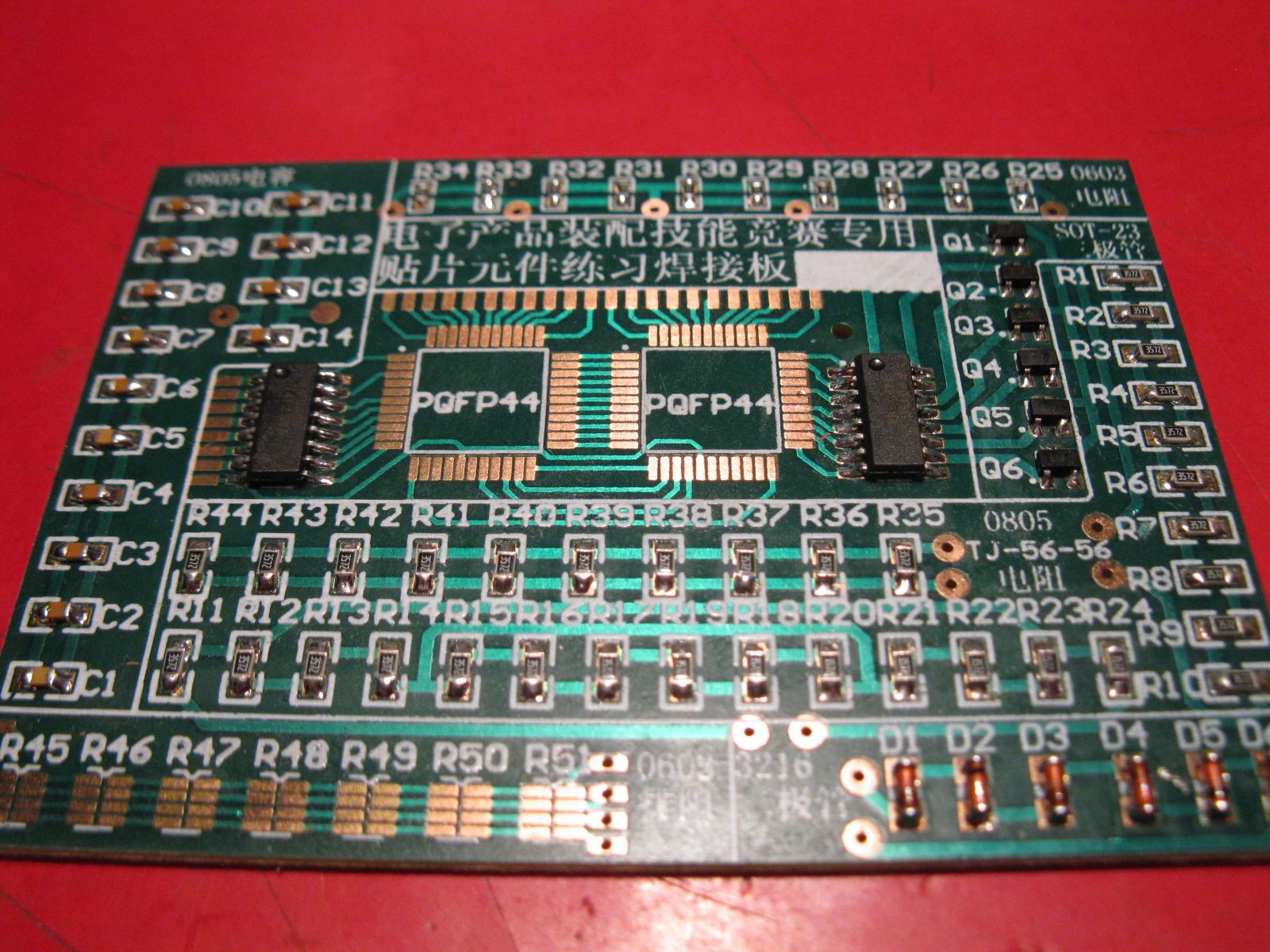

A photo of the 2 finished practise boards and I also soldered all the 'easy' parts on to the other board.

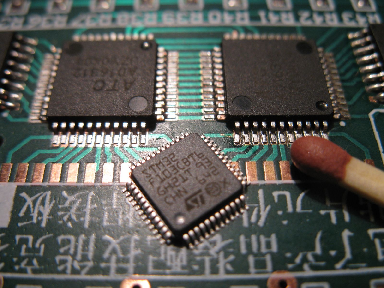

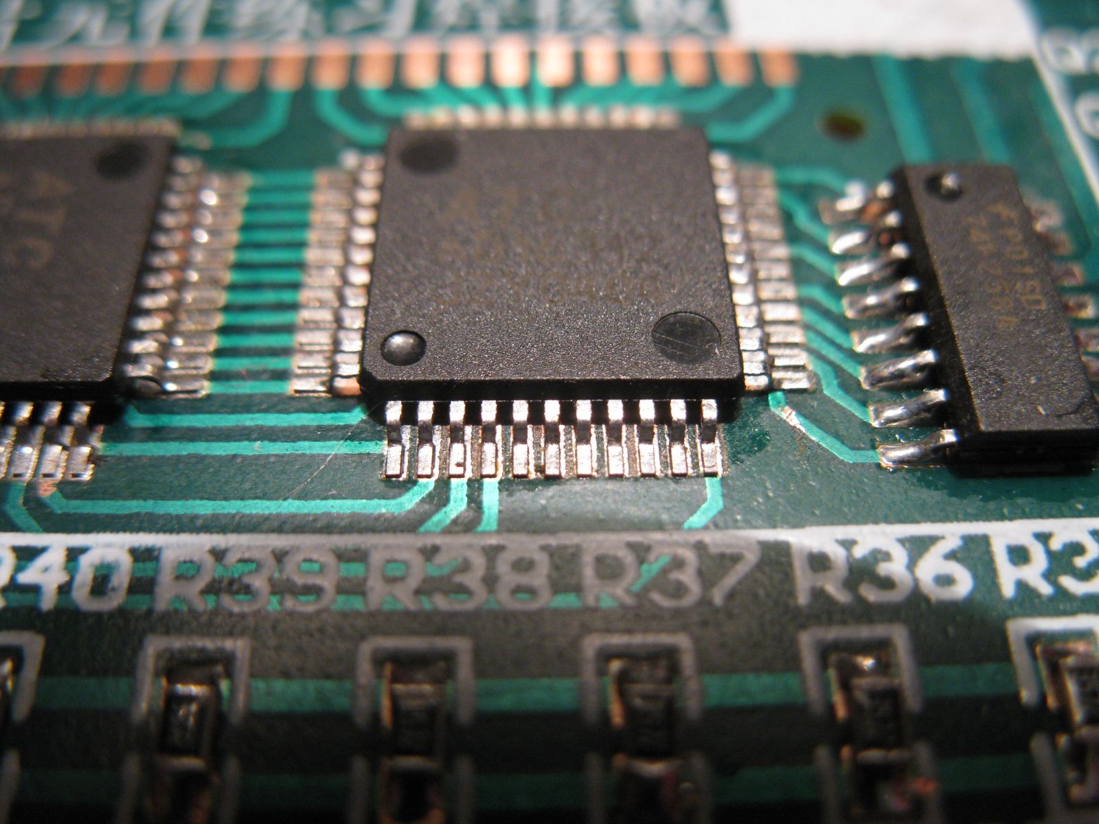

PostPosted: Sat Sep 02, 2017 11:51 am    Post subject: Reply with quote  Mark this post and the followings unread

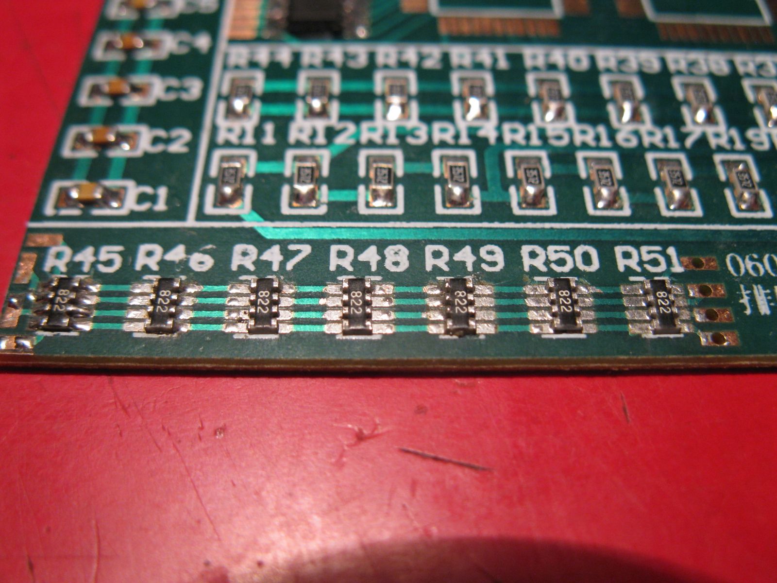

I managed to get the resistor arrays soldered. I definitely needed to use solder wick for this which
was rather tricky as they quickly heat up and desolder themselves. It might not be the prettiest solder
job but they seem to be connected without any shorts.

The final components have been soldered on too Very Happy These were actually rather easy to do, a lot easier
than the resistor arrays. I did one with the regular soldering tip and for the other one I used the knife
shaped tip. The knife shape works perfect if you apply just the right amount of solder but even if you
add too much and wick it away it works really fast so I can recommend it for these kind of chips.
Yes, I bodged the orientation on one, better be careful I don't do any of that stupid stuff on the Braids PCB.
 Filesize:  270.84 KB
 Viewed:  557 Time(s)
This side was soldered using the knife shaped tip with just the right amount of solder.
 Filesize:  247.19 KB
 Viewed:  566 Time(s)
PostPosted: Sat Sep 02, 2017 12:30 pm    Post subject: Reply with quote  Mark this post and the followings unread
Good stuff -- only thing I'd add would be to be careful when soldering ICs. It can be quite easy to have a leg that LOOKS like it's soldered, but in fact is not.

A challenger appears Shocked
 Filesize:  261 KB
 Viewed:  538 Time(s)
Posts: 5911
PostPosted: Sun Sep 03, 2017 5:57 am    Post subject: Reply with quote  Mark this post and the followings unread

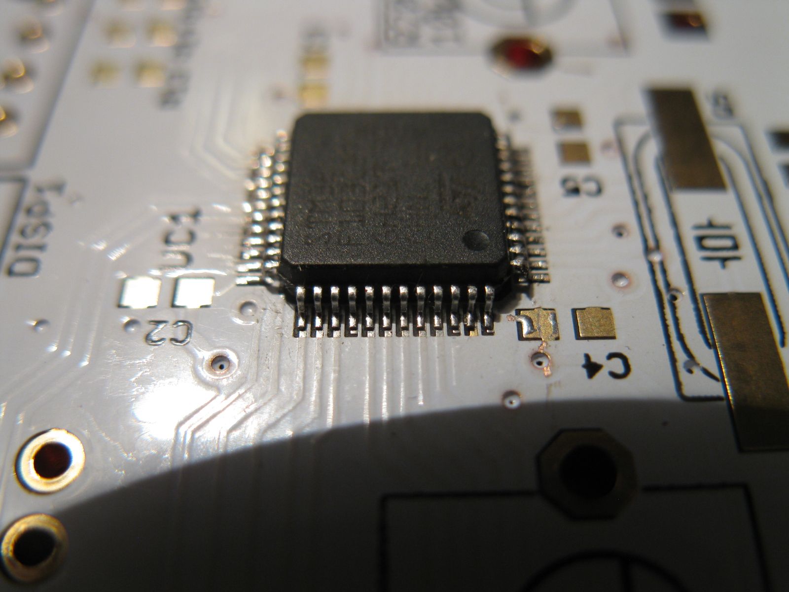

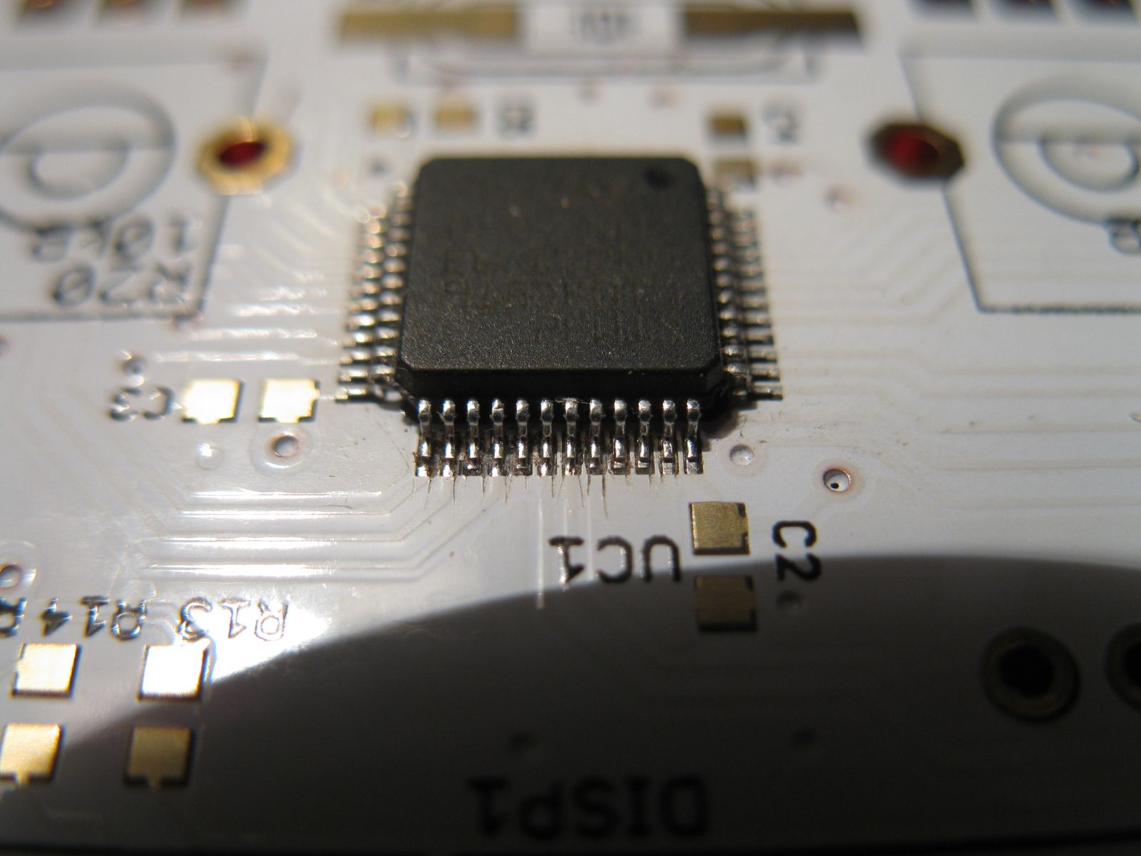

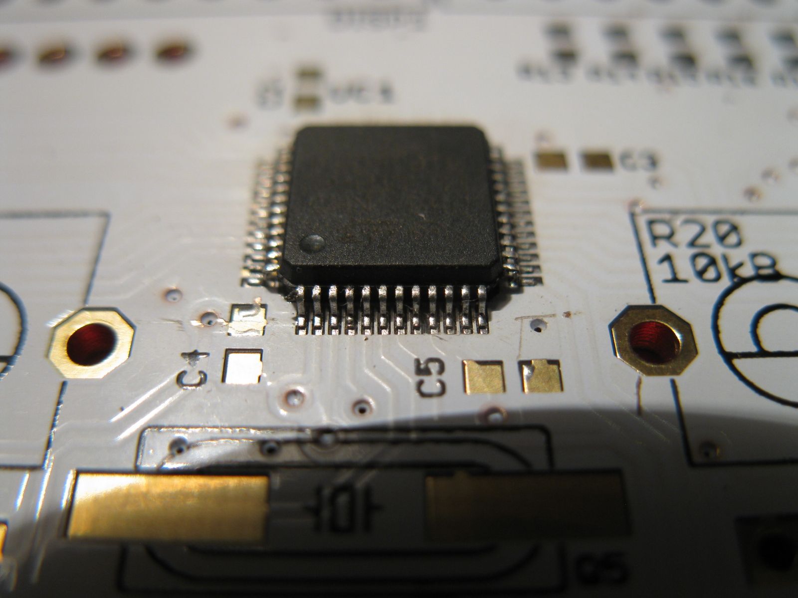

well, there is no turning back now. Of course I immediately screwed up a bit. When I grabbed my soldering iron while focusing
on keeping the chip in the right place I apparently touched the rol of solder (plastic) so when I started soldering I was greeted
by some red molten plastic mad, short circuit . I think the connection is ok though and as you can see in the last photo I tried to clean
it up a bit with a (very sharp) dental pick which scratched the soldermask a bit. Something that wasn't helpful with trying to
position it correct is that the soldermask is a bit offset. But all in all I think I could have done a worse job.
 Filesize:  147.74 KB
 Viewed:  553 Time(s)
 Filesize:  148.49 KB
 Viewed:  551 Time(s)
I measured the pin on the right side that doesn't look completely soldered and it's ok. It is actually connected to the GND plane.
 Filesize:  161.39 KB
 Viewed:  580 Time(s)
the molten plastic side with scratches from the dental pick.
 Filesize:  143.96 KB
 Viewed:  584 Time(s)
Posts: 5911
PostPosted: Sun Sep 03, 2017 6:03 am    Post subject: Reply with quote  Mark this post and the followings unread
A useful tip: while soldering I used my camera in macro mode to take photos and zoomed in to check the connections.
I did find one unconnected pin this way and a short between two other pins.
