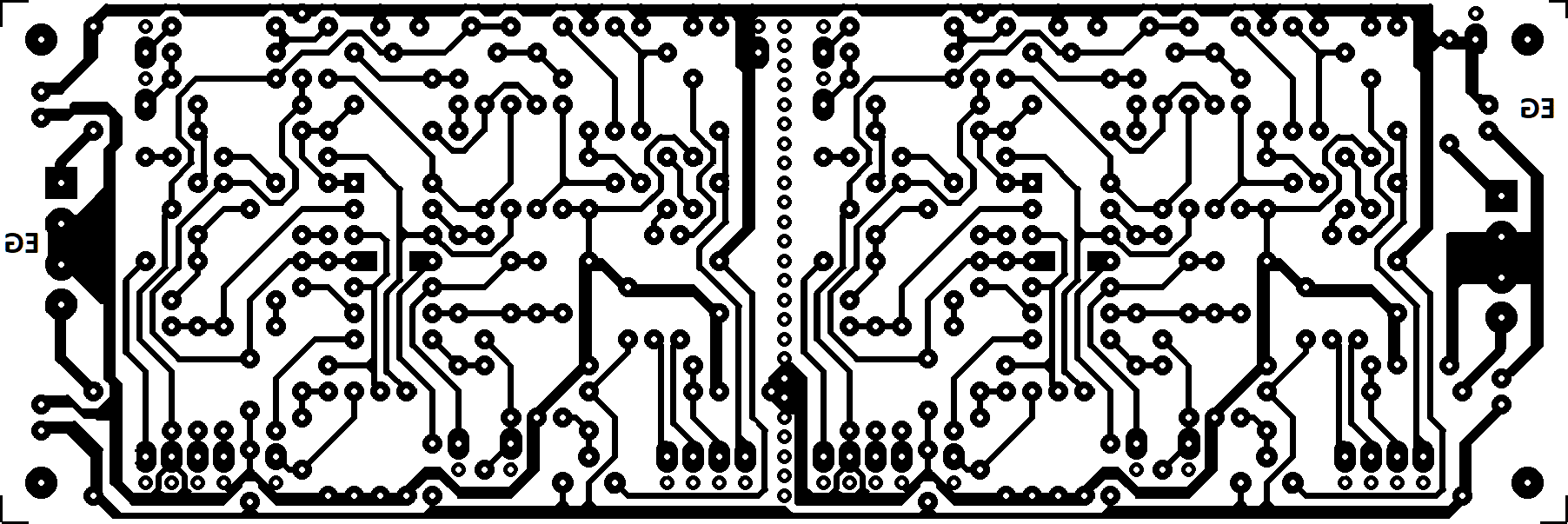

PostPosted: Mon Nov 06, 2017 10:57 pm    Post subject: Reply with quote  Mark this post and the followings unread
Here's the Dual Utility EG:

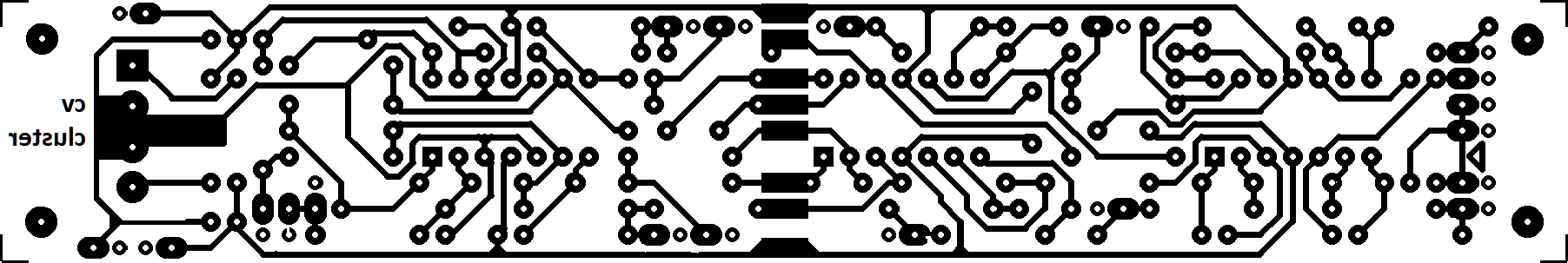

PostPosted: Wed Nov 08, 2017 7:35 pm    Post subject: Reply with quote  Mark this post and the followings unread
And Here's the CV Cluster. There's some metal tabs in the middle of the pcb, which by my understanding of the notes are there in case you wish to cut the pcb in half to save space behind smaller panels.
I actually don't quite yet understand what this module does, but is sure sounds interesting!

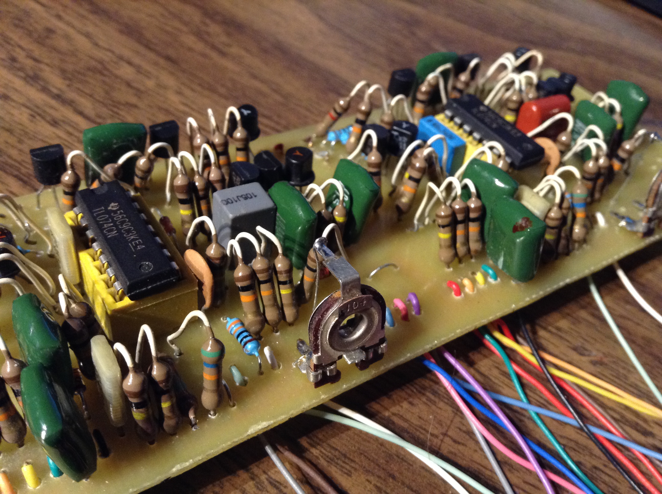

PostPosted: Sun Nov 12, 2017 1:32 pm    Post subject: Reply with quote  Mark this post and the followings unread
^ You're welcome. Let me know if there's any issues with the pcb that need to be fixed.
I just finished etching and drilling 6 pcbs, 2x VCO, 2x DUSG, and 2x Dual EG. There are a few etching faults that still need to be fixed, but all in all they turned out pretty good. I'll start stuffing them today, but I don't have all the parts necessary to finish them yet.

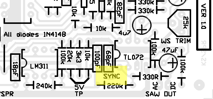

Just finished populating one of the Dual Utility EG pcbs. Anyone know a source for 2.2M Sliders for this thing?
I also have some questions regarding the CGS VCOs exact functions just to be 100% sure before I make the panels, and to know how to label the front panel using terms I'm more familiar with.
What is the difference between the VC FM in, and the FREQ CV in? Is one linear and the other exponential?
What does the Sub Osc sync do? I don't see any other normal sync input.
Is the Sub Osc in there so you can run other signals through the sub osc?
and lastly, assuming that the Sub Osc Steps CV changes the Sub Osc Step knob value (correct me if I'm wrong), would it be practical to add an attenuator for that function, or redundant?

PostPosted: Fri Nov 17, 2017 7:31 am    Post subject: Reply with quote  Mark this post and the followings unread
VC FM is lin FM and Freq CV is exp. FM... At least anything going in into the summing Input from the OP amp of the Expo converter is somehow giving an exp. FM.

PostPosted: Thu Nov 23, 2017 9:16 am    Post subject: Reply with quote  Mark this post and the followings unread
the normal sync is here
 Filesize:  138.97 KB
 Viewed:  543 Time(s)

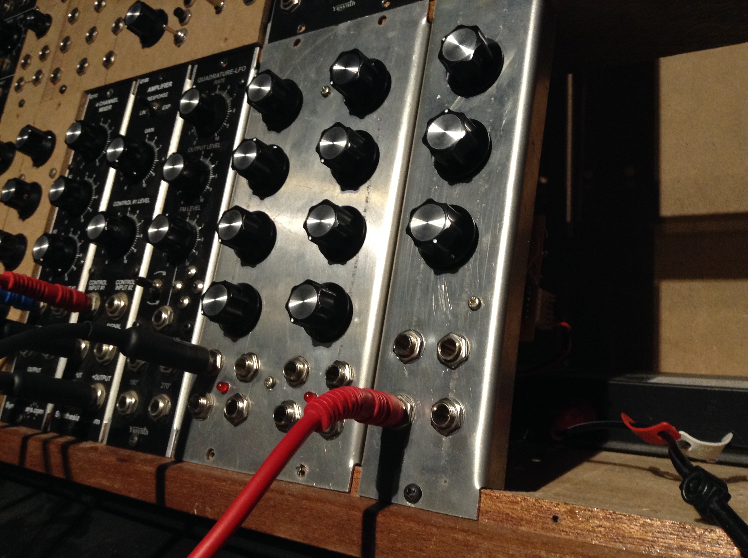

PostPosted: Sat Nov 25, 2017 9:22 pm    Post subject: Reply with quote  Mark this post and the followings unread
I made two Dual Utility Eg pcbs a while ago, but ended up only including one in the briefcase synth, so today I put one of the pcbs behind a MU panel in my MU modular. I also perf-boarded a Utility LFO. Both worked great right away without any fiddidling. I used 1M pots instead of 2M2 on the EGs, so I'm going to put some larger value timing capacitors in them to get more range, maybe add a switch. great Eg. The Utility LFO is pretty awesome too, just lacking a cv in.
I've been talking to the guy I mentioned (Julian) about the brushed aluminum, blue infill panel, and it looks like it's going to go through, so I'll have one great looking panel Razz
Here's a photo of the two CGS modules in my MU Modular. Not very pretty... Eventually I'll bother to learn how to silk-screen and make some pretty panels.
