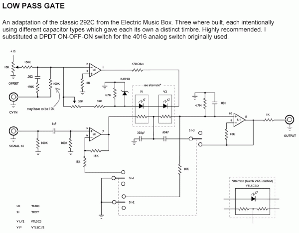

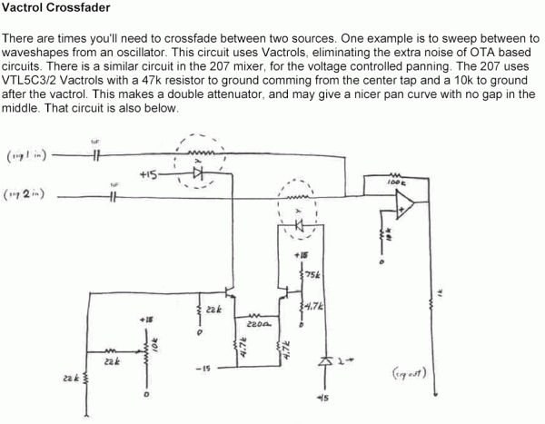

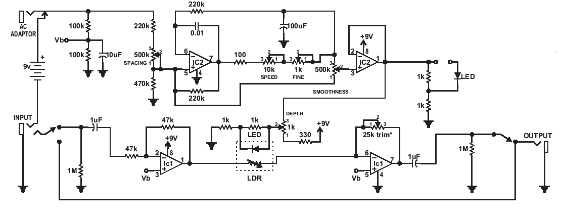

vactrols are used to apply voltage control. actually the diode of the vactrol is part of the cv circuitry, the resistor part of the audio path. some samples:
p.s.: i'm not a native speaker, so could you be so kind to explain the meaning of pluck in that context?

Vactrols have two components: an LED (Light Emitting Diode) and an LDR (Light Dependent Resistor).
The way they're used is current is pumped through the LED. More current means a brighter LED. As more light shines onto the LDR, it allows more current to flow through it.
Is that what you were looking for?

I am looking at the 292 schematic and especially interested with how the vactrol is driven.
I have a few questions:
1. Are the leds in the feedback loop of the OpAmp so that there is a log response to linear input voltage? Is that for musical reasons or or does it counteract the non-linearity of the vactrol to produce a more linear response relative to CV in?
2. What is the function of the Zener diode in the feedback path?
3. Why is that resistor in parallel to the Zener diode (this should be obvious but I am feeling dumb on this one Razz I am sure it has to do with when the Zener has not turned on yet.
