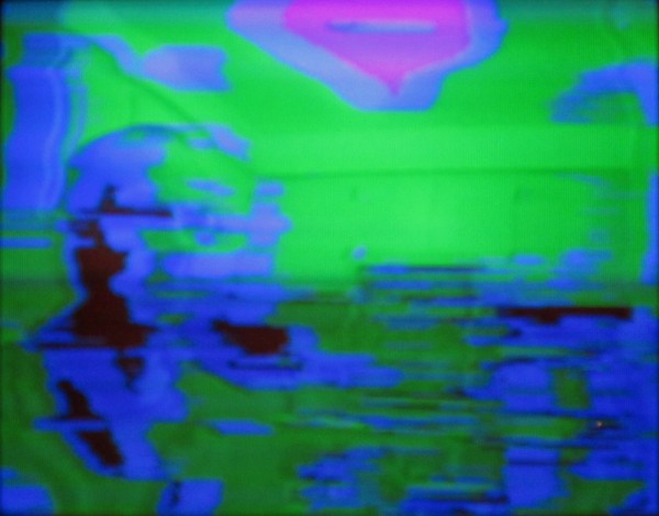

selfie using the Visualist
 Filesize:  180.09 KB
 Viewed:  726 Time(s)
Selfie using the Visualist circuit. Note that for this one, I had added a simple 1K pot to mix the original camera signal with the Visualist's output.

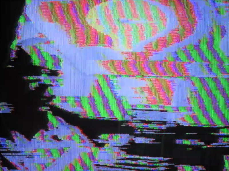

So, a further experiment: Instead of the "Color select" switch, I have the A & B pins of the 4052 connected to a 2-bit counter. As one can see in the first attached image, it creates colored stripes. As one increases the speed of the clock feeding the counter, the lines become thinner. Finally, at fast speeds (ooops, I should have measured... I'm using a 4093 oscillator with a 250k pot and switching the cap... so this is using a 101 or 102 cap by now), the lines do weird things, sometimes rotating and sometimes creating moiré-like patterns. Just touching the pot seems to change things drastically.
I still have a few more things I want to try.

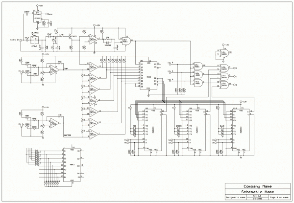

Here are some circuit diagrams that may or may not be useful. I' m pretty sure the 4043 in the left corner is
to create "radio buttons" to control the muxes. I should have a circuit diagram of it, maybe on my old laptop.
I don't know if I actually tested the RGB outputs with CV control, have to check the actual circuit. In the meantime
here's a photo of a test setup.

Ha! Wow... just as I was thinking of posting that my experiments are done and I give up on this circuit as something I would want to build into a box, you post this stuff!
My last experiments with using an external signal to modify the R, G and B saturation did not give much. Putting different LDRs in parallel with a saturation pot as suggested by the original documentation doesn't do anything for me. Putting a 1K pot in parallel instead does change it a bit, but not in a useful way.
It doesn't seem like the demo video ever showed sound being used.
Obviously you got further with the construction. I'm still on the breadboards [see attached image]. I notice how you handled the color order display. I used three 4-pin RGB LEDs with diode steering to do that.
[build, build...]
OK, so I built the PHOBoS CV input / RGB level circuit, and after a bit of experimentation, I think I understand where the outputs go.
I tried with a couple of LFO's producing CVs, and it appears to work! One does seem to need to adjust the 470 ohm saturation pots otherwise the CV seems to have less effect, or one can loose sync.
This is more promising now. I'll have to try some experiments generating more wildly-changing CV, rather than slow LFO type things.
Thanks again, PHOBoS!
