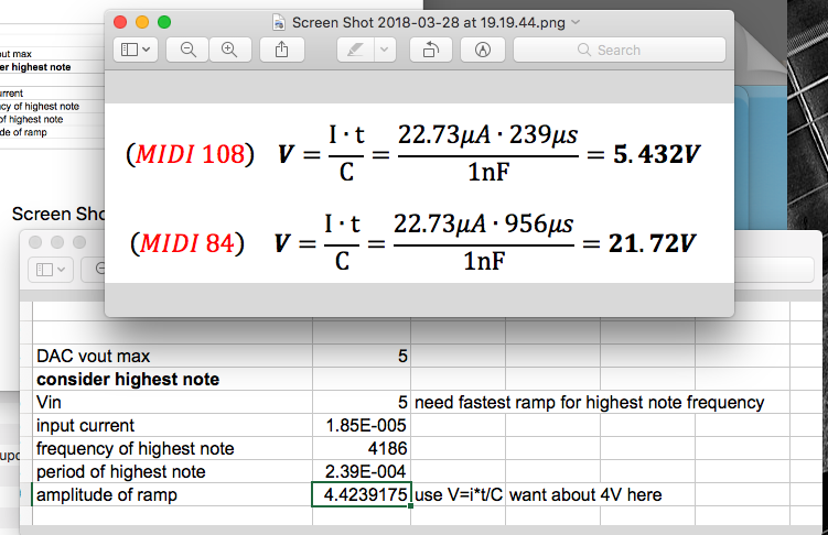

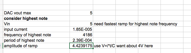

I am still a bit confused with the DAC max ramp equation. You seem to have gone for the 5 octave range (which is what I want to achieve). but the max ramp equation uses the time period of the MIDI note 108 (4186Hz). So I thought that maybe you did this before you decided to reduce the octave range? and that maybe by using MIDI note 84 (1045Hz) as the highest value, the accuracy would be improved? Im pretty sure I am missing something here again, since when I change the values, the max voltage shoots up to 21 volt! .... I have attached your equation and mine. Why was MIDI note 108 used here when we only want a range from MIDI 24 to MIDI 84 as mentioned in your notes?
note that I changed the value of R to the 220Kohm that was used in your schematic, giving a new value of Iin.

synthjakk wrote:
Ahhh I see, I will have to have a look for a simple design that will allow me to use this device on its own.
This design goes up to midi note 108, which is 4186Hz, at this point the DAC is at its maximum voltage of 5V.
I can see how the spreadsheet is a bit confusing, it was just for my own use and didn't consider that others would be trying to make sense of it. The 'voltage control' sheet was kind of experimental to see if I could get it to work purely by voltage (rather than midi) control, in which case it would have been 5 octave range as you say, since the ADC input voltage is 0 to 5V, with 1 V/octage. The sheet 'MIDI tables' gives a more true picture of how it is operating.
regarding the resistor, I seem to have used 270k in the calculations, and in simulations I did, but I used 220k in the prototype and also in the schematic I drew. I can't remember why this was, probably it was all I had to hand at the time. It doesn't make a big difference, smaller values will give a larger amplitude ramp.
The actual core of the design is quite simple in fact, I guess I have made it look more complex in my design calculations than it actually is.
U5.2 and associated components are an integrator. The - input of the opamp is a virtual ground, therefore current through R8 will be V_DAC/R8
(where V_DAC is the output voltage of the DAC).
So say R8 is 270k and V_DAC is at 5V, then the current will be about 18.5 micoamps at this point.
The current into the opamp pin is negligible, so pretty much all of this current goes on to flow through the capacitor C9.
If a constant current flows in a capacitor, the capacitor will charge up and develop a voltage across it, the equation for this is i=C*dV/dt, or put another way V=(i*t)/C.
The voltage will increase linearly with time. Periodically the microcontroller will reset the integrator. RAW_SQR is a square wave at the note frequency (4186Hz at the top end), and the rising edge of this will trigger a short pulse on the output of U5.1, this short pulse will turn on the FET J1 briefly, shorting out the capacitor and reducing the ramp signal back to 0V.
So at 4186Hz, t=1/4186 = 239 microseconds.
using the above, V = 18.5 microamps * 239 microseconds / 1nF = 4.4V
component tolerances will come into it, plus FET leakage, so this should not be considered precise.
In my prototype I found the output level is pretty consistent, I am getting around 4V pk-pk across the whole range. I used a ceramic capacitor, which are not precise in terms of tolerance. It worked for me, but polypropelene would be more suitable due to its better tolerance.
Note that the output of U5.2 is ramping downwards, e.g. the waveform ramps from 0V downwards, because the left hand end of C9 is at 0V and the current is flowing left to right.

Thank you for that thorough explanation, that has really cleared things up. It was the octave range that mostly confused me. Wow, so this design plays just over a range of 7 octaves, from MIDI 21 (27.5Hz) to 108. That clears that confusion up lol So how come the base note (MIDI 21) does not start at 0V? I thought that the DAC steps have a difference of
Dac_V/Number of notes= 57mV, starting at 0V.
if I wanted to improve the accuracy by reducing the octave range, is it just the code that needs to be edited? or component changing too ?
