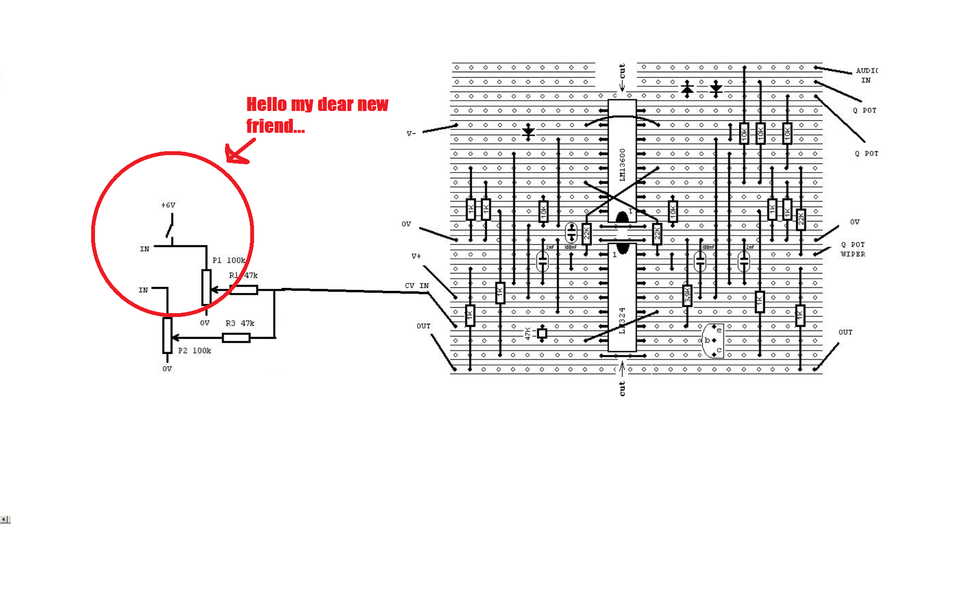

Hello everyone!
Need some help, just learning how this sh*t works Laughing
Got Nicolas's adsr and filter on the table, ready for breadboard fun.
He likes to have a "switched socket" to apply +v voltage to the input for the gate/cv to the circuit when nothing is plugged in. How does one do that?
"That switch to +6V is my crude way of showing a switched socket that sees +6V when nothing is attached. It doesn't really need to be +6V, any stable +ve voltage would be fine. " ~Nicolas3141
I'm new to circuits, this concept is a little weird for me to wrap my head around. I bet it's simple, just need some help.

Example

hi,
i could imagine this
