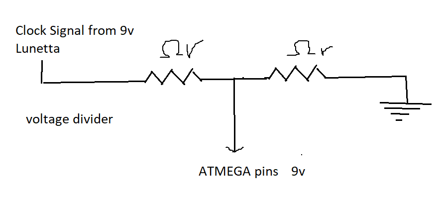

quick question: if I was to send a clock signal from my lunetta which i typically run at 9v in my case... in order for that to work with arduino at 5v should i connect my clk input jack to a voltage regulator or should i just use an adequate resistor to bring it down?
electrotech
Joined: Apr 24, 2013
Posts: 45
Location: Ayrshire Scotland
PostPosted: Sun Apr 15, 2018 3:56 am    Post subject: Reply with quote  Mark this post and the followings unread
Since the Arduino inputs are at high impedance and very little current is drawn, you just need to drop the signal voltage from 9V to 5V using two resistors in series which forms a potential divider. Try 18k and 22k with the bottom end going to 0V (GND) and the junction to the Arduino.
Andy
Posts: 1313
PostPosted: Sun Apr 15, 2018 5:59 am    Post subject: Reply with quote  Mark this post and the followings unread
Or use a zener diode (4v7) with a resistor of ~10k

Posts: 1313
PostPosted: Sun Apr 15, 2018 11:12 pm    Post subject: Reply with quote  Mark this post and the followings unread
In fact, you could leave out the zener and just use a resistor, because of the input configuration of the (Atmel) processor itself.

PostPosted: Tue Apr 17, 2018 9:51 am    Post subject: Reply with quote  Mark this post and the followings unread
I'm pretty sure I understand what your saying... so i doodled up a quick ms paint just to make sure. Set up connections like in this pictogram right?
All I gotta do is find the proper values.
-Cal
 Filesize:  9.91 KB
 Viewed:  443 Time(s)
Posts: 1313
PostPosted: Tue Apr 17, 2018 11:18 am    Post subject: Reply with quote  Mark this post and the followings unread
if you are going from a lunatta output to an arduino input, just connect a 10kohm resistor between the two, the input circuit of the arduino does the rest.

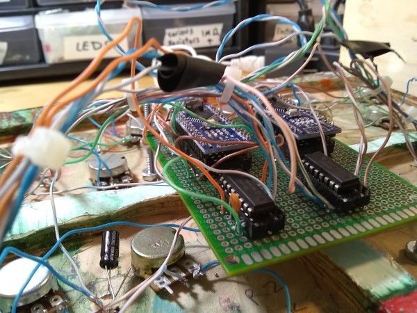

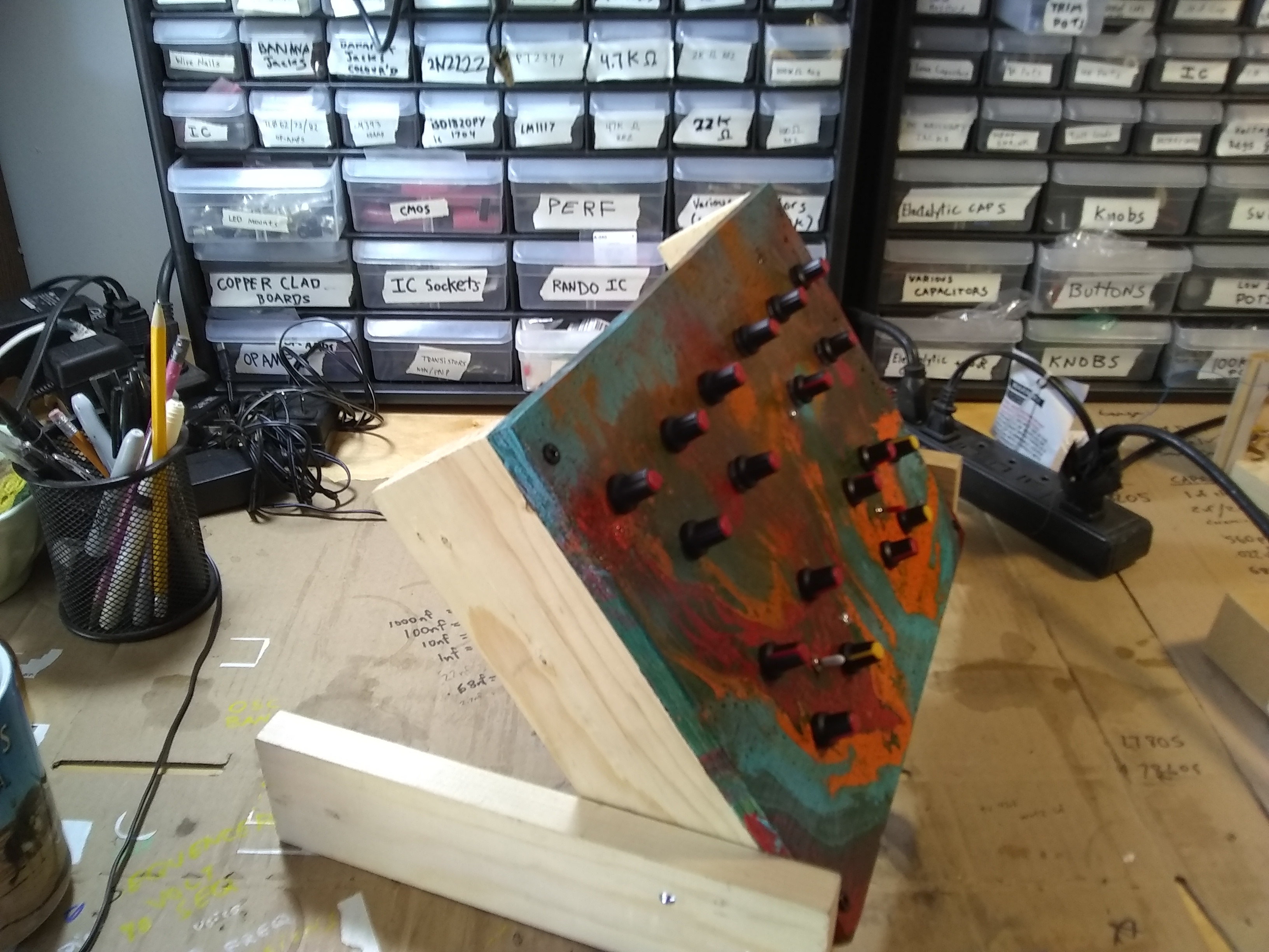

PostPosted: Tue May 01, 2018 4:11 pm    Post subject: Reply with quote  Mark this post and the followings unread
Still haven't done any coding yet but I did put something together with a sketch I found on the net using the mozzi library. Figured it would be a good start. 2 knock off nanos and 2 cmos 4046. The outputs of the nanos feed the 4046 vcos... One works spendedly and the other despite being rigged up exactly the same sounds alot less interesting. Fun none the less.
 Filesize:  2.4 MB
 Viewed:  362 Time(s)
 Filesize:  2.02 MB
 Viewed:  348 Time(s)
 Filesize:  2.61 MB
 Viewed:  359 Time(s)
Posts: 5828
PostPosted: Wed May 02, 2018 2:31 am    Post subject: Reply with quote  Mark this post and the followings unread
nice panel Very Happy of course I am curious how it sounds,. and what are you feeding the vco's with from the nano's
as they don't have an analog output. (although you could do something with an LPF). Also, is there a timing
cap missing on one of the vco's ?

PostPosted: Thu May 03, 2018 6:10 pm    Post subject: Reply with quote  Mark this post and the followings unread
The output of the microprocessors are currently just slamming into pin 9 of the 4046s. The timing cap on the 2nd one I ended up wiring off board to a switch so one can select the range (basically a high and low). One 4046 responds great to the PWM output and gives me some nice weird noises while the other one... not so much. I'm not sure what the deal is. I'll have to try putting a cap in line or something. The 2nd switch is a glide which puts a 10uf on the input to the 4046 towards ground... funny thing is 1 arduino likes it and the other, the one I'm having trouble with, caused it to reset. (shrug) That's why I ended up wiring the switch intended for the glide on/off to change the timing cap instead.
The backside is still exposed as I figured I'd likely end up having to change something eventually.
The yellow knobs are basically mixers. The ones in the square formation wipe between the arduinos and the 4046s and the one on the far right wipes between the two outputs of the previously mentioned pots. I tend to enjoy blending different sources together to get a wider range of sounds - I prefer everything I build to basically have an endless amount of possibility.
As to what It sounds like, I'll have to record something. It's a fairly simple code set up from the mozzi library. I didn't write the code... still trying to figure that out.
