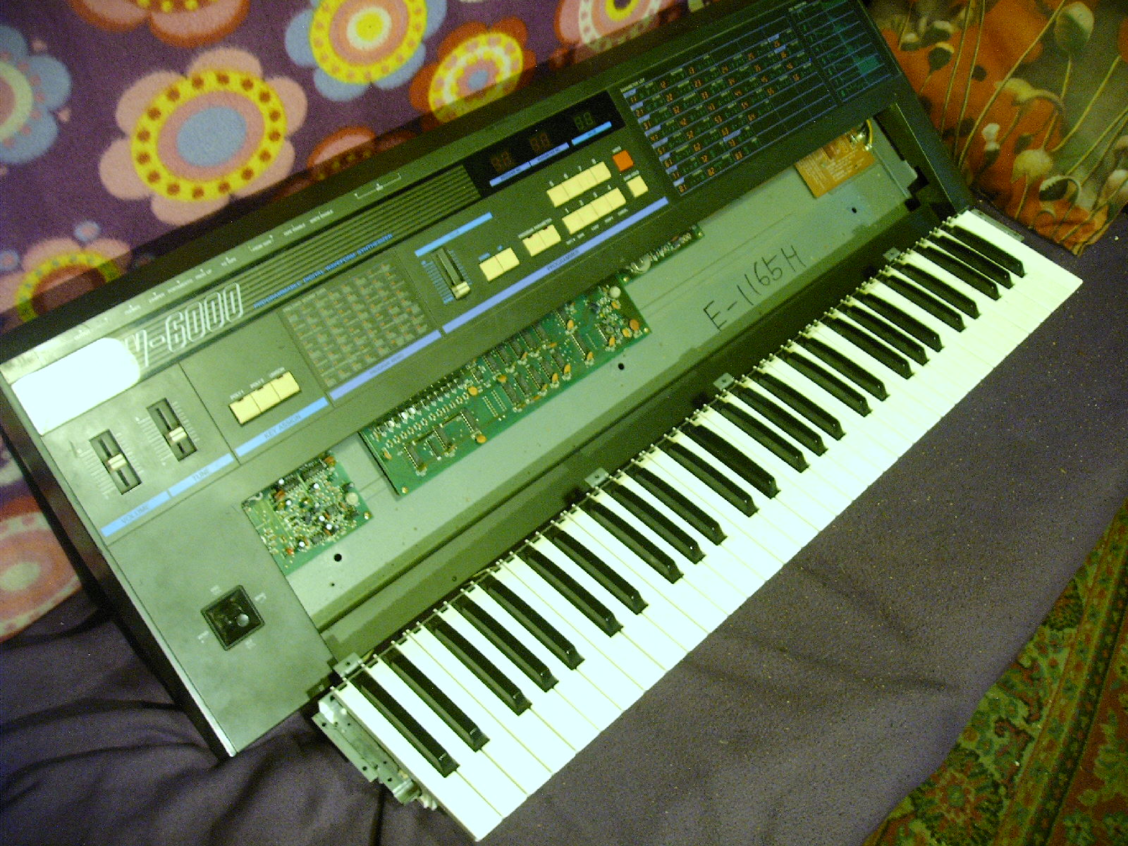

Although I have built some modular synth stuff I've never had a 'real' synth. Untill now! as someone just gave me a KORG DW-6000 Razz
As you can see from the picture it needs some work done, but from what I understand it is functioning. I knew there is a problem with
the keybed but I think the only problem is that the last key (highest) has one of the tabs broken off that the key hinges on. The key
next to it had one almost broken off and it did completely break when I took the key out. So I cleaned it with some alcohol and glued
it together with some superglue which seems to hold. I am not sure if I can fix the other key but I will try. Maybe I can cut off a piece
of plastic from something else, shape it and try to glue it or bent it from aluminium. And if I can't fix it than it's not a total disaster to
just leave it out. At least it is not one in the middle of the keybed. It does have midi so if it has some other problems with the keys I
could probably just connect a midi keyboard in which case I might just put the synth section in a different (rack) enclosure.

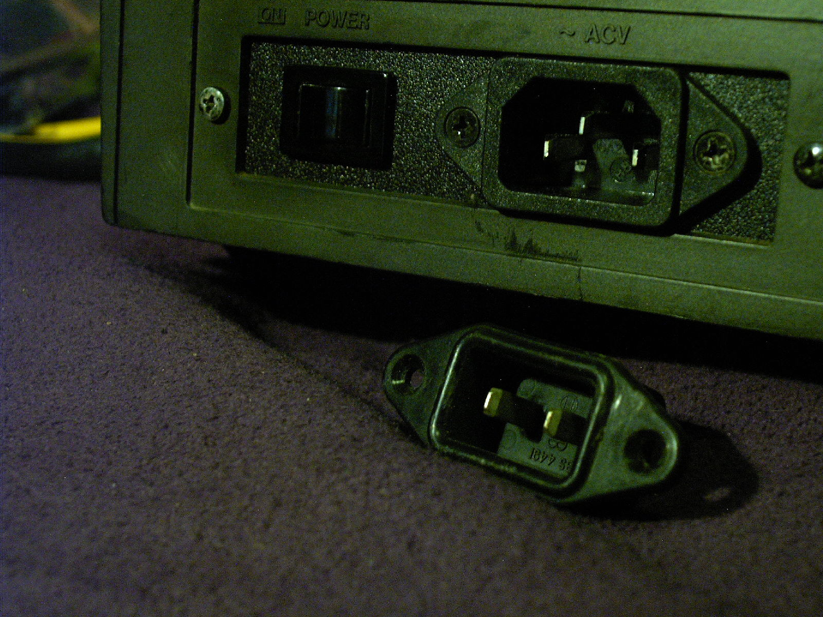

Another thing I need to do is change the mains input as it now has a not so standard or outdated 2-prong connection. By the looks
of it I can simply replace it with a standard 3-prong version. At least the screws seem to be in the same place and it's almost the
same size. If it doesn't fit right away I'll make it fit Wink So that's what I will do first and then connect the keybed to see if that all works.
Since the keybed is out anyway I might as well give it a good clean. I am a bit hestitant of removing all the keys although I doubt
anything else will break off. The keys are labeled on the back so that should make putting it back together easier. If I remove the
keys I should probably go a step further and see if the switch contacts could use some cleaning. Looks like they are the rubber +
conductive contact kind.

I replaced the mains input connector. Cool I had to enlarge the hole slightly but since it is mounted on a removable bracket this
was pretty easy to do. Now to figure out how the keybed connects and power it up (fingers crossed).

so far it all seems to work! Surprised
There is another key broken though (center D#). I'm not sure if that just happened, in which case I should be able
to find the broken piece and glue it back, or if I just hadn't noticed it. I'll just go ahead and carefully remove all the
keys for cleaning. Oh, another slight problem is that I don't have the screws to put the thing back together, but with
all the stuff I have taken apart over the years I'll probably have some that fit.
