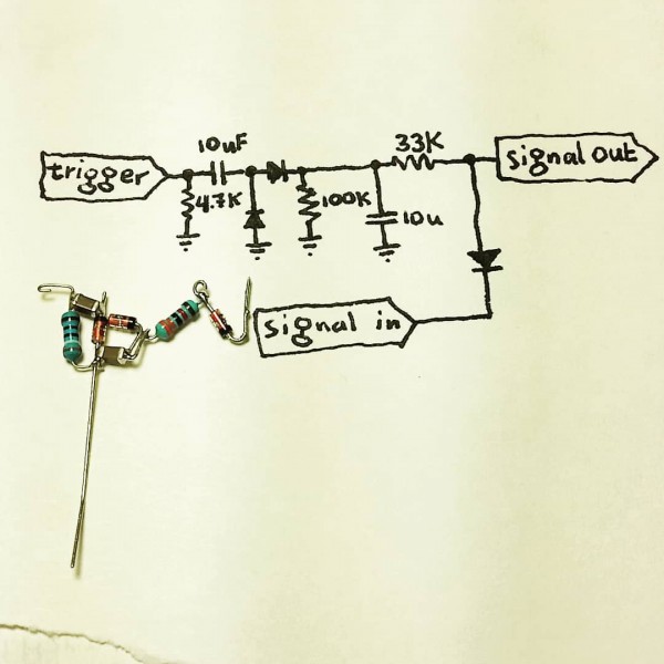

Hashtag Octothorpe
Joined: Jun 11, 2017
Posts: 57
Location: Grand Rapids MI
PostPosted: Thu Jun 14, 2018 3:12 pm    Post subject: Reply with quote  Mark this post and the followings unread
The simplest VCA of all is a diode.
I've used a ton of them and in my percussion circuits. They're quite common in Roland TR-808 voice circuits.
Roland calls it a "swing type VCA". The attachment is a schematic that'll work with a low-impedance trigger, but if you feed a signal into the 33K resistor where it meets the 10uF capacitor, and delete that capacitor and everything to the left of it, you should have a workable VCA.
You will need to high-pass the audio input and outputs to keep the DC out of the signal. And if the filter is low enough for full-range audio, you'll hear the CV. Maybe a 100nF capacitor in the signal path with a 10K resistor to ground just after the capacitor. That's about a 160Hz high-pass filter. That's great for snare, chime, cymbal, high toms... stuff like that.
