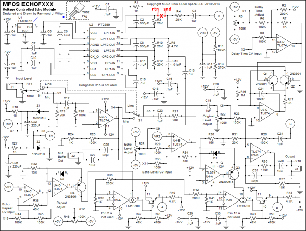

Hi! I'm trying to make a feedback loop in the VC echo but I'm having some trouble...
The obvious point to insert the send/return jacks seemed to me where both feedback and dry signal meet (through R4 and R21 respectively). As shown in the schematic attached, I cut the trace there but it's not working at all... Of course it's alright when normalized or self patched, but as soon as I put something in between, no delayed signal comes through (even with something as simple as an active attenuator).
Can someone help me telling me what's wrong? Should I put a resistance in series with the return input or something??
Could I insert the loop somewhere else?

I was checking the point that I chose for the send/return points and I saw that the signal has an offset and it's pretty attenuated... I'm asuming the later is to not clip the PT2399 or LM13700 inputs...
so... would my send/return connections need amplifying/attenuating? Still not sure about that offset...
Guess those two jacks on the front will remain unconnected Laughing
