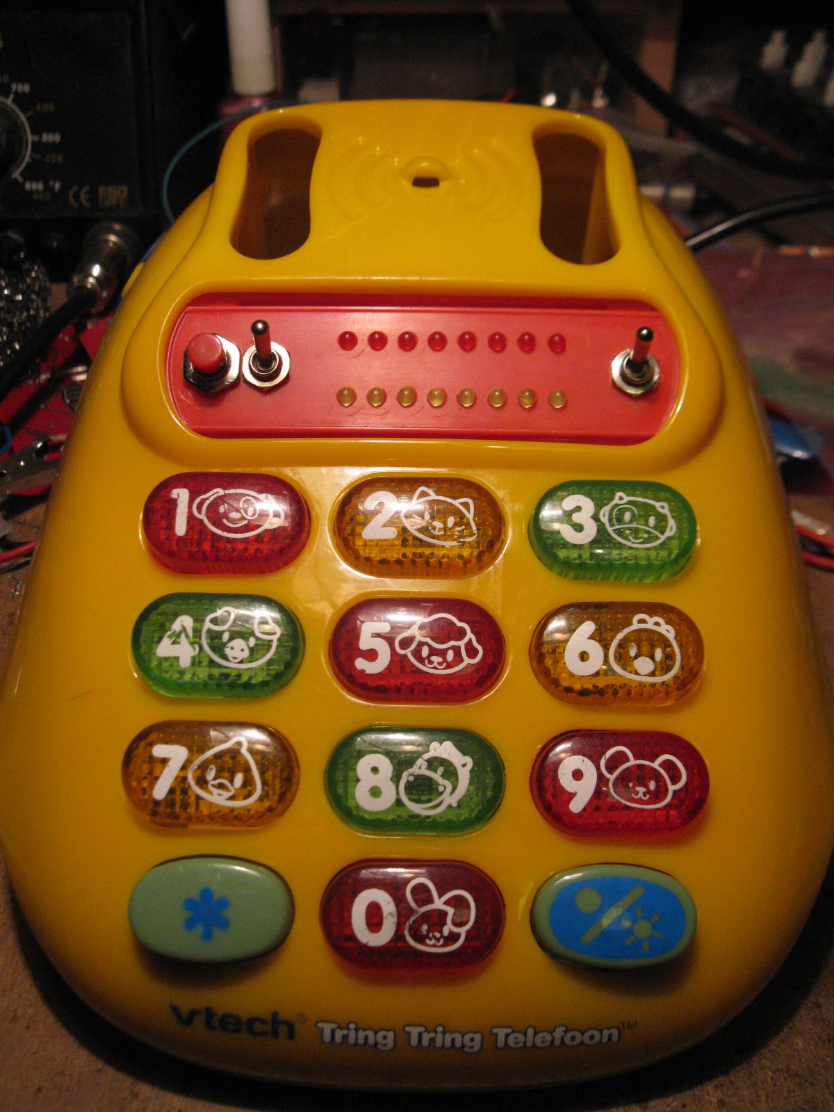

PostPosted: Sun Oct 07, 2018 4:22 am    Post subject:  Tring Tring Telephone Controller
Subject description: Arduino based sequencer/controller inside a toy telephone
more info will follow,..
 Filesize:  1.1 MB
 Viewed:  830 Time(s)
gabbagabi
Joined: Nov 29, 2008
Posts: 652
Location: Berlin by n8
PostPosted: Sun Oct 07, 2018 12:47 pm    Post subject: Reply with quote  Mark this post and the followings unread
sequenza? Smile Question
Posts: 5868
PostPosted: Sun Oct 07, 2018 2:56 pm    Post subject: Reply with quote  Mark this post and the followings unread
yepz Laughing which is an extra feature for what I initially intended to do.
What it actually is, or is going to be, is a controller for my QuaZar 'sequencer', but with an arduino inside it's easy to make it useful
for other things aswell. When I designed QuaZar I already had the idea in mind to add an external keyboard/controller and there is
a connector for this on the front. The idea is to be able to trigger the notes manually so I can use it as a keyboard with a custom scale.
It already has buttons that can do this but one thing I hadn't thought about is that when you release a button it will go back to whatever
step it is currently set to (which is selected with a control voltage instead of a CLK).
The idea was to use the electronic equivalent of radio buttons for the controller and I designed a simple circuit for this with a couple of
flip flops. I then started thinking about what switches I could use and if I might have something useful laying around and that's when I
remembered the toy telephone. Thinking a bit more about what other functions could be useful I decided I might aswell put an arduino
inside and add a sequencer function. At that point I hadn't even realized yet that it has a button matrix so my initial flip-flop circuit wasn't
even useful.
I first wrote the code for the radiobutton part to get that working the way I wanted with the button-matrix. Today I started on the code
for the sequencer bit and I realized that it is actually easy to add and I can just combine it with the code I already had. On startup it loads
the first step of the sequence (I have not decided yet if I am going to add a function to store multiple sequences). Without a CLK signal
(I'll add a switch to disable it) you can just play it with the radiobutton function, so whenever you press a key it stays on untill you press
another key (gate out will only be high as long as the key is pressed). When another key is pressed this is also stored as the new value for
the current sequencer step (0 on startup). There are buttons to select previous and next step and all that does is just load the previous/next
value from the stored sequence, but after that you can just play it again manually and every change is again stored for that step. If you now
add a CLK signal it will step through the sequence and you can adjust every step on the fly.
At the moment I am thinking about what extra switches I need to add (and maybe LEDs and/or a pots too). I do want to keep it pretty basic
though. The next thing I need to try is if I can use the switch that is inside the hook for the handset as a reset switch or if it's too crappy and
I need to add an extra switch for that. I also need something to select different modes for which I could use a pot but that would require
some sort of indicator so switches might be a better solution. Or make it so that it can only switch modes on startup, which is easy to do with
just holding down a button on startup.

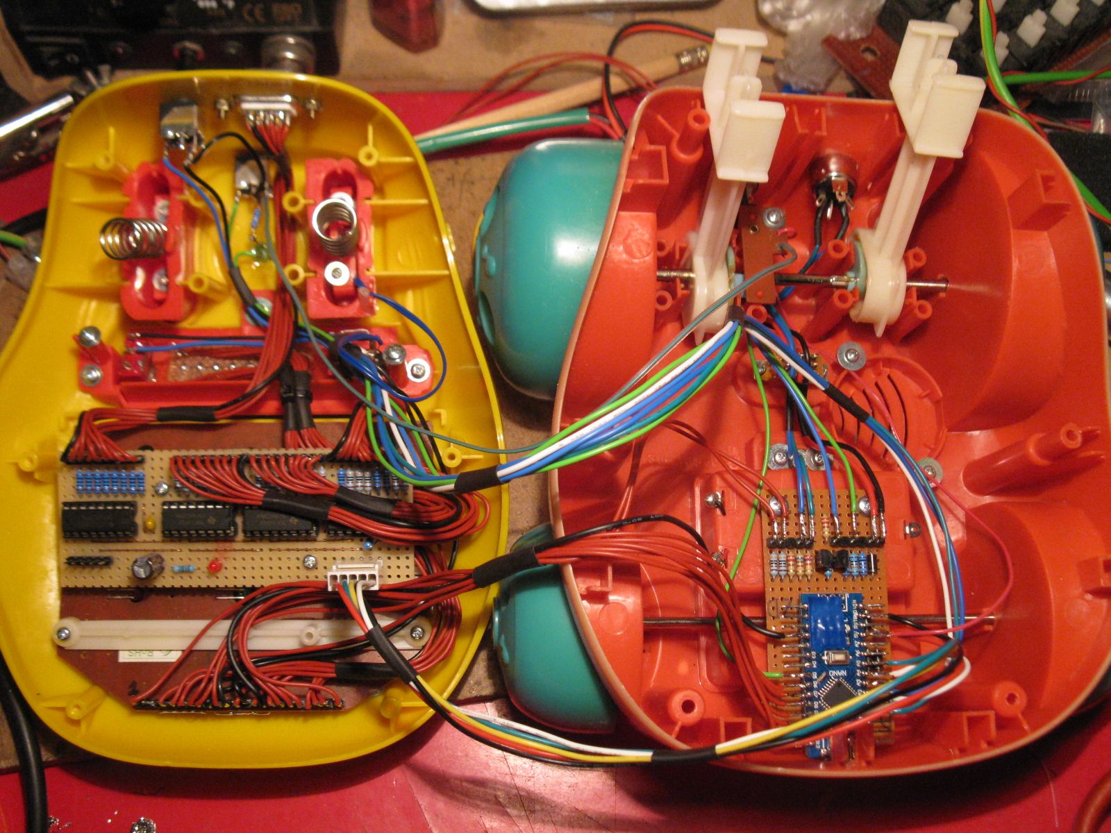

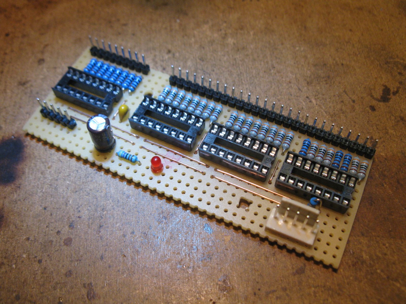

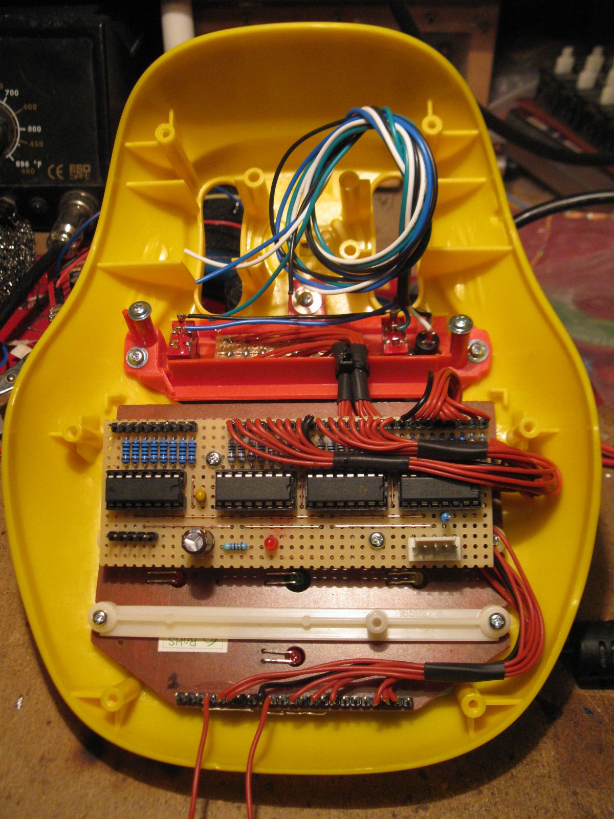

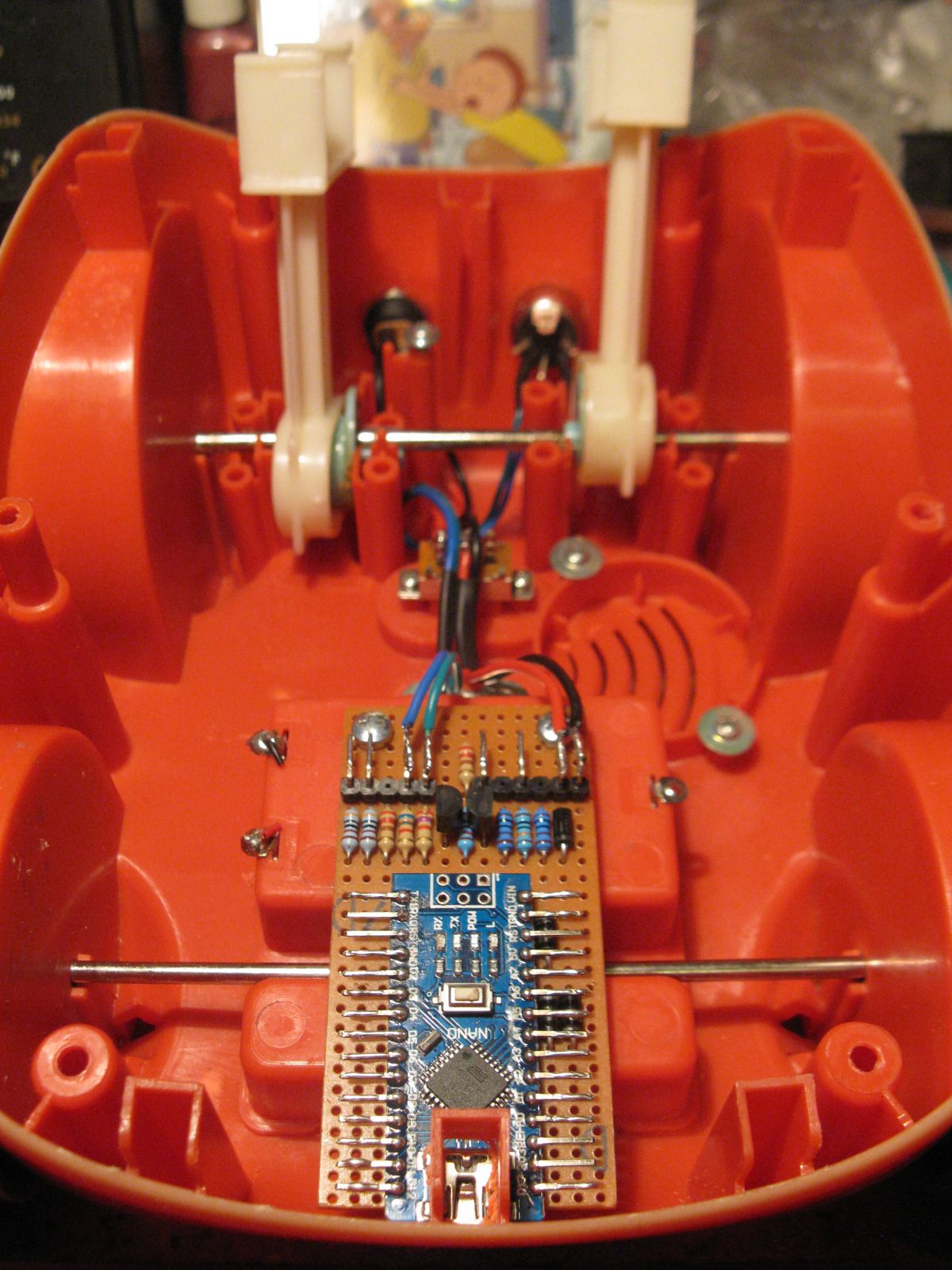

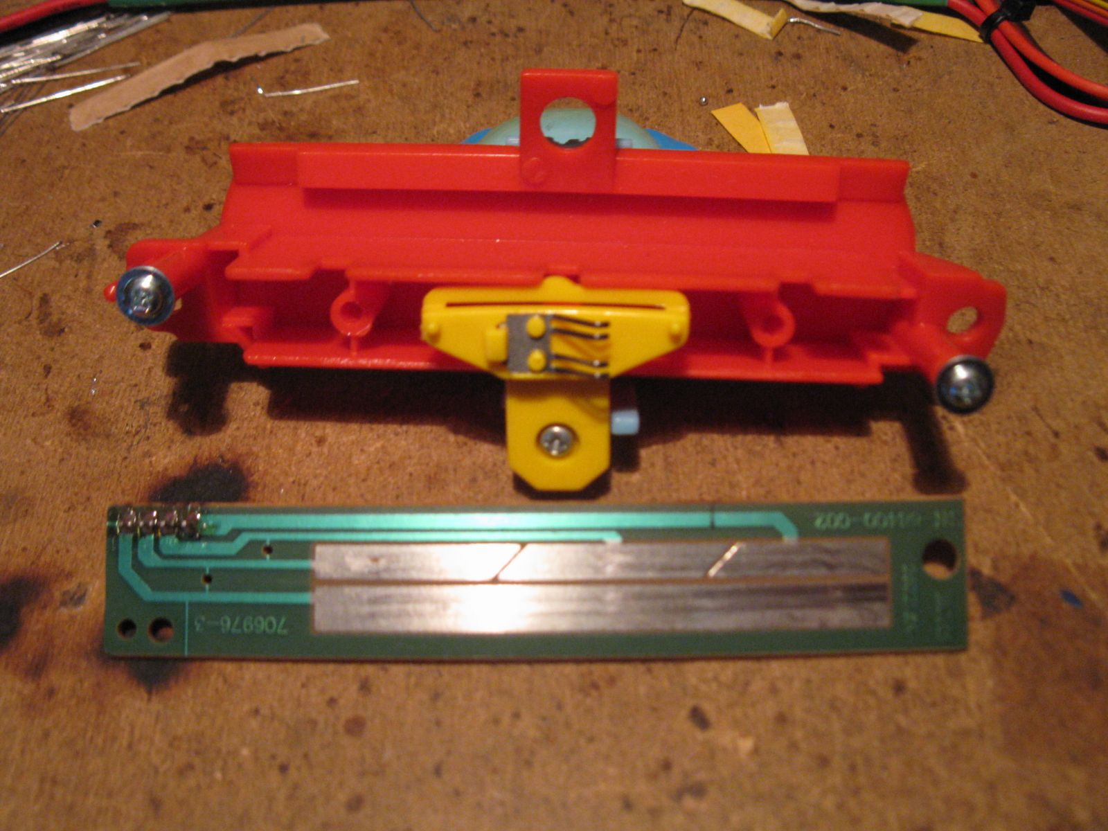

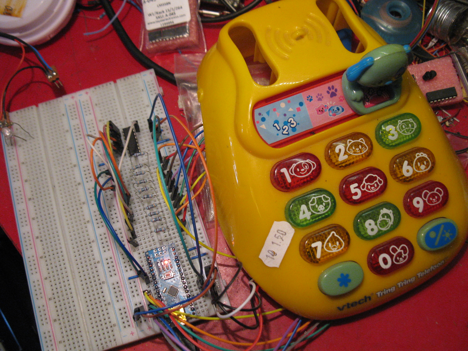

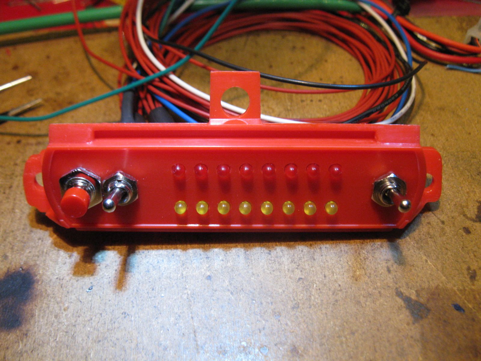

Posts: 5868
PostPosted: Tue Oct 16, 2018 10:36 am    Post subject: Reply with quote  Mark this post and the followings unread
I've been working a bit on the hardware. I removed the original slideswitch and added some other switches and LEDs.
I am using 74HC595 shiftregisters to control all the LEDs + main outputs (with just 3 arduino pins).

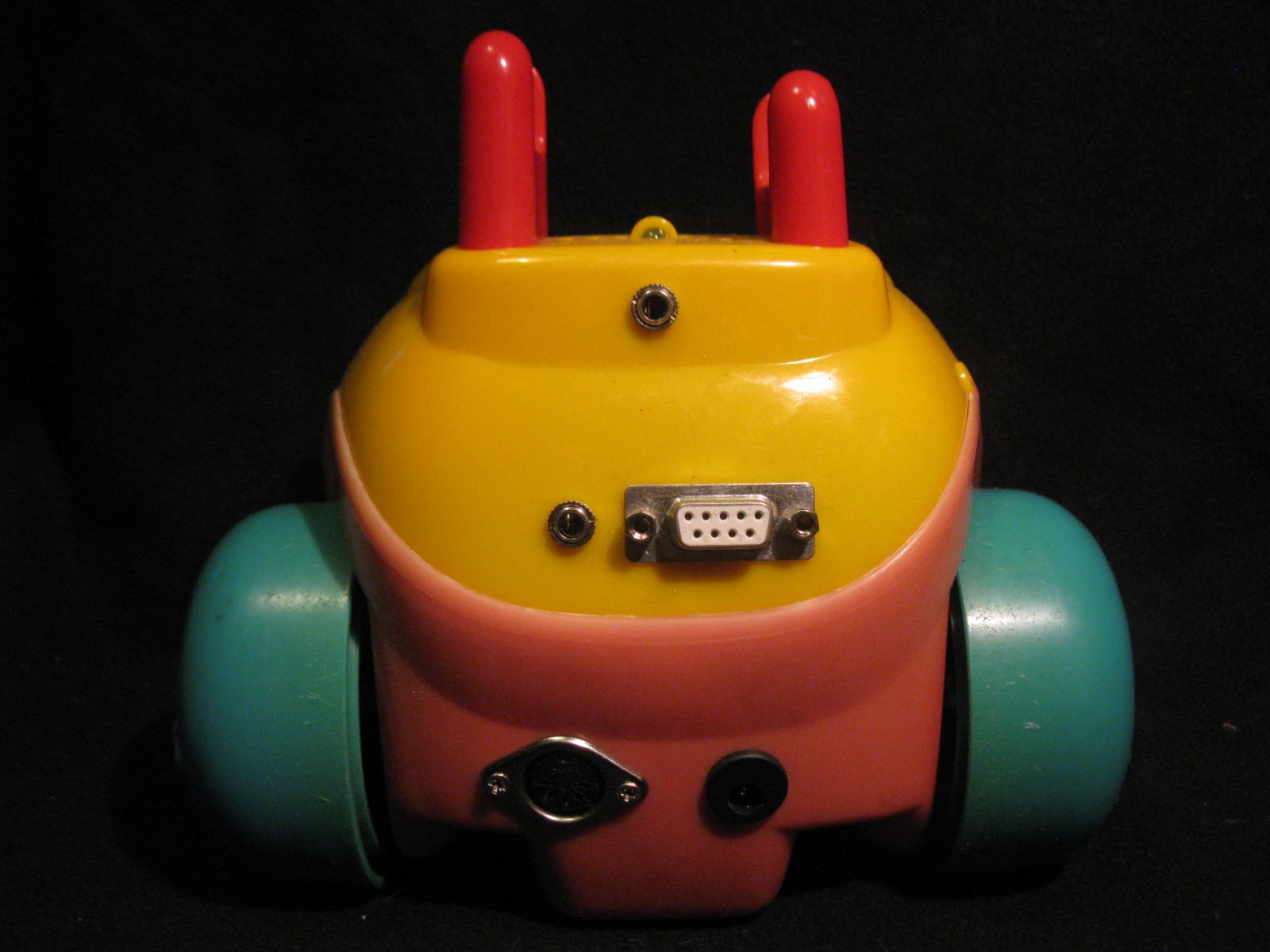

Posts: 5868
PostPosted: Mon Nov 12, 2018 2:42 pm    Post subject: Reply with quote  Mark this post and the followings unread
I wanted the USB port of the arduino to be accessible from the outside and found a spot for it. Cool
I also added a midi output so I have the option to use it as a midi controller/sequencer in the future.

Posts: 5868
PostPosted: Fri Jan 04, 2019 11:39 am    Post subject: Reply with quote  Mark this post and the followings unread
Yeah, it's been a while since I've seen you around here, hope all is well.
Happy New Year! Razz
I finished the controller the day after the last post, but haven't taken any pictures. Probably because I need 2 small screws to mount
the DIN connector (so it's actually not 100% finished) which I haven't been able to find. Let's see if I can get to that this weekend.

Posts: 5868
PostPosted: Sun Jan 06, 2019 9:22 am    Post subject:   Reply with quote  Mark this post and the followings unread
well, here it is.
