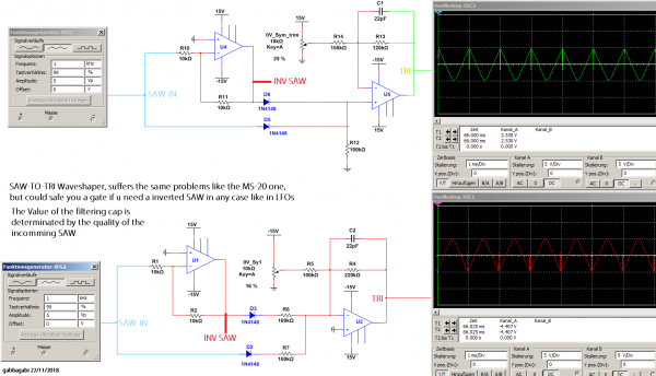

Hi Guys,
attached a simulation of an SAW to TRI Waveshaper.
The quality of the output-waveform is compareable with the one from the MS-20 waveshaper.
The thing here is u get the Inverted-SAW "for free" and the TRI is amplified and offsetted with one gate.
That means if u have a circuit that needs an Inverted-SAW anyway like an LFO, this circuit could safe u a gate
of course it would do the other tasks ass well, Tri-Frequenzy-Doubling and Sine-Rectifying
GLHF
GabbaGabi
