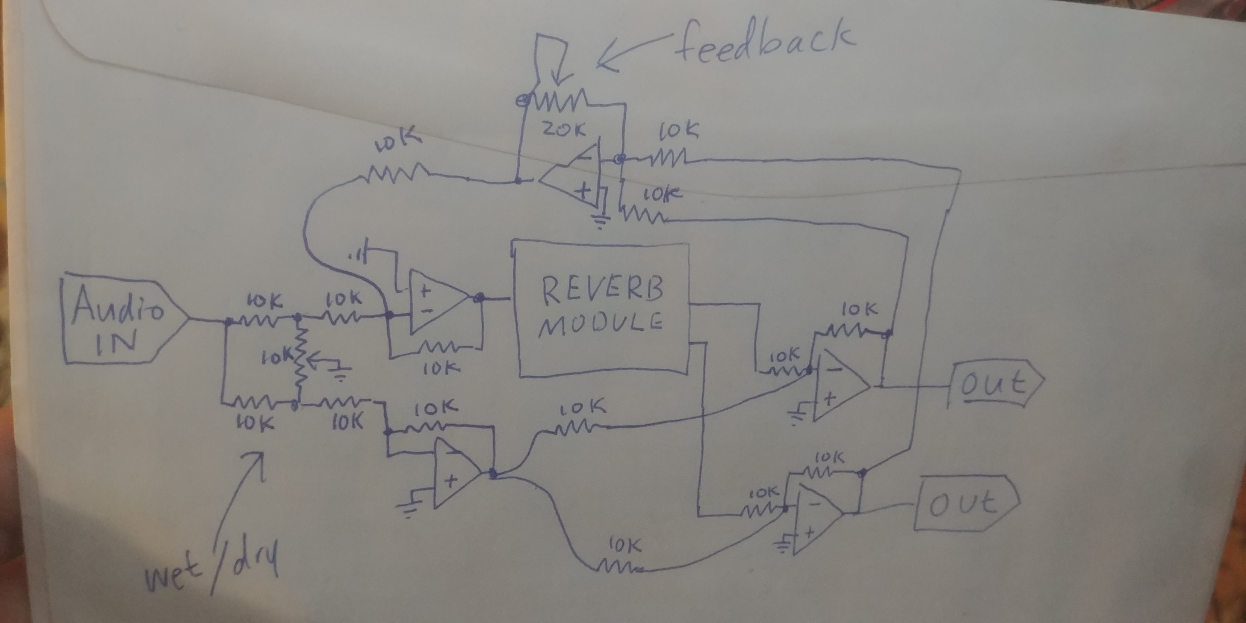

Okay, the module doesn't have "wet/dry" mix, so everything you feed to the input gets processed and you don't hear any of the original sound. I will use a reverse fader type circuit for that. It also lacks any way to feed the output back to the input, which I'll include with a basic amplifier circuit (although I might include a Korg MS-20 style low pass filter to the feedback circuit if I have room).
Changing the clock speed should be okay. My other reverb builds based on Spin Semiconductor FV-1 chips and my delay builds based on the PT2399 have adjustable clock speeds. The only problem might be if the microcontroller on the cheap reverb module crashes with a change in clock speed. If the DSP chip and the microcontroller share a the clock speed it shouldn't be a problem! |

| Whoops, no, there's problems with that schematic..... don't use it. I'll draw a better one tomorrow... |

Apart from the inverted feedback that actually looks quite ok although it might need some AC coulping caps depending on the power supply.
Interesting to see the wet/dry mix at the beginning of the audio chain, I've always just added it at the end but this might be a better idea
especially with delays. _________________ "My perf, it's full of holes!"

| Hashtag Octothorpe wrote: | | I drew a schematic... it uses five op-amps (I recommend TL047 quad op-amps) which is awkward. You MIIIGGHHTT be able to eliminate the bottom amp, instead connecting the two 10K resistors that originally connected to the output of that op-amp to the leg of the wet/dry potentiometer. |
Remember that the codec on the module input/output has limited input and output voltage range. In my case it is CS4220-KS and according to datasheet it has 2V rms (means about 5.5V peak-to-peak for sine wave and 4 V for square). Output is almost the same (1.9V rms). |

| Okay, change the feedback resistors on the output amps (the only 20K resistors on there) to 30K resistors and you'll get almost unity (well... inverting unity) out of the dry signal, which is good. The wet signal will be processed by the effects module and the one I'm using has its own volume knob, so...? |

| Hashtag Octothorpe wrote: | The inverting feedback shouldn't be a problem because the signal gets thoroughly mixed up in the guts of the reverb so polarity isn't an issue...
...except in that schematic where the dry signal also makes it into the feedback loop, that's my biggest error...
So here's a better one! With the TL074 pinout and bypass caps!
You're on your own to get the 5V the module needs. Maybe your build has a 5V rail? Use a 7805?
Oh! When I build this, I'll totally experiment with that "10K?" resistor. There's already gain coming from the buffer in the feedback loop, and getting the reverb overdriven into infinite repeats or hums or howls can be an amazing feature, but you don't want it going overboard. So higher values like 15K will reduce the signal level of the feedback, while lower values like 7.5K will increase the signal level.
I like including the wet/dry before the effect because then you can have the dry signal going through and "ping" it with a quick twist of the knob and get a chunk of sound into the effect and have it ring until the effect module is done doing its thing. I think it's called "tails". |
It is a bad idea to put pot in the feedback loop of opamp. After some time, when pot's resistive path would worn, your opamp may go crazy with open feedback loop, generating big clicks (or maybe locking up). |

I always tie the wiper to one of the ends, so at most it'll fail at the MAXIMIUM VOLUME 😁 In the 808 all the variable-gain inverting amps also include a big electrolytic cap in series with the potentiometer and a 470K resistor in parallel.
