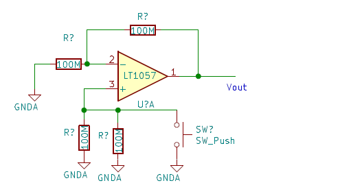

ixtern
Joined: Jun 25, 2018 Posts: 145 Location: Poland
Posted: Mon Jun 03, 2019 1:39 am Post subject:
voronin75 wrote: | Problem solved. In a strange way. There are two types of DIP chips, in particular the TL072: in a ceramic case and in a plastic case. If I correctly understood from TI data sheet, the ceramic element is cut on the meedle of front age (marking pin.1), a plastic extruded point near pin.1. TL072 in the ceramic package does not work correctly in the comparator section of MFOS VCO, but in other schemes work well. TL072 works correctly in a plastic case, TL082 also in a plastic case. I have reason to suspect that these chips are slightly different, because TL072 I bought at different times and from different suppliers, although the probability of defect probably exists. Perhaps the situation is similar to the one that described ixtern. And if you have some strange problem with VCO or calibration you can change the chip at first, or match from other analog. |
Try to check OpAmps with this simple tester. When switch is off, output voltage should be within few milivolts (or less). When switch is on (noninverting OpAmp input shortened to ground), output voltage will differ by the Ibias * 50 MOhm so 1 nA of input bias current should give 50mV output voltage.
Good TL072 should have bias current at normal temperature less than 0.2nA,
so max 10mV change on output.
In my case output voltage difference for fake ICs was about 100-200 mV what means 2-4 nA of input bias current what is rather characteristic for bipolar OpAmps.
If you don't have 100 MOhm resistors, you can chain 10-20 MOhms together.
High tolerance is not needed as we are interested in order of magnitude rather than exact value.
